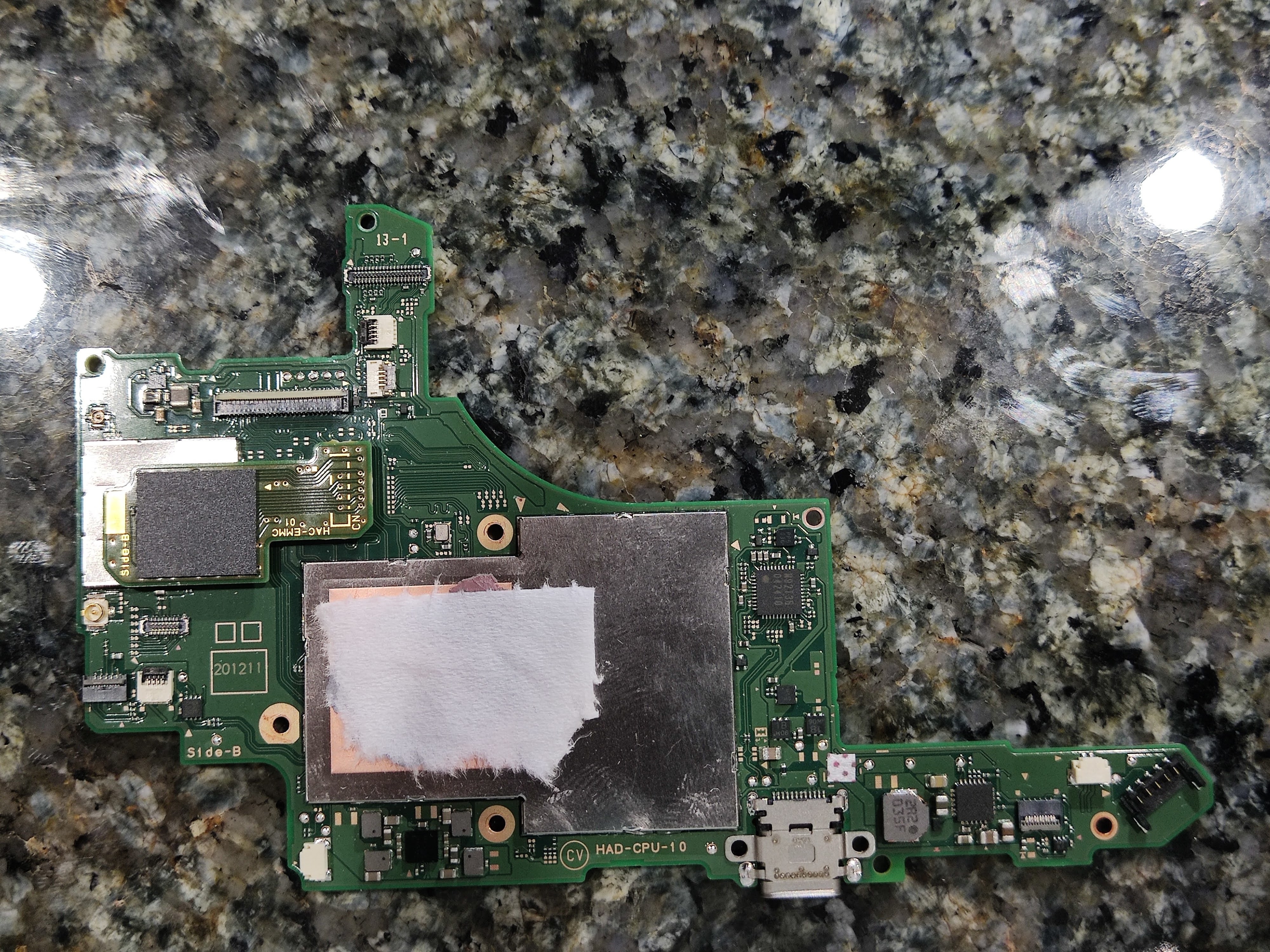

in the mean time i took them apart and i want to focus on 1 at a time unless people prefer both units.

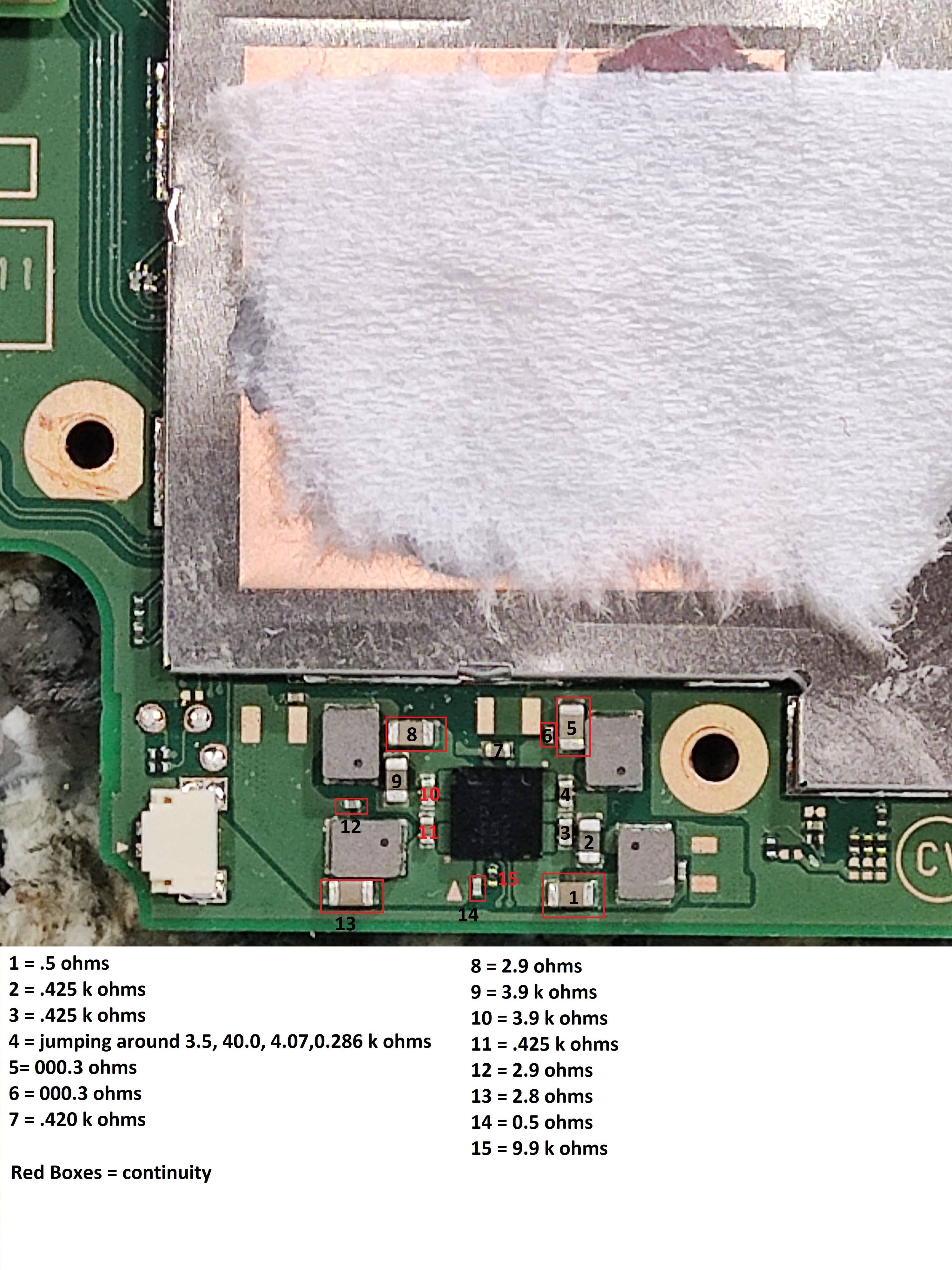

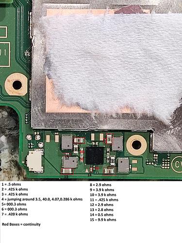

i noticed around the max77812 there is some capacitors which have continuity but i read on other post that the resistance is low and will give that.

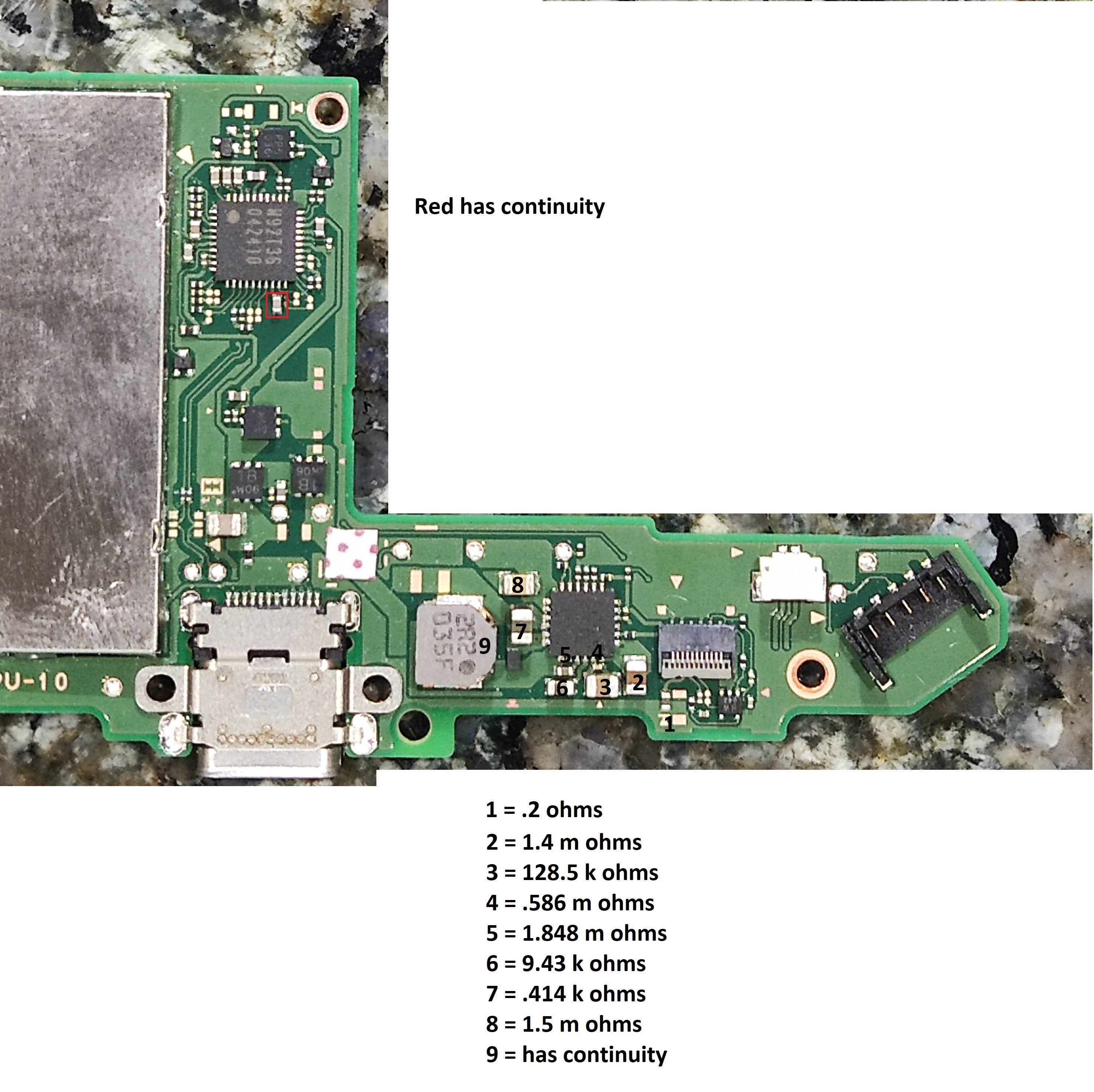

On the bottom of the M92t36 a capacitor has continuity as marked in the photo

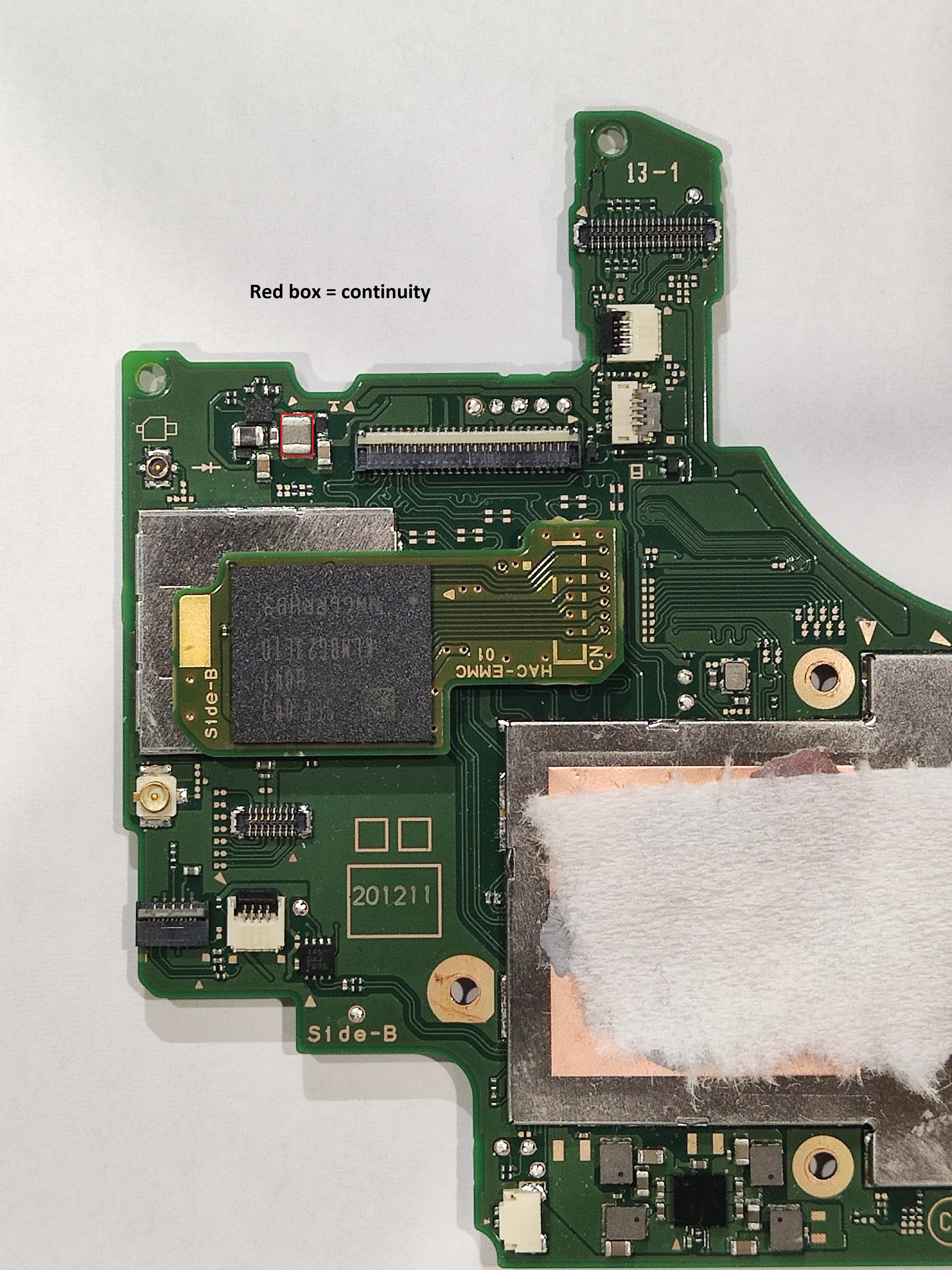

And on the top left also has a continuity.
Anyone has ideas ?
