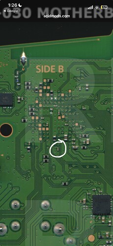

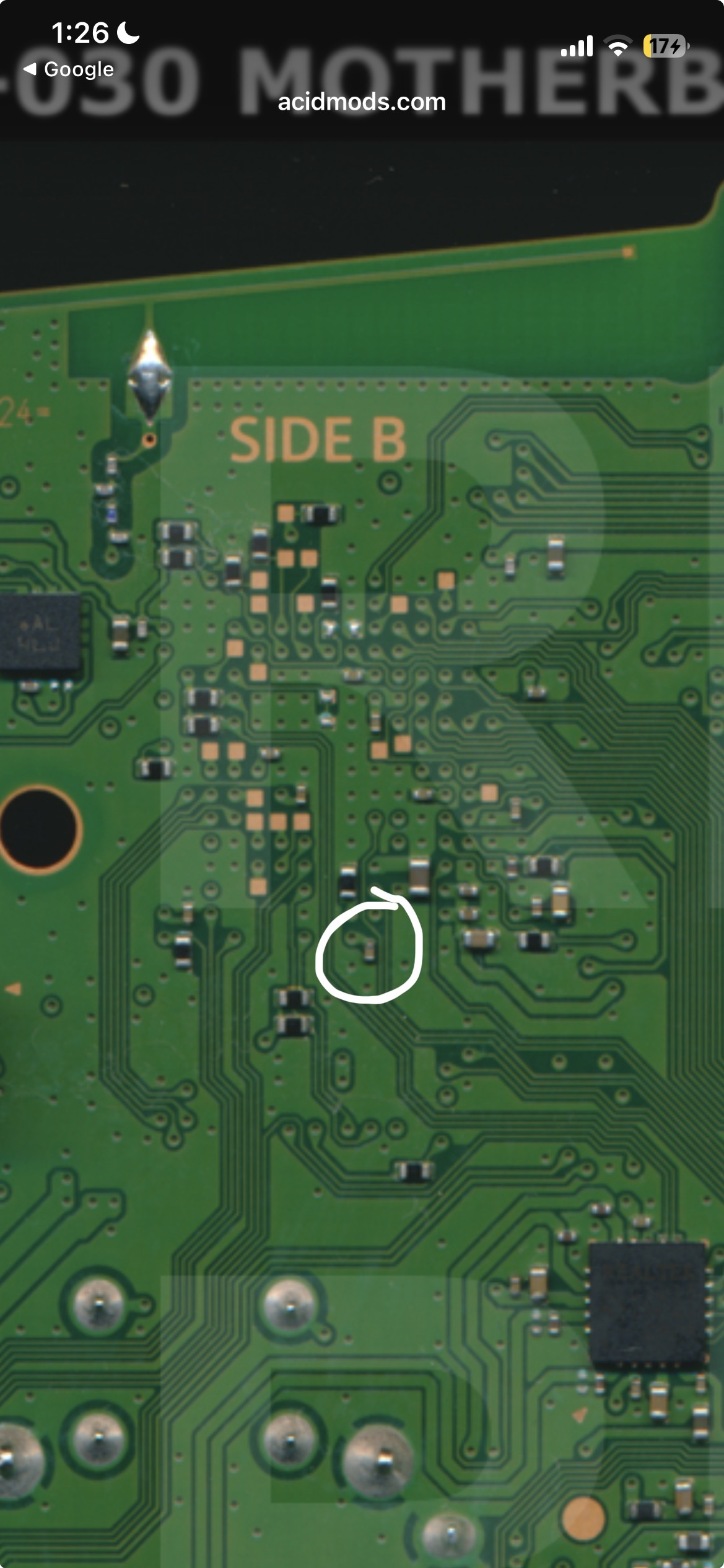

i recently trying to replace my joystick myself, i know it would be cheaper and easier if i pay professional to do it, but you know i want to experience it myself and learn how to fix things.
unfortunately i have done a big mistake by dropping a blob of melted solder on the ds5 pcb when i tried to put some solder on the solder iron tip, luckily it don’t really stick to the board but i found that it actually has pick up (and absorb) a component into the blob and i couldn’t find it, so it no way i could measure it or know what is it because it super tiny, it could be capacitor 0201. so that is how a simple fix has turn to micro soldering (ig) and the cost has climbed up, im a bit burn out rn.

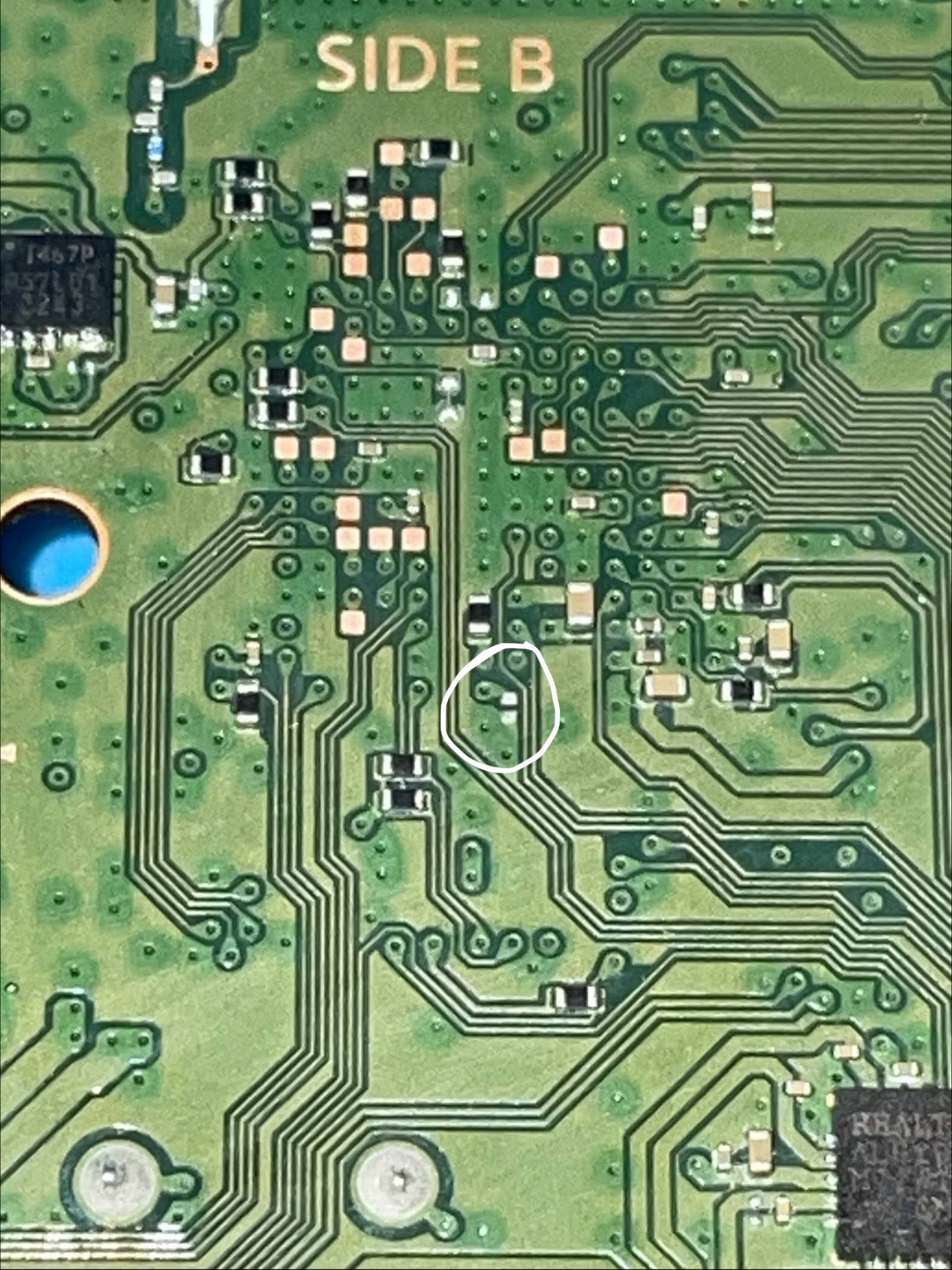

more photo
100nF_3.3V_0201 (measured 1.8v on top pad when controller on) 6.3v voltage rate should be fine as well
