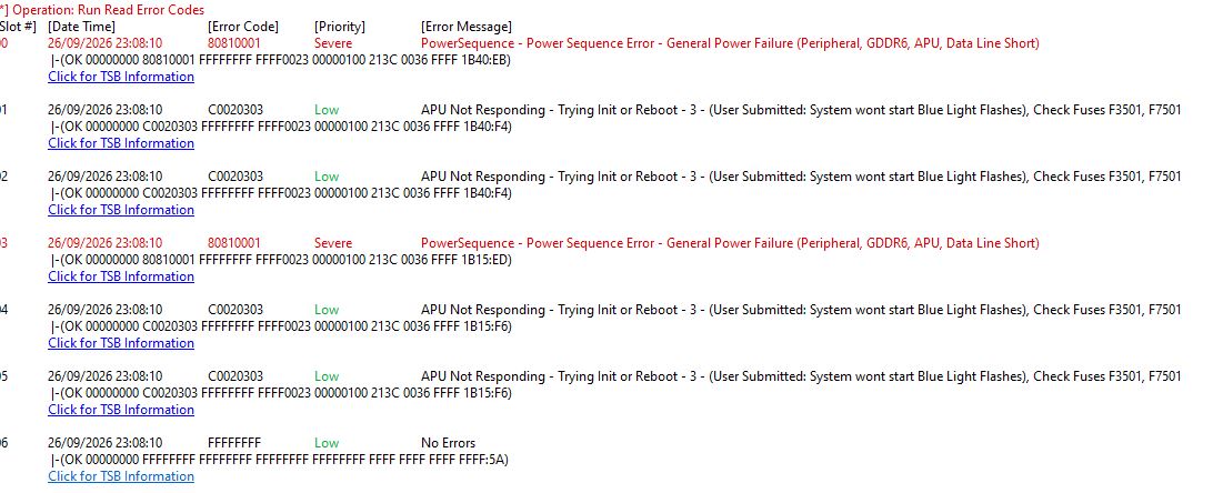

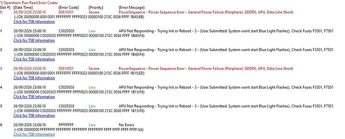

Blue light off, UART error 80810001
Hello, I have this error on a PS5, some voltages are missing on the HDMI chip, but I think they come from the RT5126 IC, the southbridge doesn’t activate them, I have changed the IC without any change.
