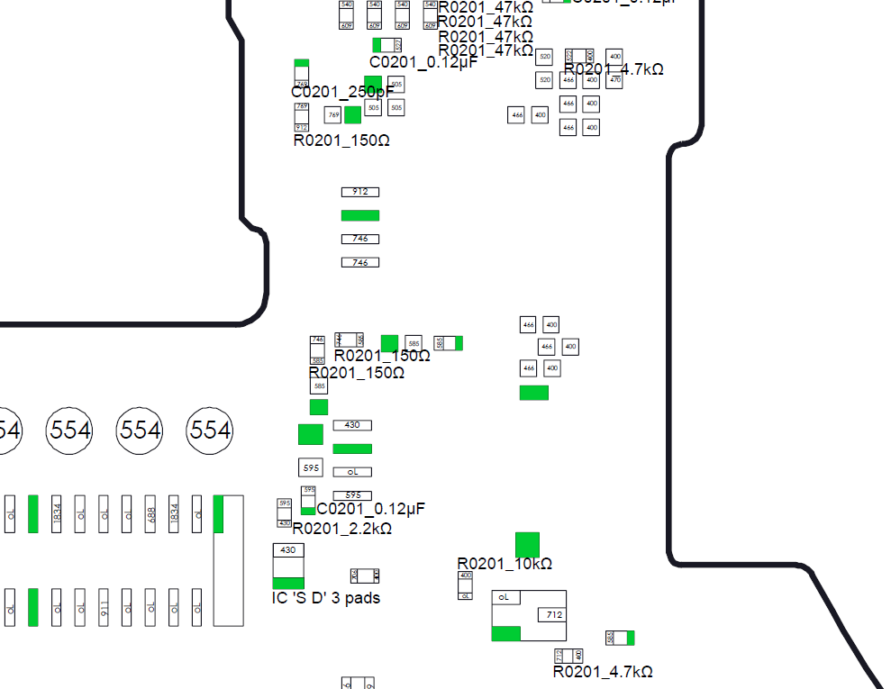

Any idea of the value of the components around the lock button and fan connector. Device had water damage in this area. Had to jump a wire from testpad 4 cluster E because the power button line was reading OL at the the point before it runs thru 2 components the were burnt looking. I put a filter back in place to complete the circuit to the connector and its working normally now except that the switch will cut off after about an hour. I removed the jumper wire and it stopped cutting off so I’m thinking i should have used something other than a filter or one of the other components are bad. Any help would be appreciated.
Maybe this can help:
