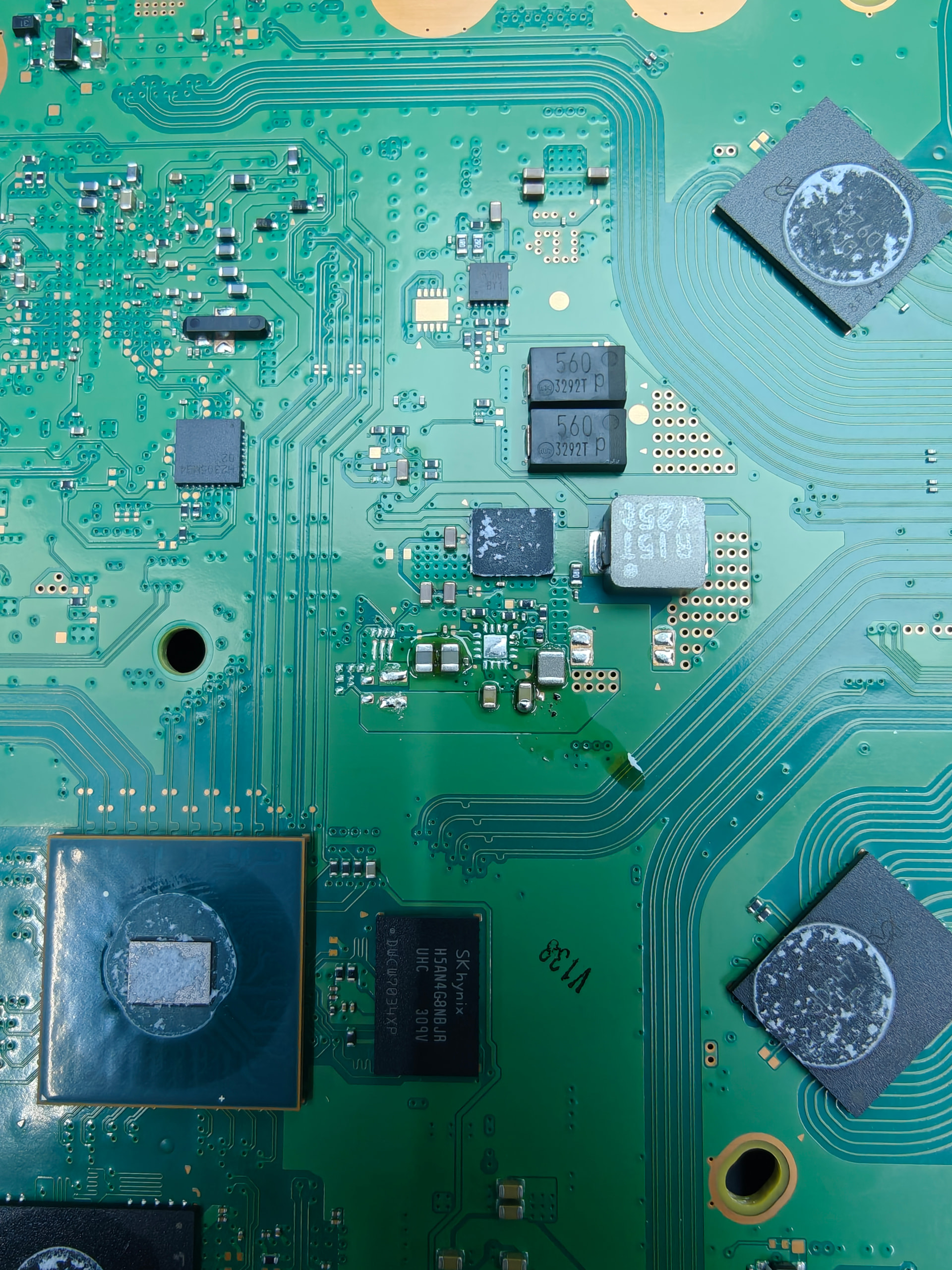

I have to bring up the same issue again. I’ve got another EDM-041 board with UART error 80810001 and a 1-second BLOD (Blue Light of Death); the fan also spins up briefly. I cleared the UART error log, and no errors are being reported anymore, even though the console still doesn’t work. I can’t find a fault; the expected voltages are present. F3501 showed no continuity. Yet, even with a thermal imaging camera and so on, I can’t find anything. Any help would be appreciated.

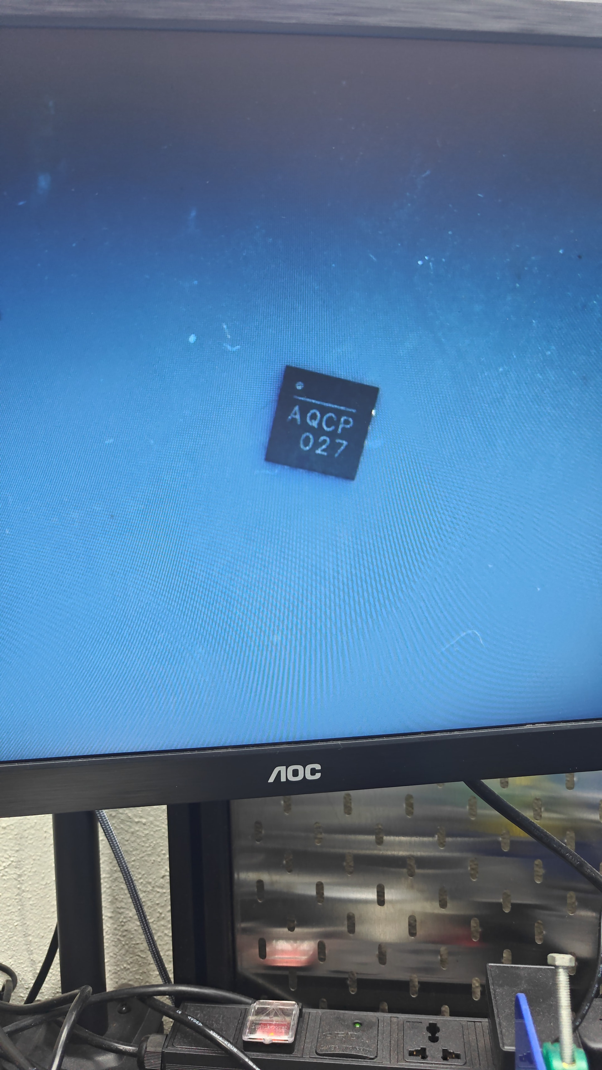

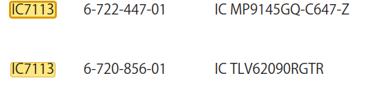

Can you confirm that the TLV62090 you mentioned is the same as the ic in the picture attached. This is the same ic in your previous discussion but has a different part number. It is found on EDM-041. Can it be replaced with an SBV ic from an 020 motherboard.
YES, “SBV“chip is interchangable with the one “AQCP“ you have
