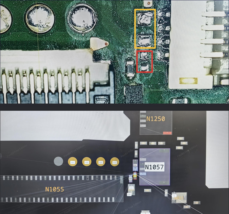

Hi, everyone! I have a Nintendo Switch HAC-001 (Erista).
Please help me identify the two missing components next to the screen connector and the fan.

orange one is a tvs diode on certain v1 model i.e HAC-CPU-21. The part number is CDZVT2R5.6B
Thank you so much for your help!

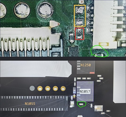

My measuring says 10 kOhm at the green marked resistor
Thank you very much.
