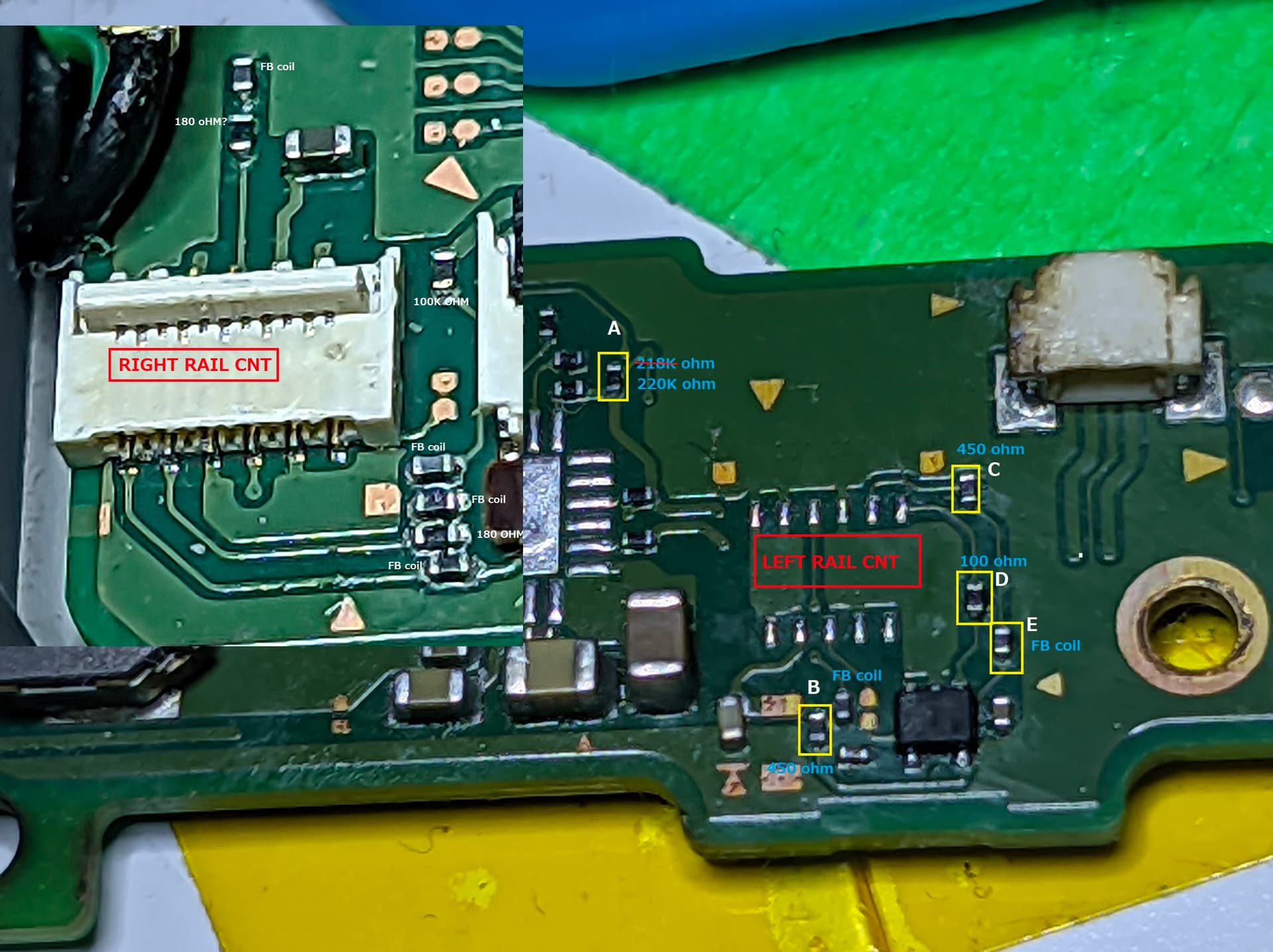

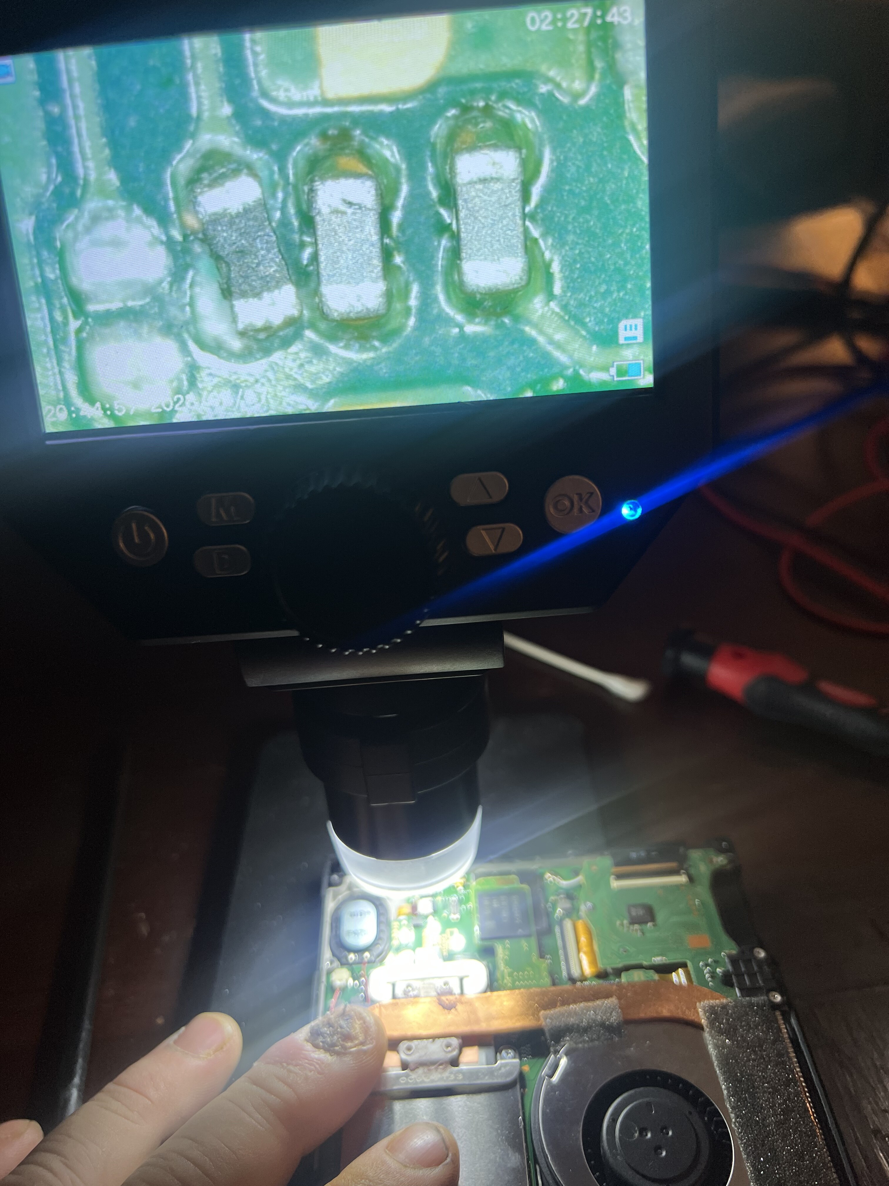

need help finding the value of these resistors i believe there are 10k they are right where the right joy con ribbon connector… went to replace the ribbon and rail and seen that it was Burnt and one was missing.
If you are talking about those 4 components in-between backlight and right joycon connector, bottom one should be a inductor.
I am waiting for my LCR meter arrive to make better measurement on inductor values
