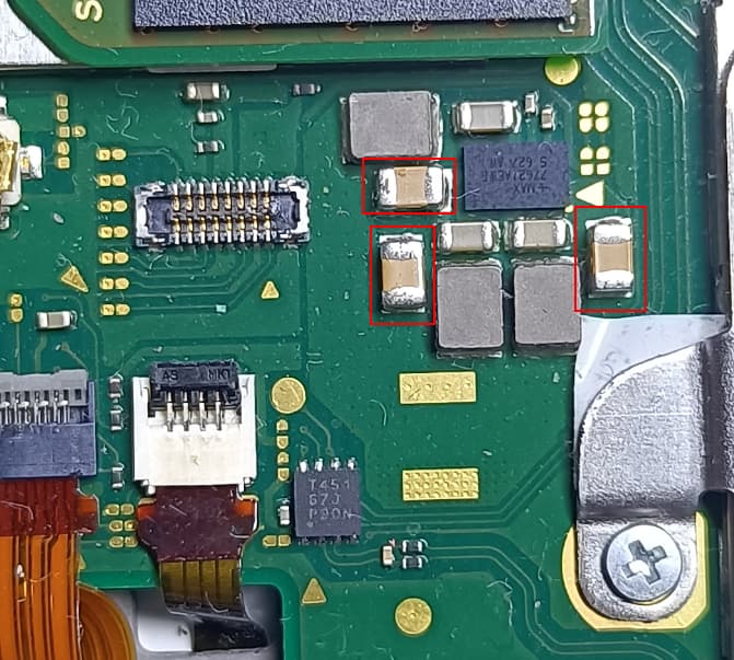

Hi, can someone tell me the value of these capacitors? I have all three of them grounded and I will have to replace them.
measure the resistance to ground on them, if they are around 50 to 200 ohm to ground, they are fine. Continuity Beeps does not always mean you have a “short” and they are bad.
I have 85 ohm to ground on those caps from a v1 working board
Ohh! Yes, I have measured and I have the value you mentioned. Now what could it be!? :frowning: Thanks for taking the time to answer me :slight_smile:
what was the issue/symptom? Do you see any voltages on the coils/inductors around another max77621 chip
No turn on, I see 4.23v ± sorry, only in 1cap, the rest are at 0
