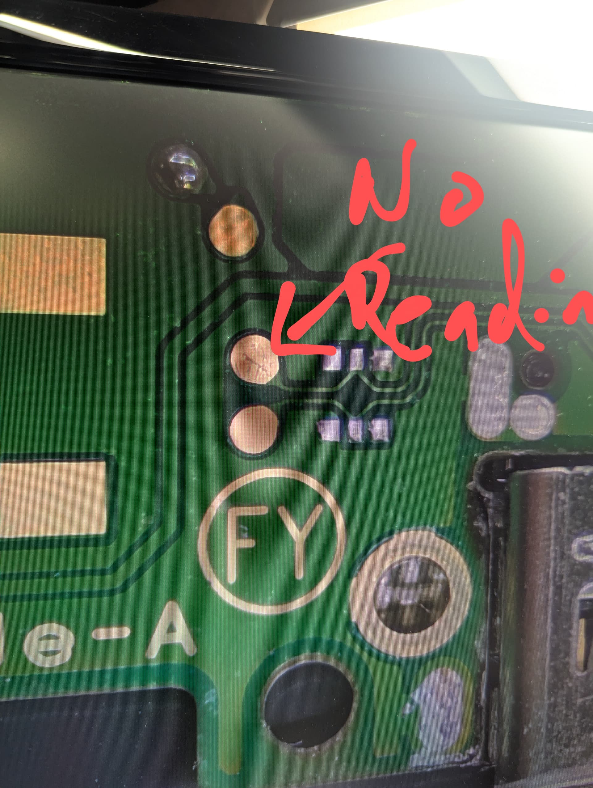

I get no reading on the top circle, but on a donor boards it shows .4 in diode. Any one know what can cause no reading?
I checked all the filters under the plu chip and replaced it , but still no signs.
Nintendo switch

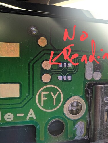

that should be cc2 or cc1 test point goes straight into m92t36 PD control ic
Ty soo much!!! Thats what I needed
