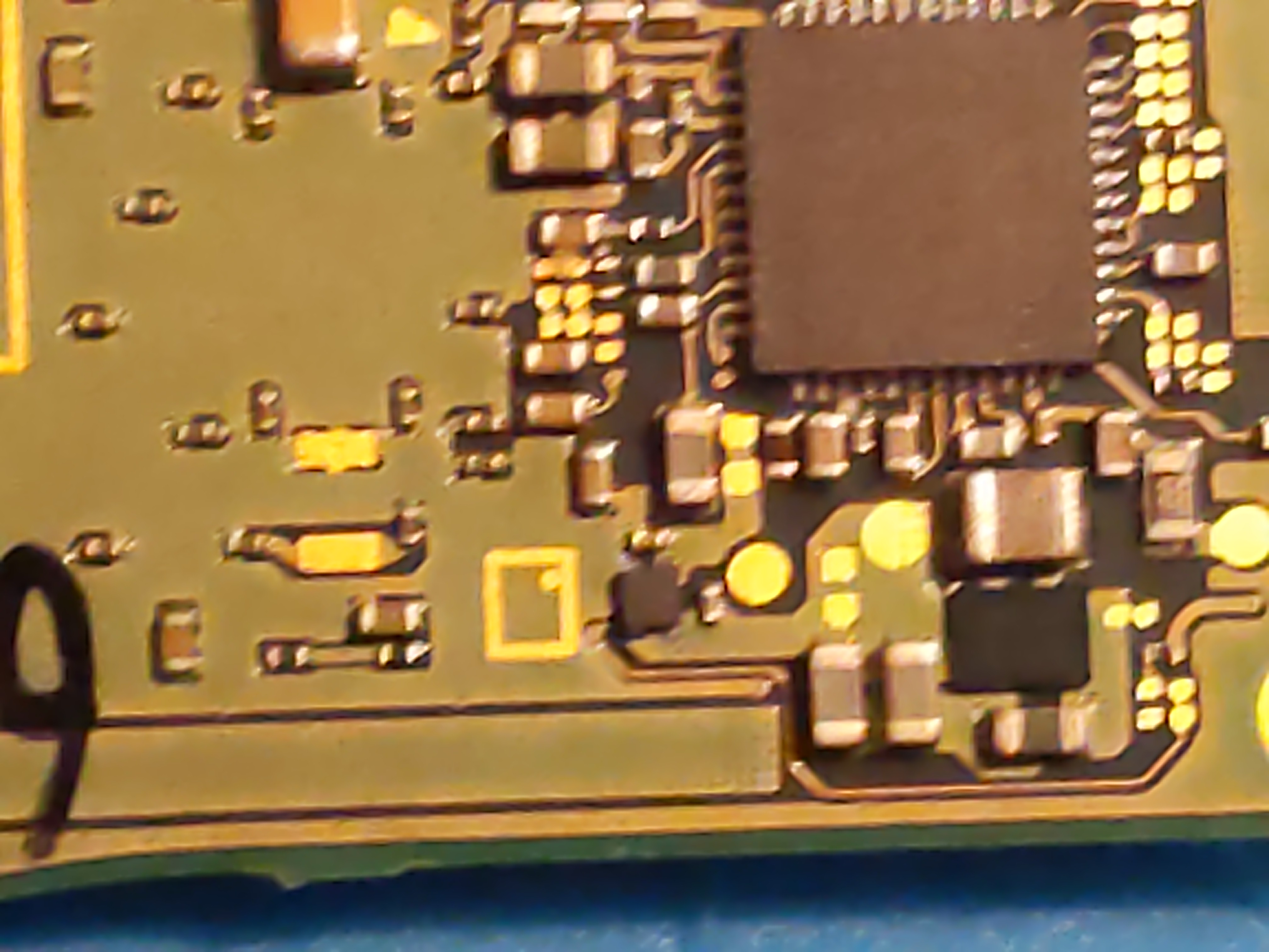

Shorted caps under cpu

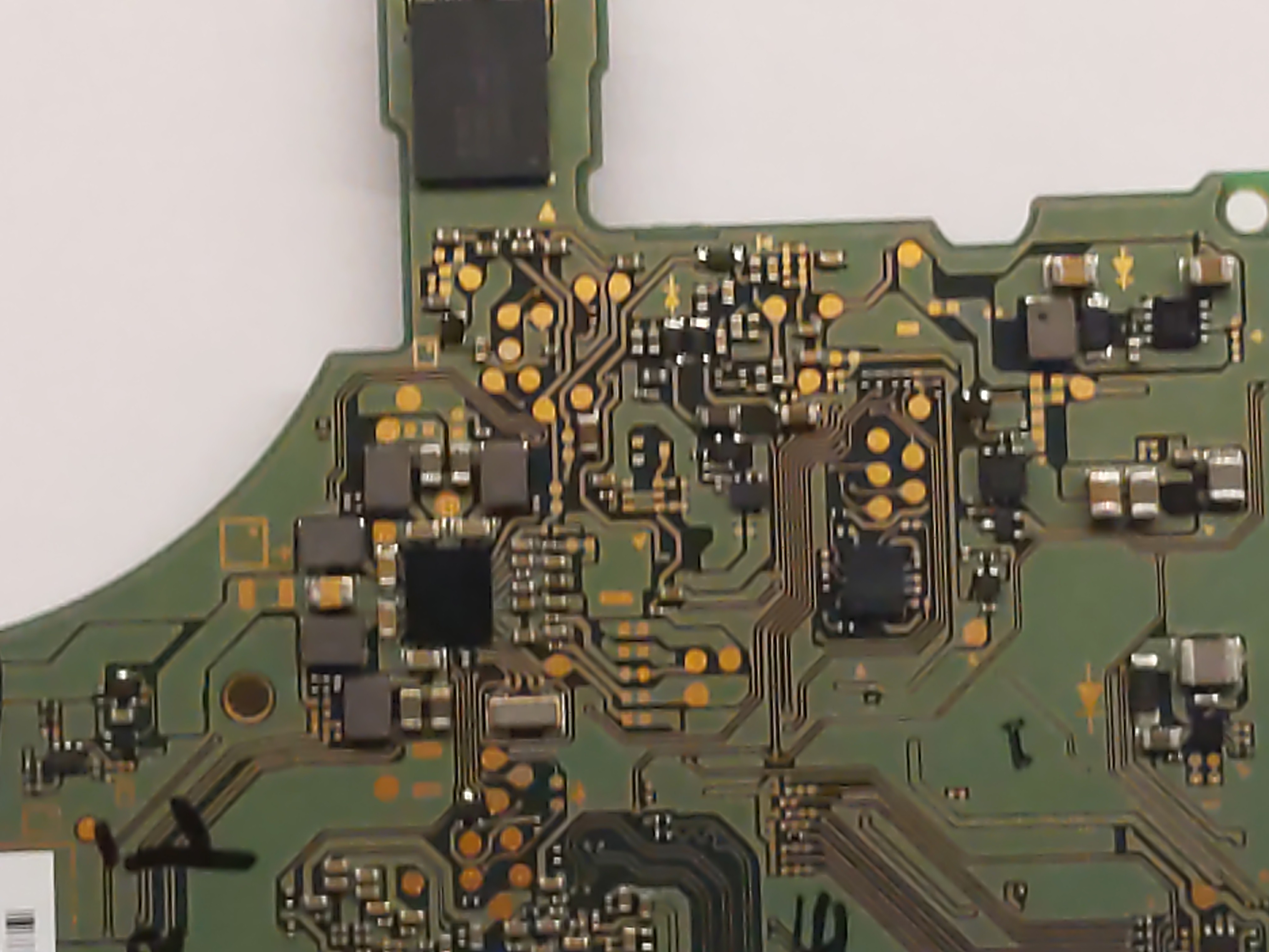

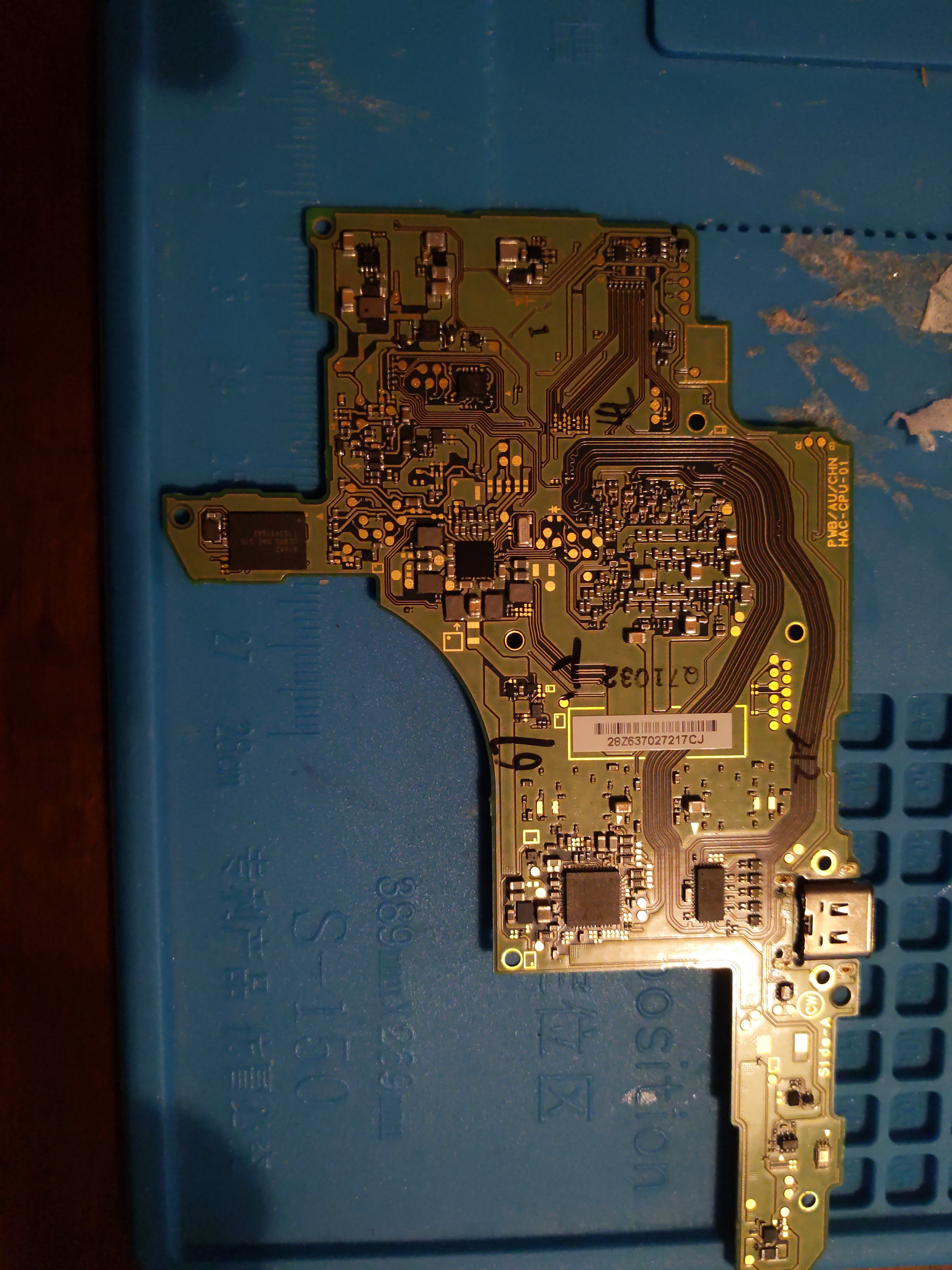

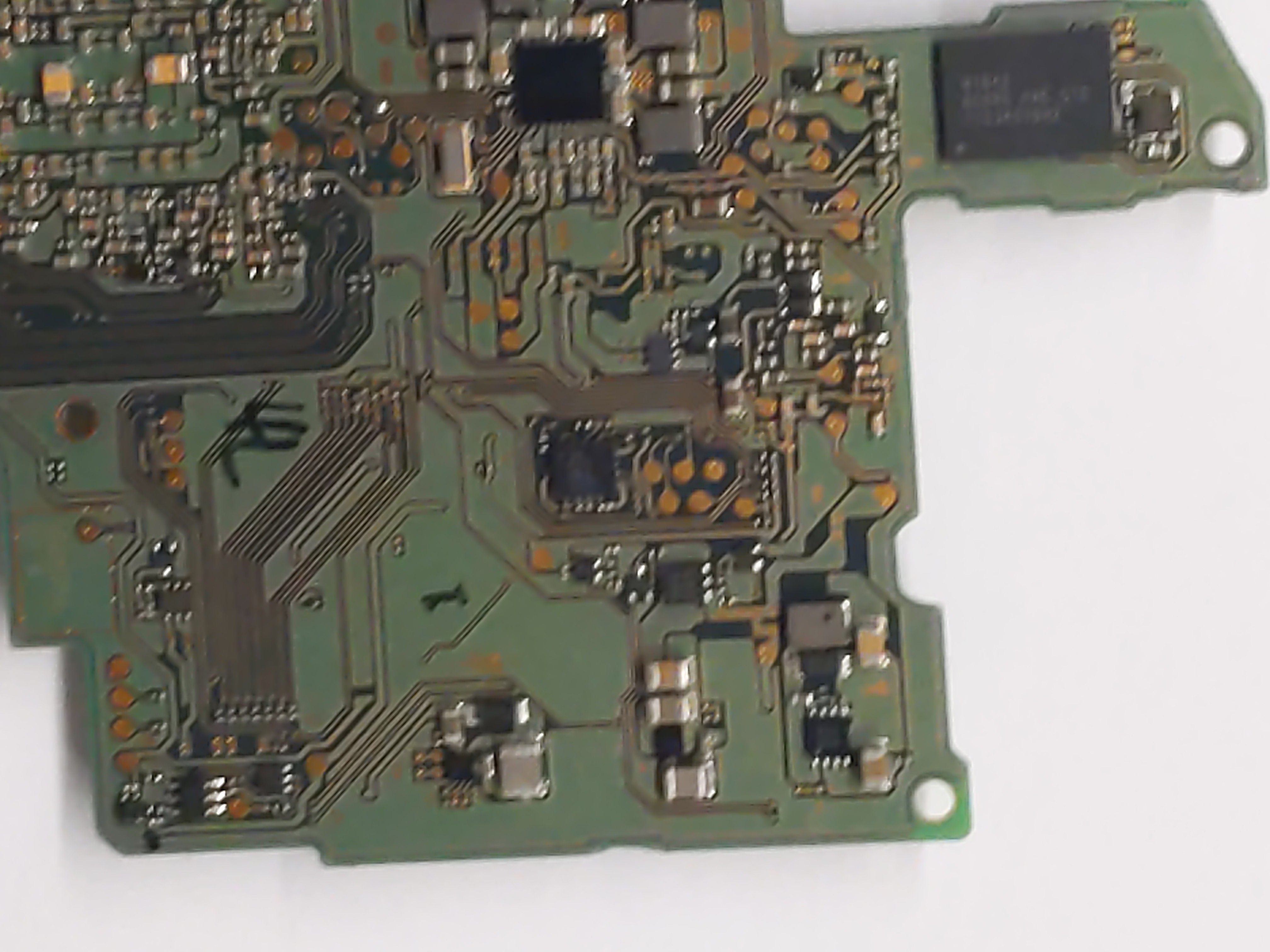

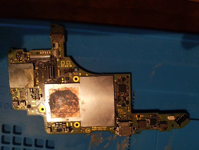

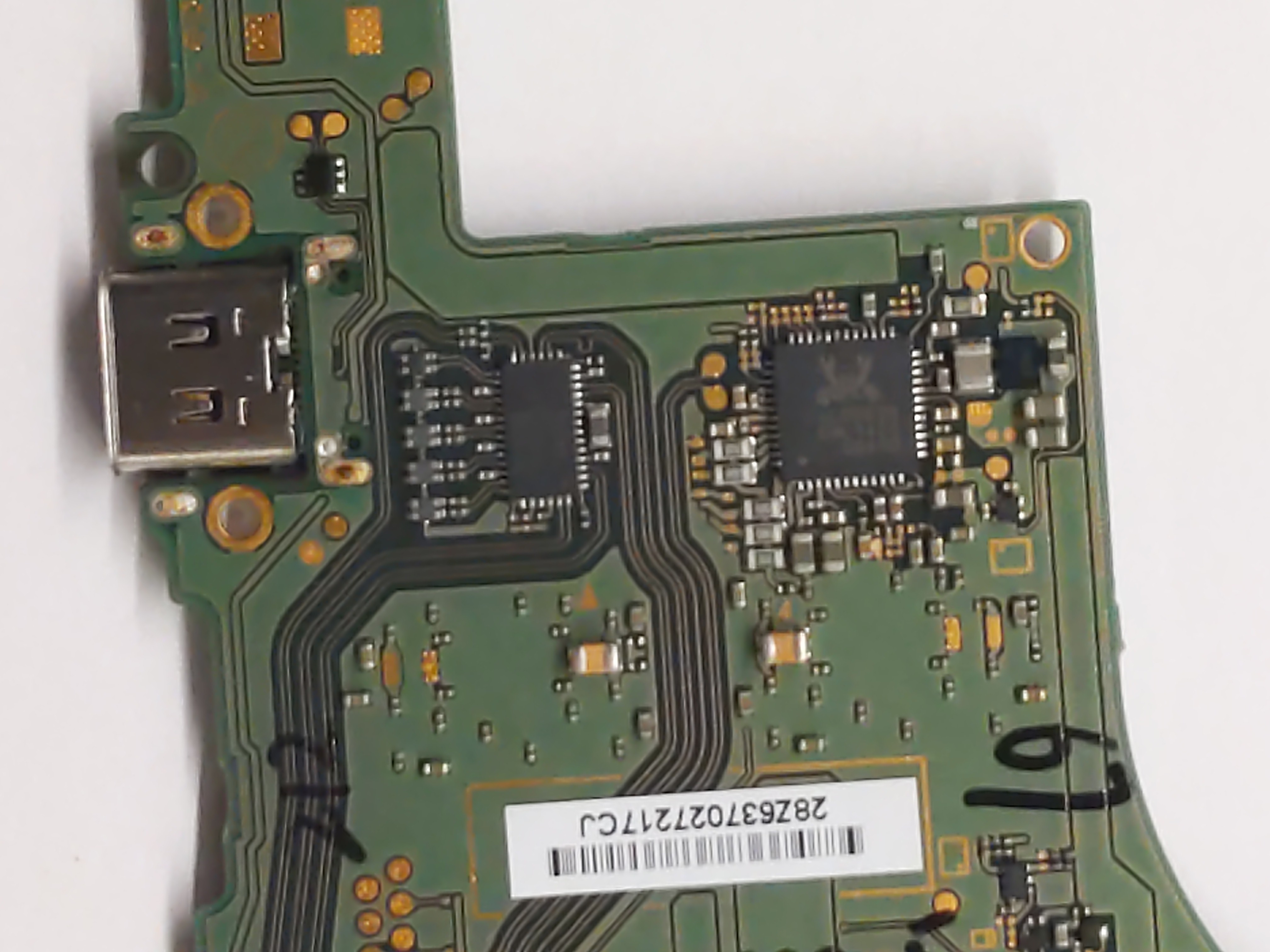

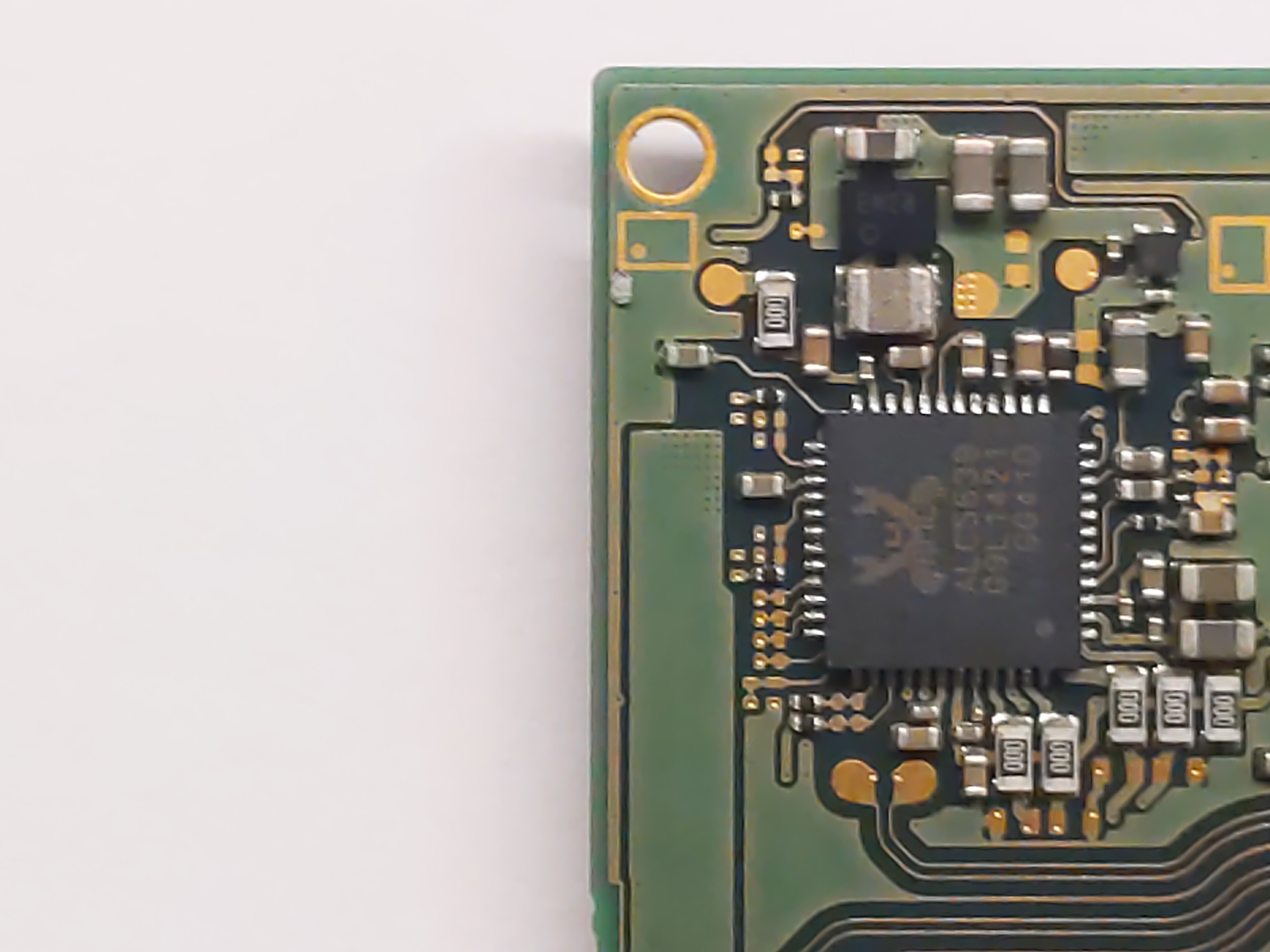

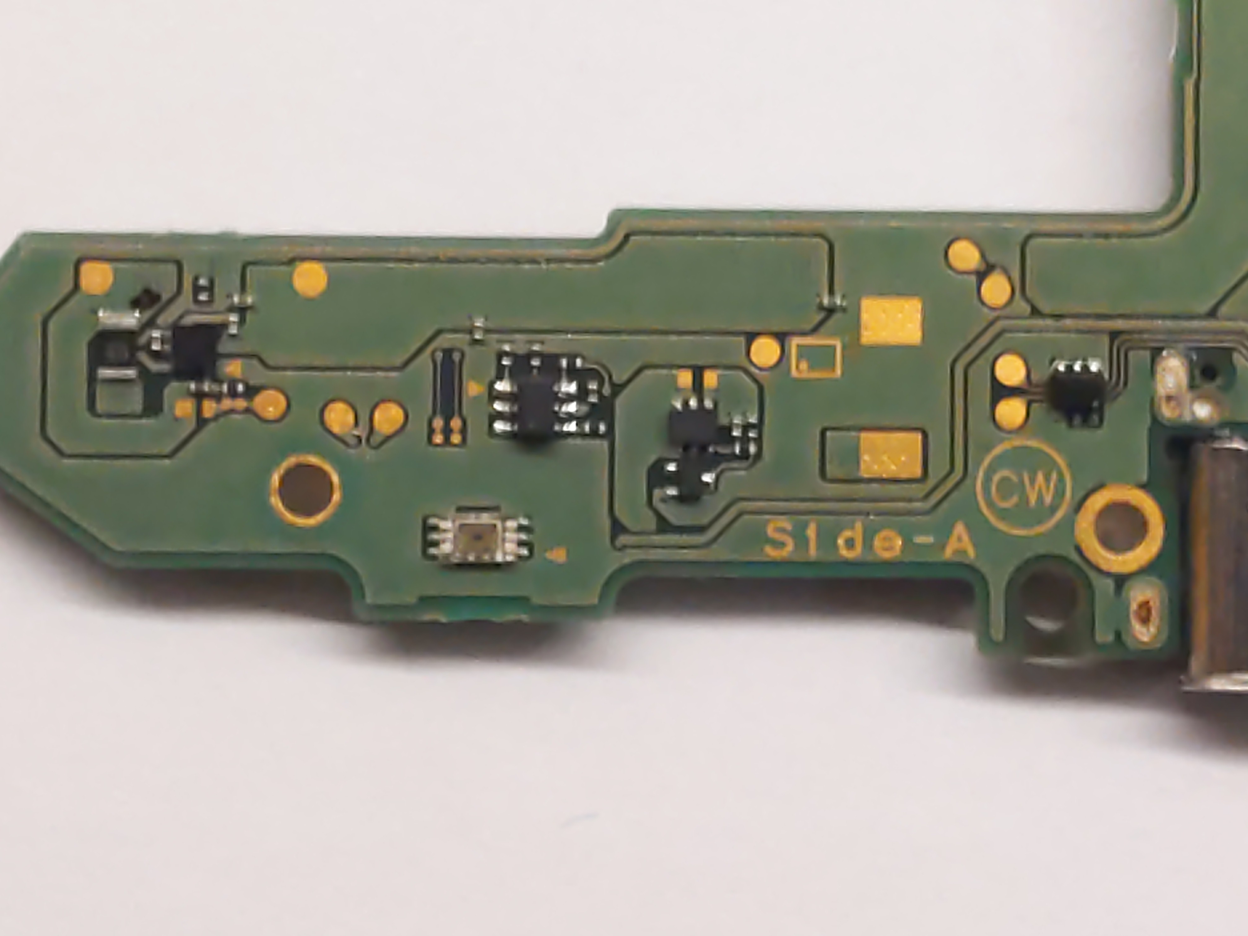

Can you take a photo of the board front and back in it’s entirety.

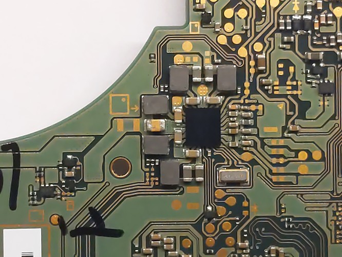

As well as a closer photo of the “enc” IC below the realtek chip.

I will change the USB port as well as the MT92 chip when I’ll receive a better flux (the one I have is not great for this kind of work I believe.
Yup, somebody has had a crack at that USB connector and i can clearly see indications of burnt/charred plastic which can cause serious issues over time…for example 5V/15V getting where it shouldn’t :frowning: I can also see board/trace damage or it’s flux residue (hopefully the latter) above USB on rear
I’d remove it regardless of whether you have a replacement ready or not as further testing can take place with the battery on it’s own.
Also maybe it’s just the light in your pics but the ESD diode on the boards rear (near “CW” marking doesn’t look to healthy.
Bear with me as i haven’t yet documented the 3V3 (“enc” ic) area, but from memory theres a 1.8V enable signal going to one of the points around there, i’ll check.

Sorry, Been having a hard time positively identifying the “ENXX” IC
On first glance it appears to be either TPS63025x or TPS63024x but there are some inconsistencies, I’m not too worried about the markings on the IC not matchinng the datasheet as that’s typical but the physical dimensions are a hair different… i measure the one on the board at 2.30mm x 1.70mm
Even so, the application circuit lists identical support components (inductor, caps etc) compared to whats on the board so somewhat confident.
OnSemi and ST have converters/regs in similar packages with the same pin/ball count and pitch etc but as far as i can tell none of them were a match pin definition and layout wise.
I’ll finish buzzing everything out on a donor tomorrow and after will hopefully positively ID the IC as a result, afterwhich i can give specifics of what/where to test.
Would welcome any thoughts though from others in regards to “ENXX” identity and if I’ve missed something obvious?

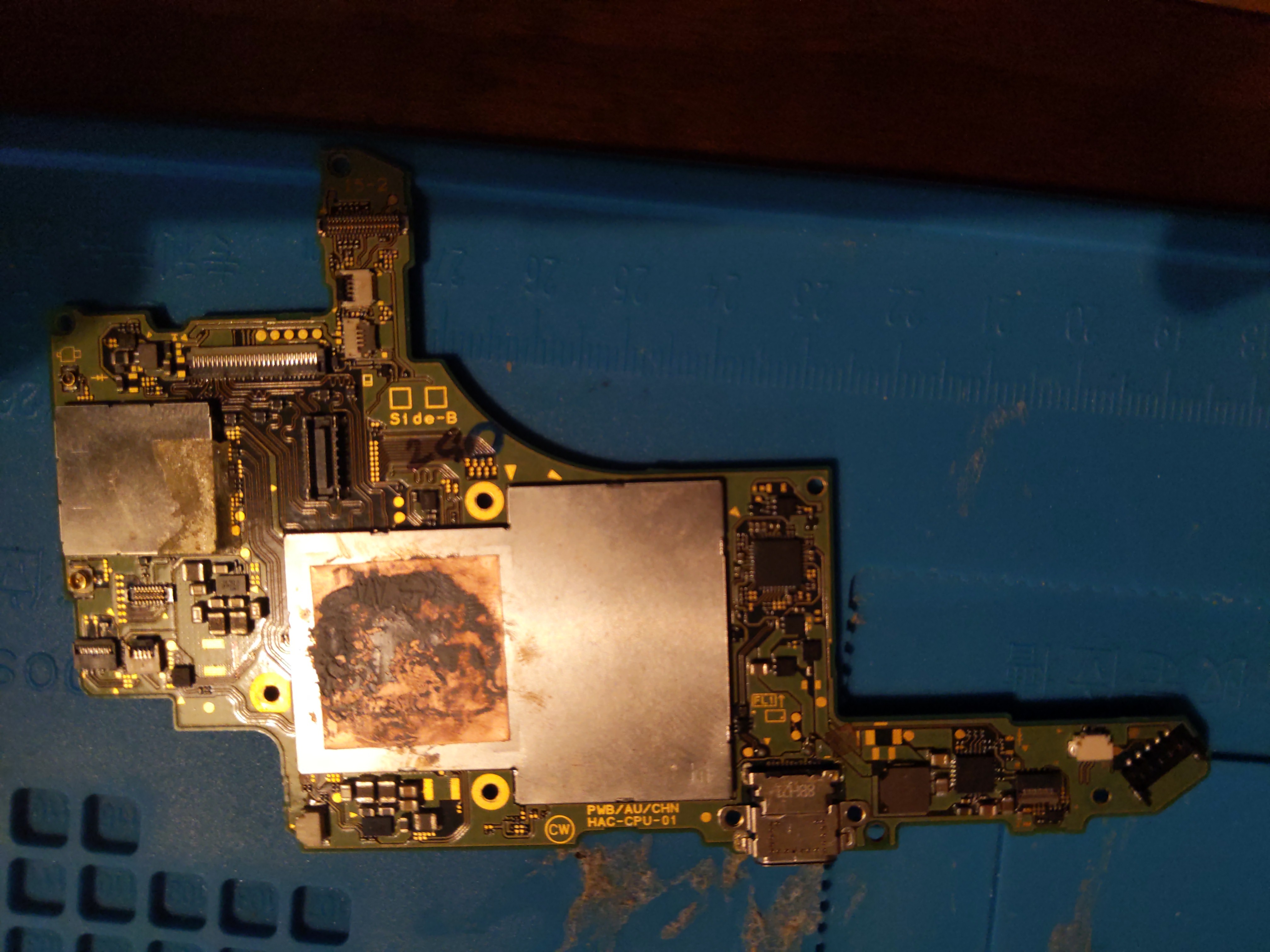

@broleke In the meantime though, is there any chance you can take a pic of the boards rear in better light at some point? there are a couple of other things catching my eye but it’s hard to tell because of the photo quality and lighting.

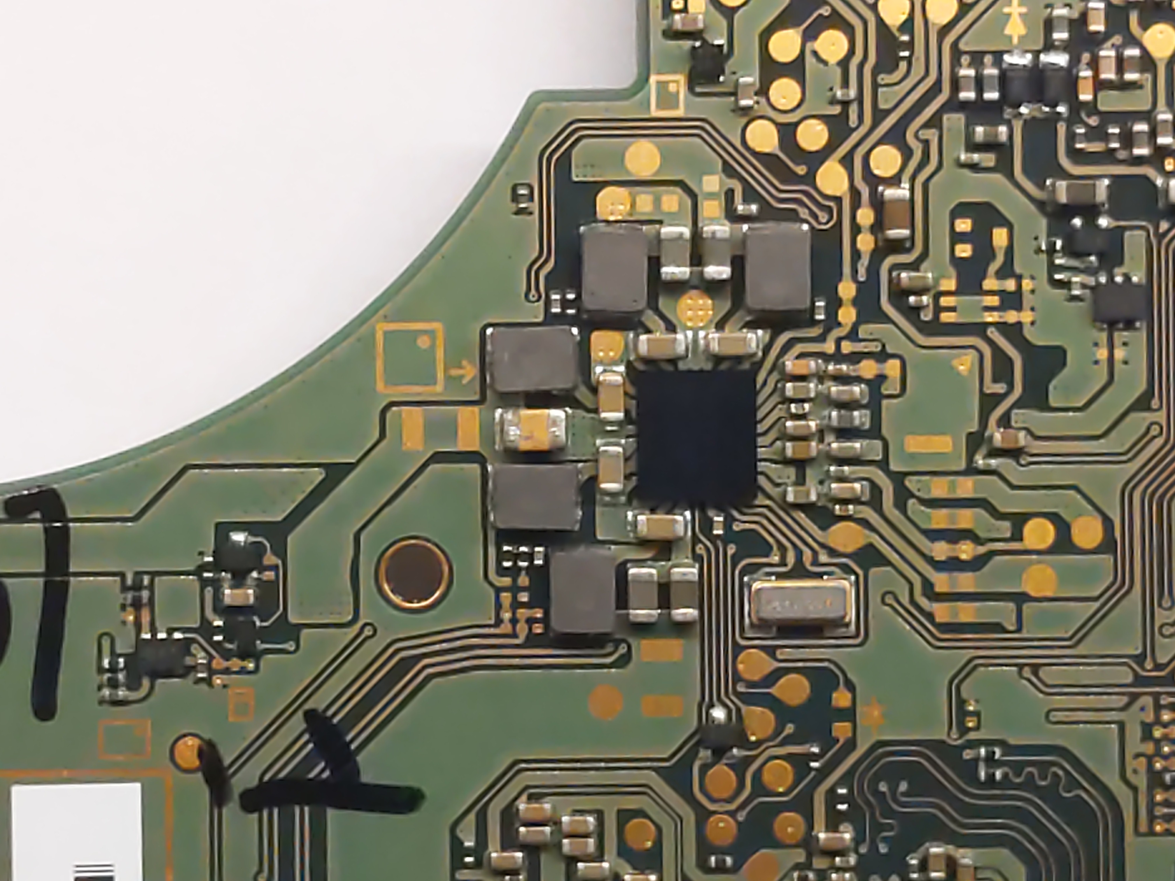

I have 1.5V in diode mode between CC1 and CC2 (just on top of the CW writing).
Please unplug the battery and the charger, put the red probe on ground and with the black probe test the six legs from the ic and compare the values with them on my post.
Apologies, I made an error earlier while viewing the datasheet… In order for TPS63025x or TPS63024x to be the correct IC/s the Pin layout would have to be flipped (and even then, there’s an issue)
Even so, I’m pretty sure the “ENXX” IC is a TI part and is either a custom variant of TPS63025x or TPS63024x or a rebadged variant of another TI chip spun off from this series (which I’m unable to find) - Checking the various signals on my oscilloscope mirrors the figures in the datasheet 1:1 including inductor freq.
Though if I’m wrong I’d be happy to be corrected. As ST has some very similar specced packages but none were quite right when looking at my scope, given that though, it’s possible it could be from another manufacturer.

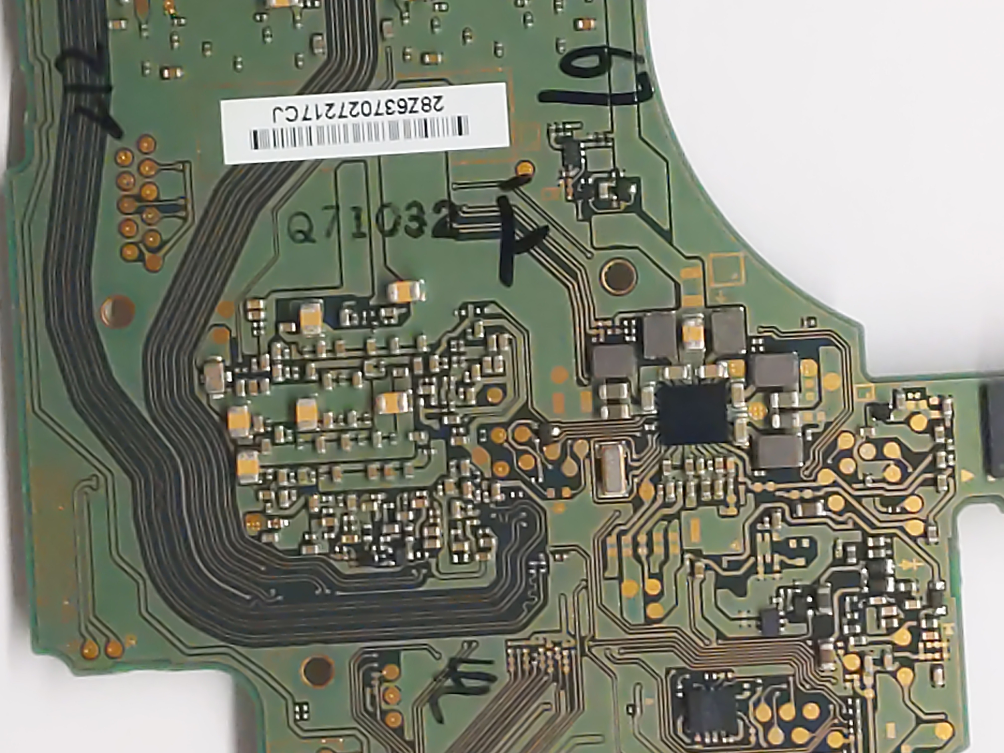

Regardless your welcome to see my crude mess here
So @broleke in your case, you could connect battery, prompt to boot then carefully measure voltages at the following points and post results.
Afterwards, disconnect battery power and take resistance measurements at those same points relative to ground both polarities.
And also resistance measurements on the following capacitor (both polarities)
Here the measured values in diode mode (from top left to bottom left)
0L
0.4795V
0.0000V
0L
0.4788V
0.0000V
If checking the 4 probe pads (from top left to bottom), I read:
0.3872V
0.3872V
0.4783V
0.4783V
Thanks and sorry about the next naive question, but how should I measure something on side-A ?
Do I only need to connect the battery wire and short some pins on the power button connector on side B ?
The resistance for side-A are (from left to right):
  • 1.5MOhm (fluctuating down)
  • 253Kohm
  • 149KOhm
    And for the capacitor next IMX7, 43ohm and 50ohm (reverse polarity).
The reading are fluctuating a lot (decreasing continuously), this I cannot explain… but my electronic skills are somehow really limited.
Values seem fine afaict

Assuming this is from the larger test pad? could really do with the opposing probe polarity readings here.
I have an idea whats iip but i’ll wait til you get those voltage reading first.
From memory that’s good, and we can rule that rail out :slight_smile: just wanted to check as this and other caps on the rail looked somewhat dull
I wouldn’t worry too much about this, your are in effect charging up components when measuring on the board in resistance/diode mode switching/changing polarities can exacerbate the problem depending on whats in circuit

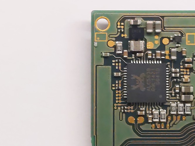

Man…talk about being completely wrong…forgot about Richo :roll_eyes: :roll_eyes: So i take all i said about it being a TI part back.
The IC is a Richo - RP602Z330C
more info here n-redc.c o (dot) jp/en/pdf/mark/me-rp602z.pdf
Dimensions are inline with what i measured earlier.
Unrelated but, renesas appear to have a pin compatible part also on first glance
So other forums concluded the IC ENXX was a headphone amplifier. Sounds like that’s not the case?
Yeah, it was a user here who said it but, was very mistaken, it’s 100% a Richo RP602Z330C
If that particular user swapped it for a headphone amplifier i would guess…bang :wink:

The same as before, the 4 points around ENXX highlighted in the pic earlier, and if you can overlay your measurements in the pic too it will probably save some confusion
And be really carefull with your probes in this area
