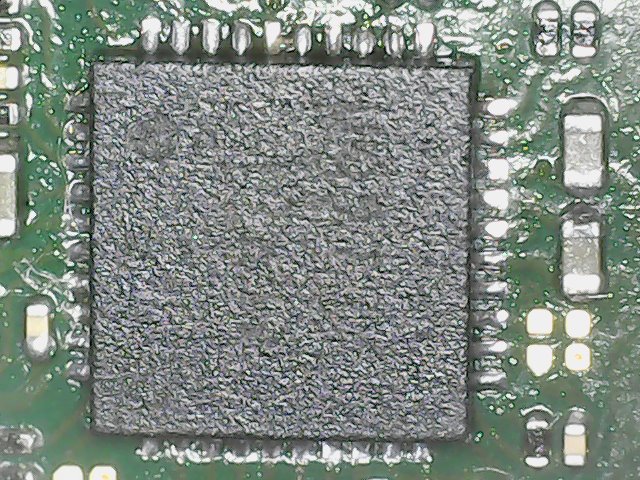

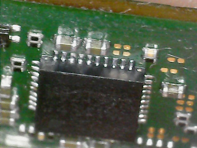

I quick update, I soldered a new BQ and m92t36, now I have 0.10A but I doubt if I soldered correctly.
I’ll update this post with some pics but i’ll try again to solder them again or rework with the soldering iron the externals pads to be sure that the join is correct.

Today I just replaced for third time the M92T36 with a new one, now all measures in diode mode looks good and no shorts
First try I see 1,39A connected to 5V charger, backlight on.
In a second chance I only see 0.40A 0.39A (same charger) backlight only is on for one-two seconds, CPU is not warm.
