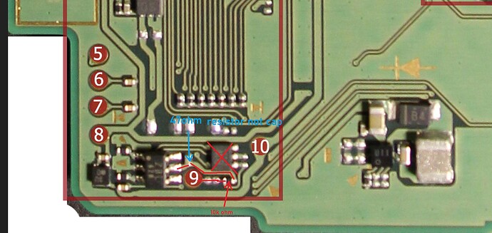

Are thoes values correct? i look at the second side of the board and it look like on the photo…
Or that capacitor is burned and change colour + multimeter show me the 47ohm to the ground because of that? i don’t have that IC that is under the red cross. I search all over the switch but it wasn’t inside of it.
It’s look like that board. Can someone Give me that resistor and capacitor value please?
What’s the IC near the capacitor anyone know?
