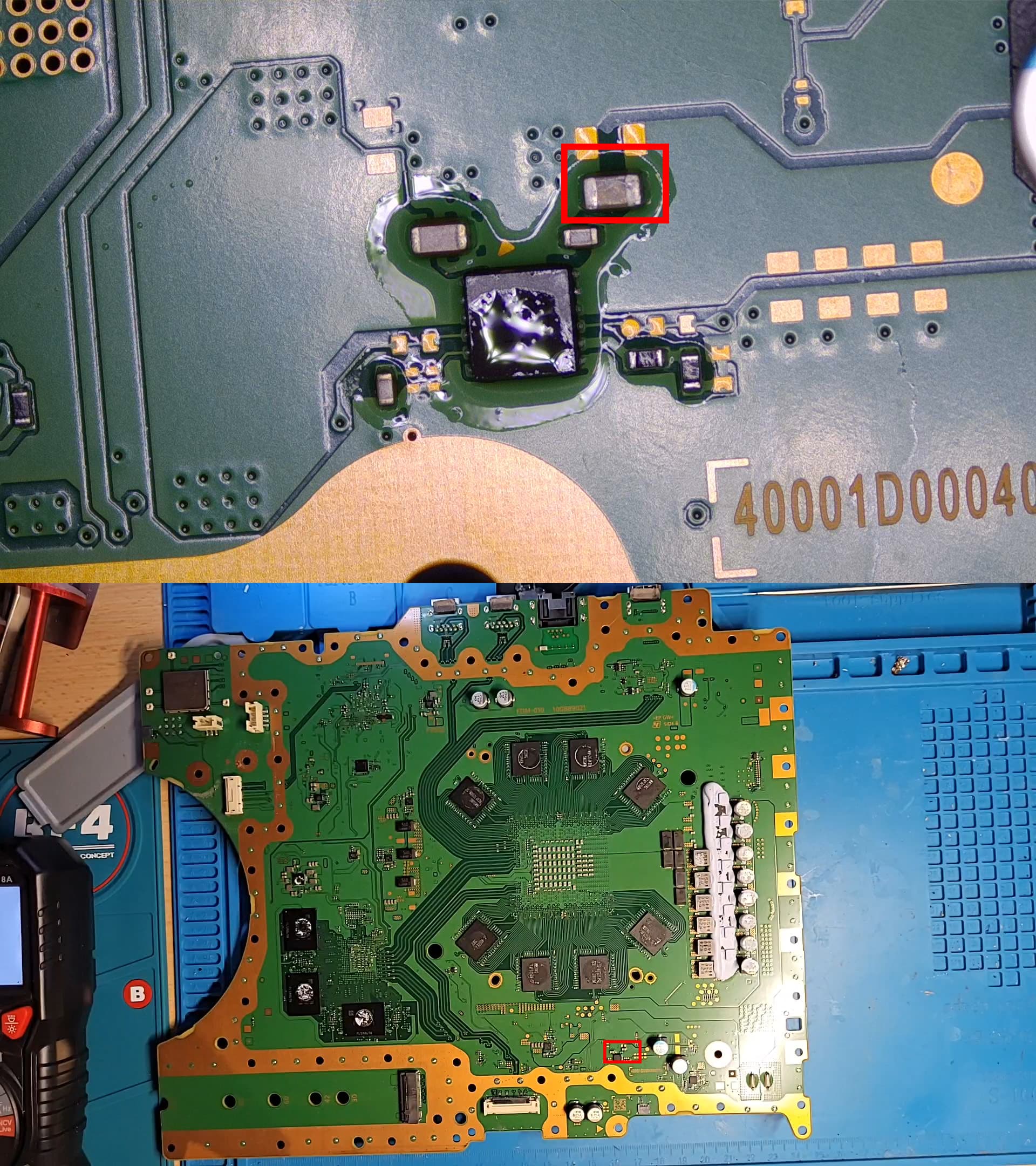

I have a PS5 with 2 second blue light and then it seems to turn off but another press on the power button just beeps, so it turns off after the second press on the Power button.
The fan also starts for the time the blue light is on.
I found a shorted cap, soldered it out and the short is gone.
Can anyone measure or tell me the value of this cap?
I don’t have another PS5 to measure it myself.
