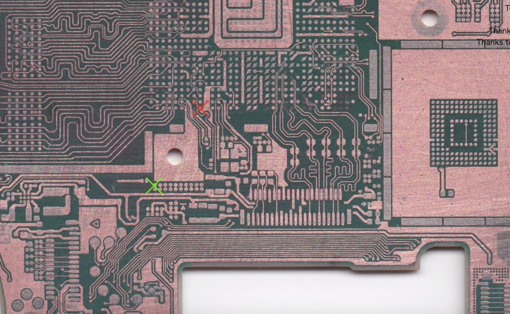

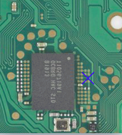

i success to fix error 2002-2629.
There
スクリーンショット 2022-12-31 2.56.56
was an open line. probe to a pad under CPU and made a jumper.
now no error and read the cartridge.
Thank you!
@jiiko2361 Could you describe exactly what you did? I have the same problem.
