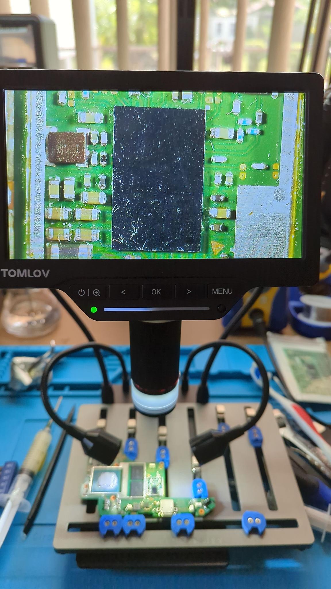

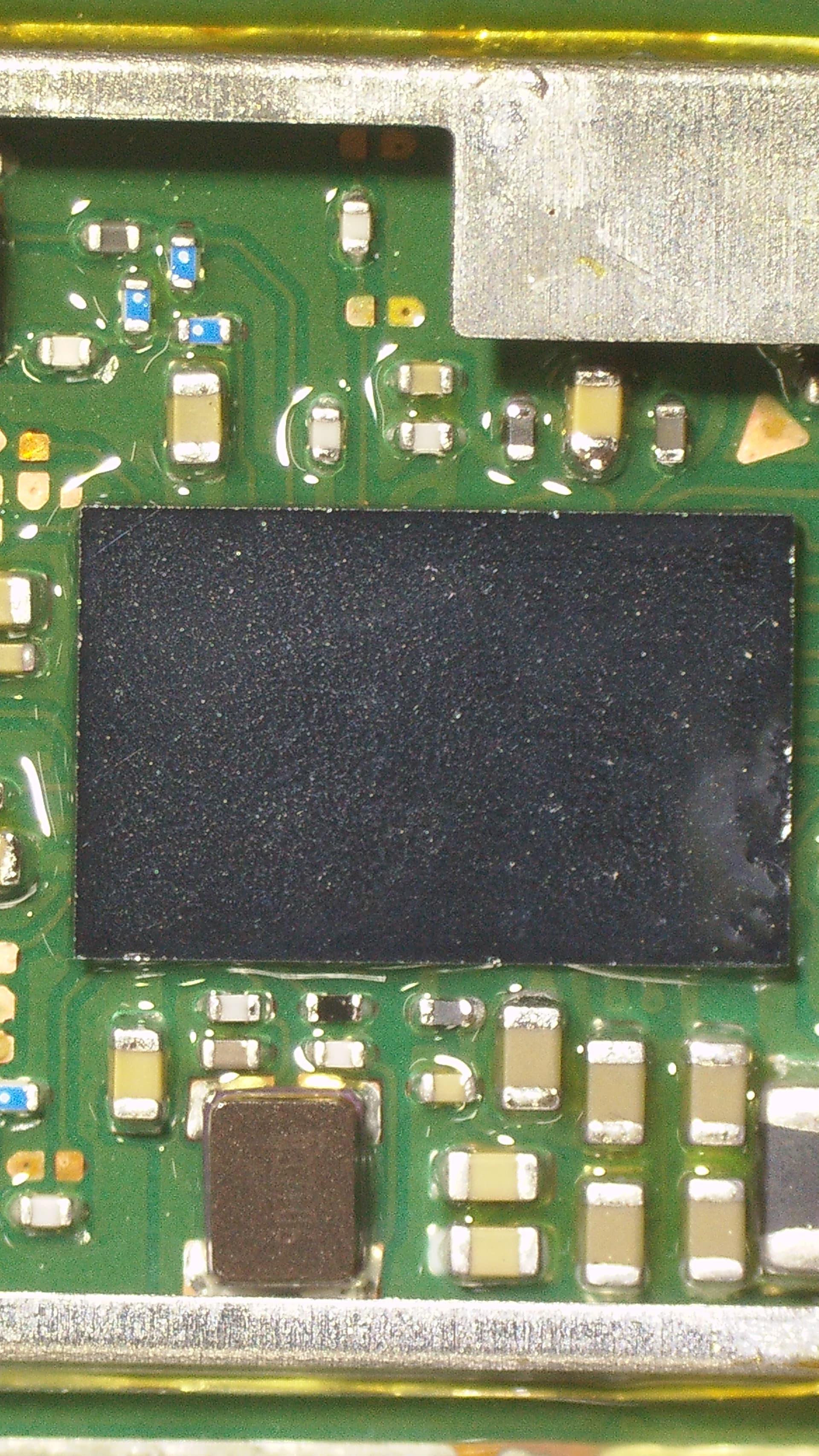

ok. little bit of an update. i received 3 new CYW4356XKUBG chips from china. this is the same as my original part. they were in blister packs still and pre-balled. i removed the one i had and did what seemed to be a successful install of the new one.

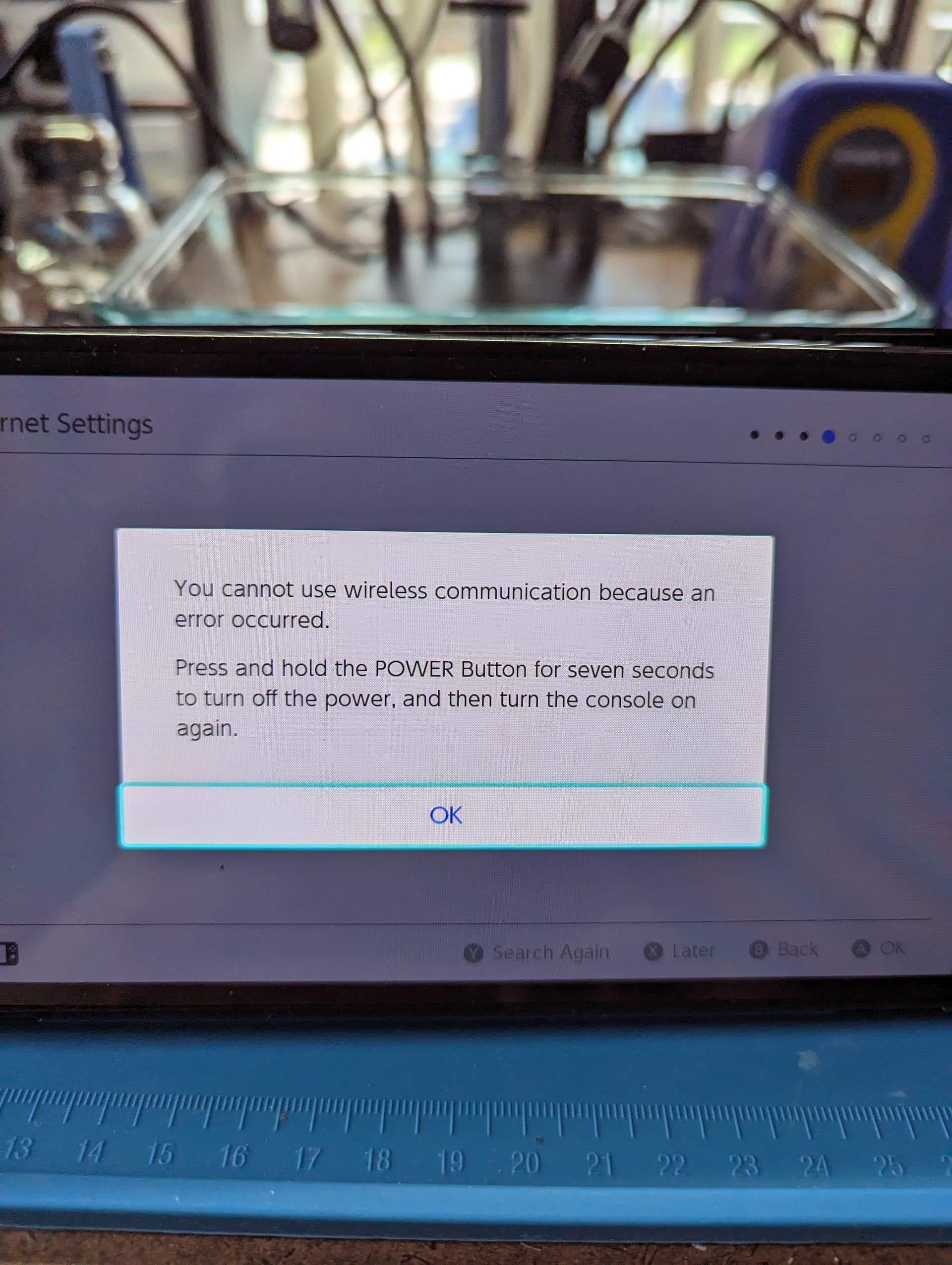

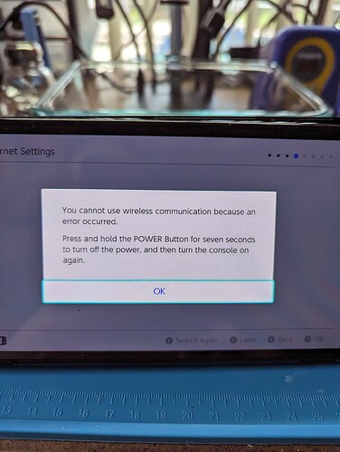

however, when it came time to ‘connect to the internet’ on the setup process … well. … it threw this:
i hit the OK button, it dumped me back to setup. i choose to setup internet later and it went on to wanting me to remove the joycons and test. i removed them. but it didnt recognize them in wireless mode. and you can’t move on in the process from there.
soo. it seems it recognizes the chip enough to not give me a 2107-0445 error. and it boots up. but it has no wireless functionality. i have since done more research and i guess the chips need to have some sort of nintendo info on them to be fully recognized.
