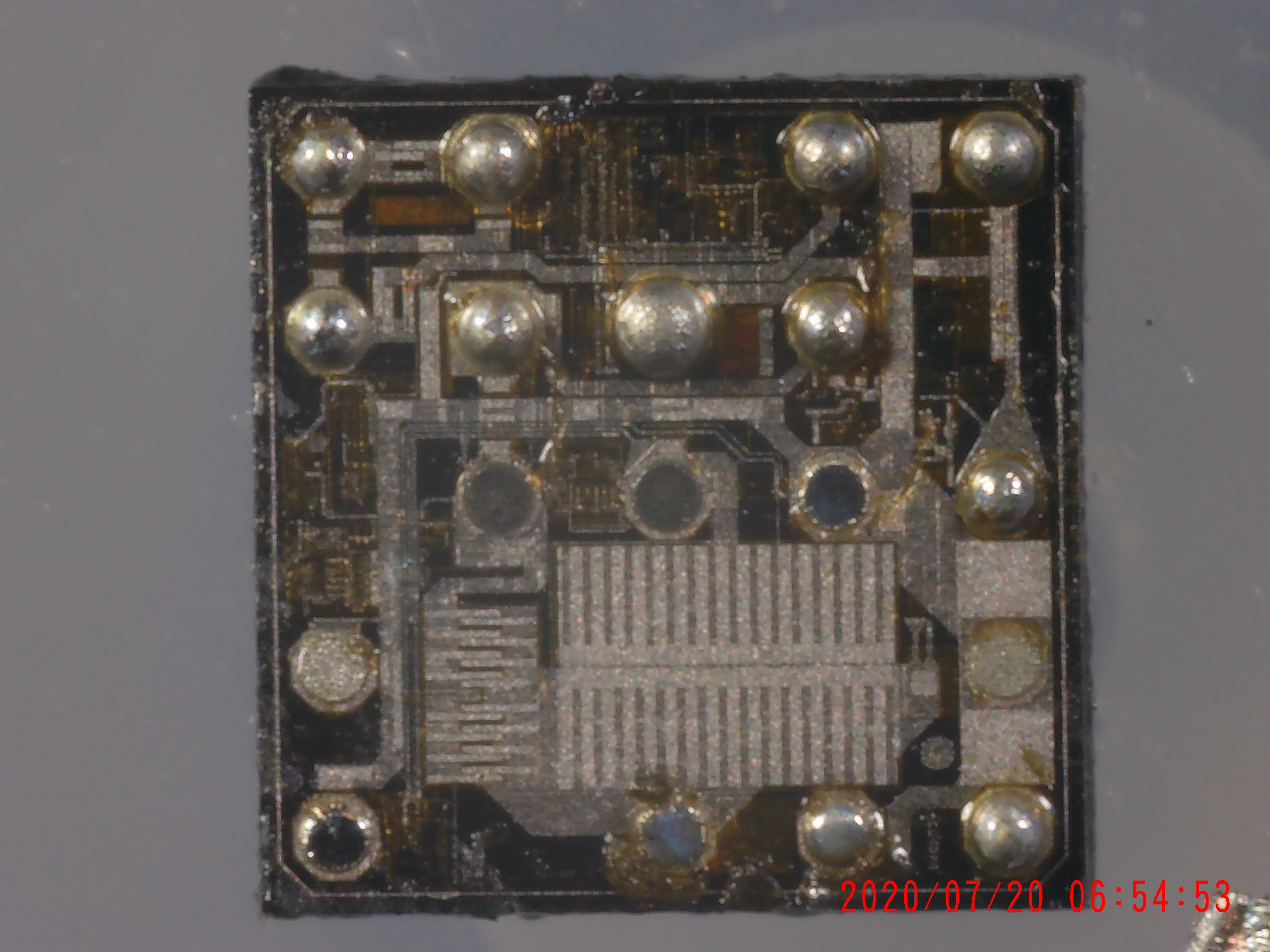

After thermal grease replacement my xbox cant work in autodetect mode (So i cant play in 4k with HDR and freesync). I have replaced TDP158 but it doesn’t helped me. I think I found the reason because U21 chip is broken. Unfourtently I cant identify what is it and where I can buy it.
Could you please help me?
You can find pictured of the broken chip by url imgur. com/a/H92tunl
It’s an ESD Protection and Signal Booster for HDMI Source IC, made by STMicroelectronics, but you can’t buy it, because STMicroelectronics hasn’t released it to the public yet (there is no datasheet for it), so at this moment you can only get it from a donor board.
