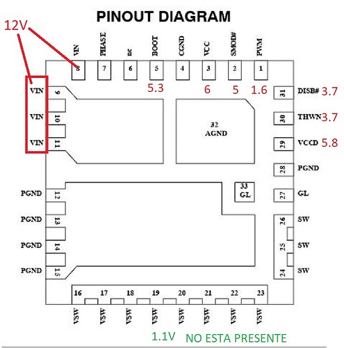

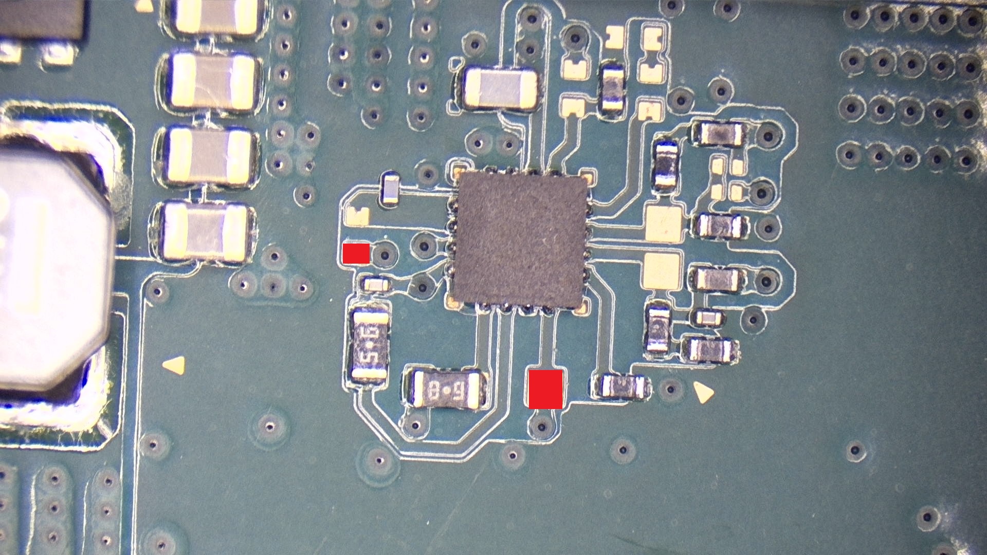

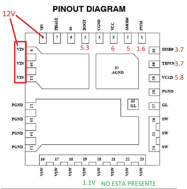

Returning to this topic, I have realized that the VCORE 1.1 voltage is not present. In principle, the MOSFETs that create this voltage are fine and have both the PWR and BOOT signals, and all the input voltages. Could it be a fault in the APU?
These are the values ​​in Volts of the mosfets that generate that voltage.
