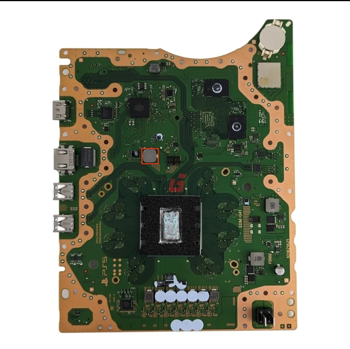

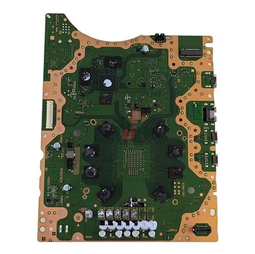

Hello, i have ps5 slim edition that beep on and blue light but suddenly off, i try uart tools and get single error code 80810001, i have try console fix tools but it only for edm-010-020-030 did you have suggestions for edm-040. Tq
I have questions: how to know ram ic is shorted, and what components need to check for that? Tq
Hi for me they are not short circuited. they have very low impedance hence your reading. If there is a breakdown, you have to look elsewhere. During the 2 sec does the fan spin? Have you had any other error codes that could give you some clues? Blod 2 sec is terrible; There are plenty of videos with more or less the same breakdowns. Personally I never come across this one ![]()
Hi thanks for your reply, did you know how to check ram ic is shorted or not, i have pull out all the ram ic because this unit has crass on every game. Tq
