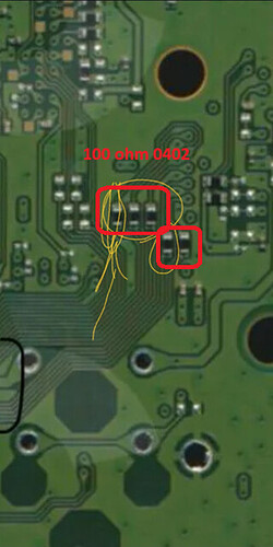

Accidentally knocked off one.of these resistors . Trying to find the one i need to replace it
Hello I accidentally knocked off one while replacing the original sticks to TMR sticks. Because of stick drift.
Its one of the rectangle black ones . I’d post a pic but for some reason it will not let me. On the BDM-010 dualsense board there is a cluster of 5 stacked 3 then 2 on the right side above the joystick. The one I knocked off is the 1st of the row of 3 in that cluster..
now I have to figure out what exactly these are (i think resistors) and what one I would need to replace it to repair my controller. Any help would be greatly appreciated.
I think i need the number and value or something. Or even a link to what I need would be amazing. I just don’t know for sure
My dualsense board is BDM-010.
Its a rectangular resistor with and black square in middle and 2 silver ends.

(https:_//i.postimg.cc/j2sHygWQ/BDM-010.jpg)Here

Are you able to see the pictures?

I don’t have bdm010 by hand, will let you know when I have a chance
Thank you so much. It would be a great help if I can figure out what to buy to try and fix it. You seem very knowledgeable and I’ve seen you answer a few others. I appreciate the help truly.
I think its a resistor just do not know the size. 0805 or 0603 or 0402 and the value..

Im new so I could be completely wrong. From the Picture i linked to BDM-010. All those are the same size the one missing is the one circled with an arrow pointing at it. They sit above the rightside right joystick. I’ve been looking for schematics and I just can’t find the info.

just confirmed those 5 resistors there are all 100 ohm, size 0402 imperial
