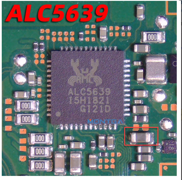

Anyone know which cap I can use. I took off the cap off another board and measured 7 uf and I know its a 1.8v line that feeds this cap.
Can I use a 10 uf 6.3v cap?
In case someone needs this info. I was able to find the schematics for the ALC chip and verified that it calls for a 6.3v 10uf cap.
