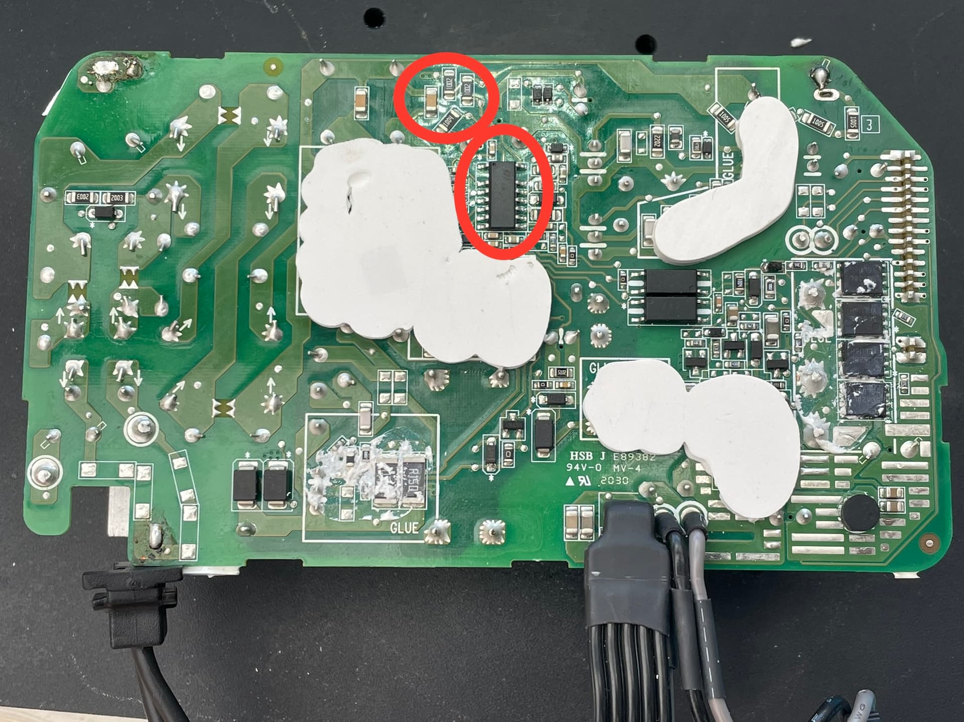

Problem is I don’t really know where to start, I can tell the fuse is ok, and power goes at least until the giant caps (350V tested).

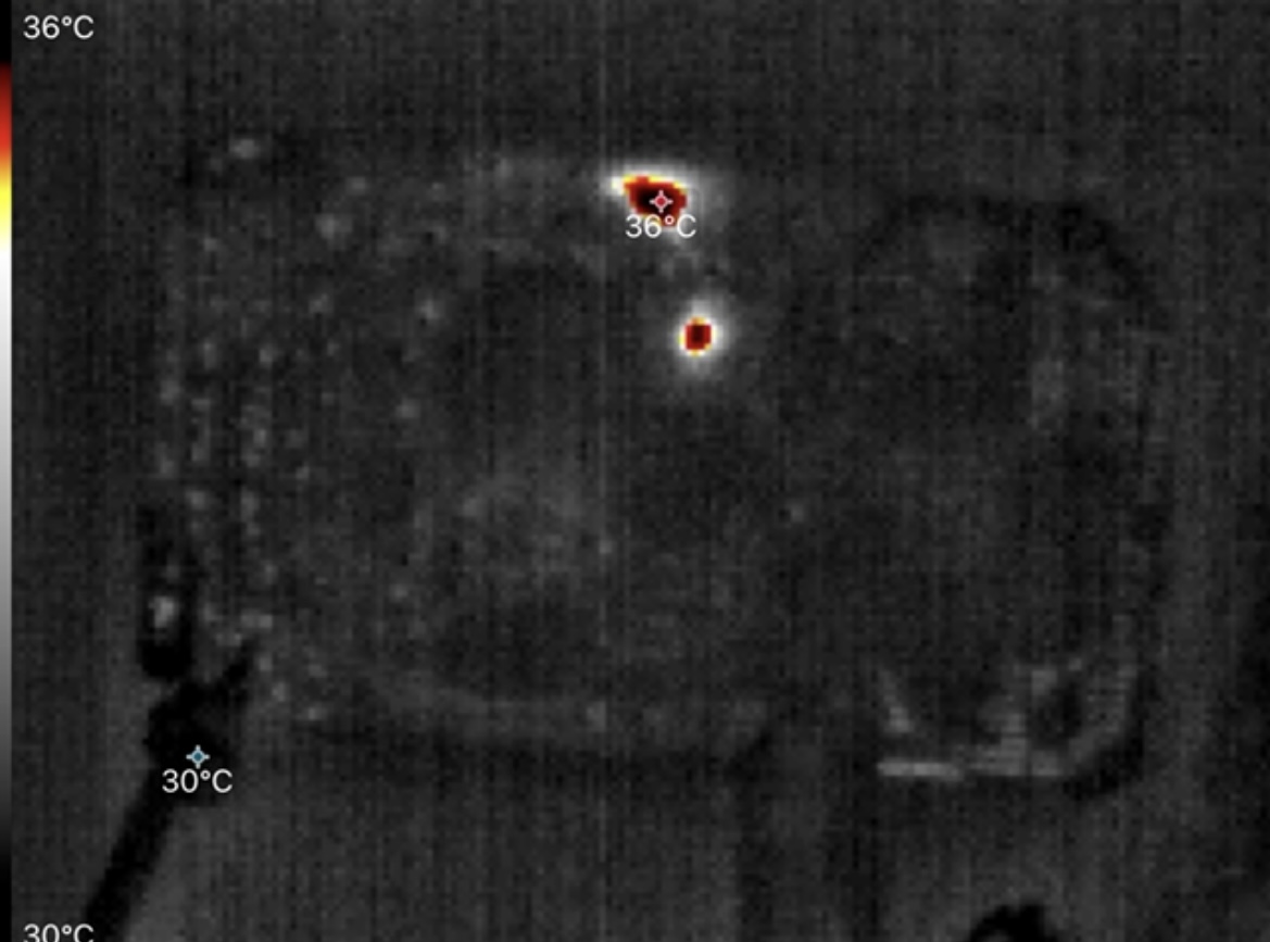

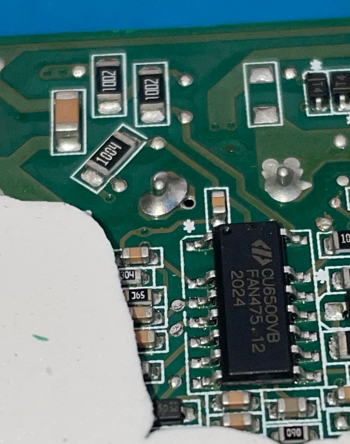

I tested it with thermal cam but nothing very interesting I think, there’s an IC heating but I think too little to be a short (~30°C).
As it seems power is cut somewhere, could I inject a voltage on the 12V pins or is it a stupid idea?
