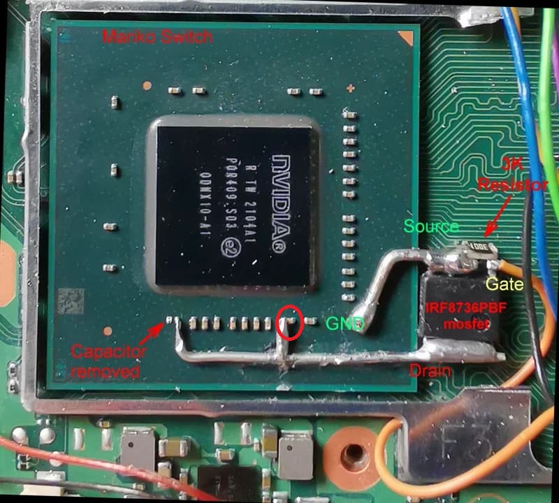

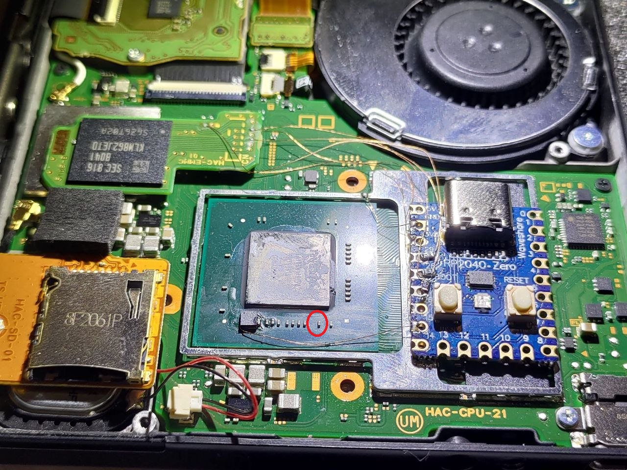

have a broken cap on a mariko apu. can i replace it with a cap from an erista apu? circled red. thx
          yes, both sp1 and sp2 caps on either Erista or Mariko APU are same 1uF cap
          are the caps on the same row also 1uF caps?
          No, I cant remember the cap values in between sp1 and sp2 , but they are not all 1uF. Only sp1 and sp2 are 1uF caps
