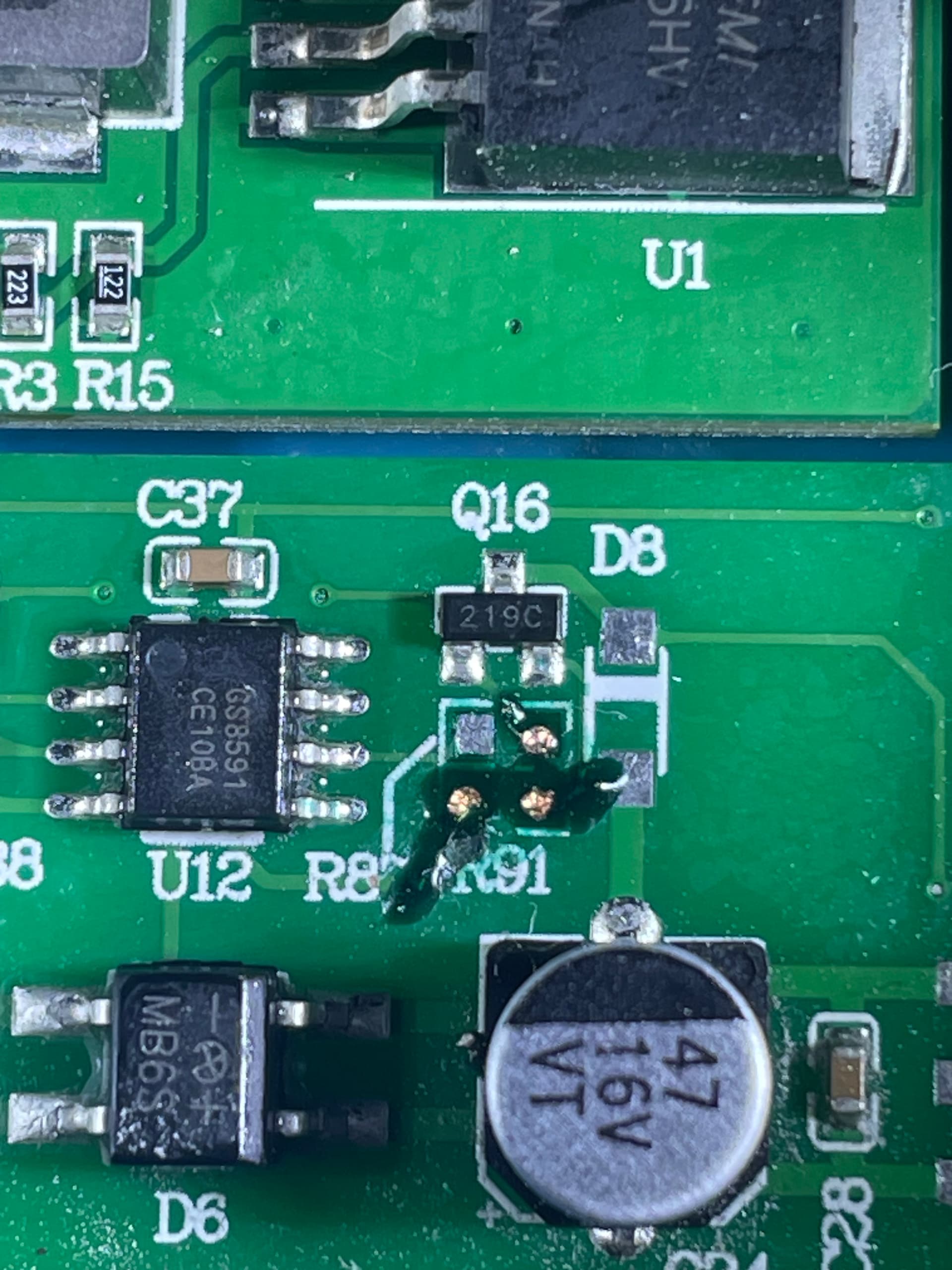

I was using it for a repair when, all of a sudden, I got an E10 Code and it stopped blowing hot air. I can still turn it on and off as I please.

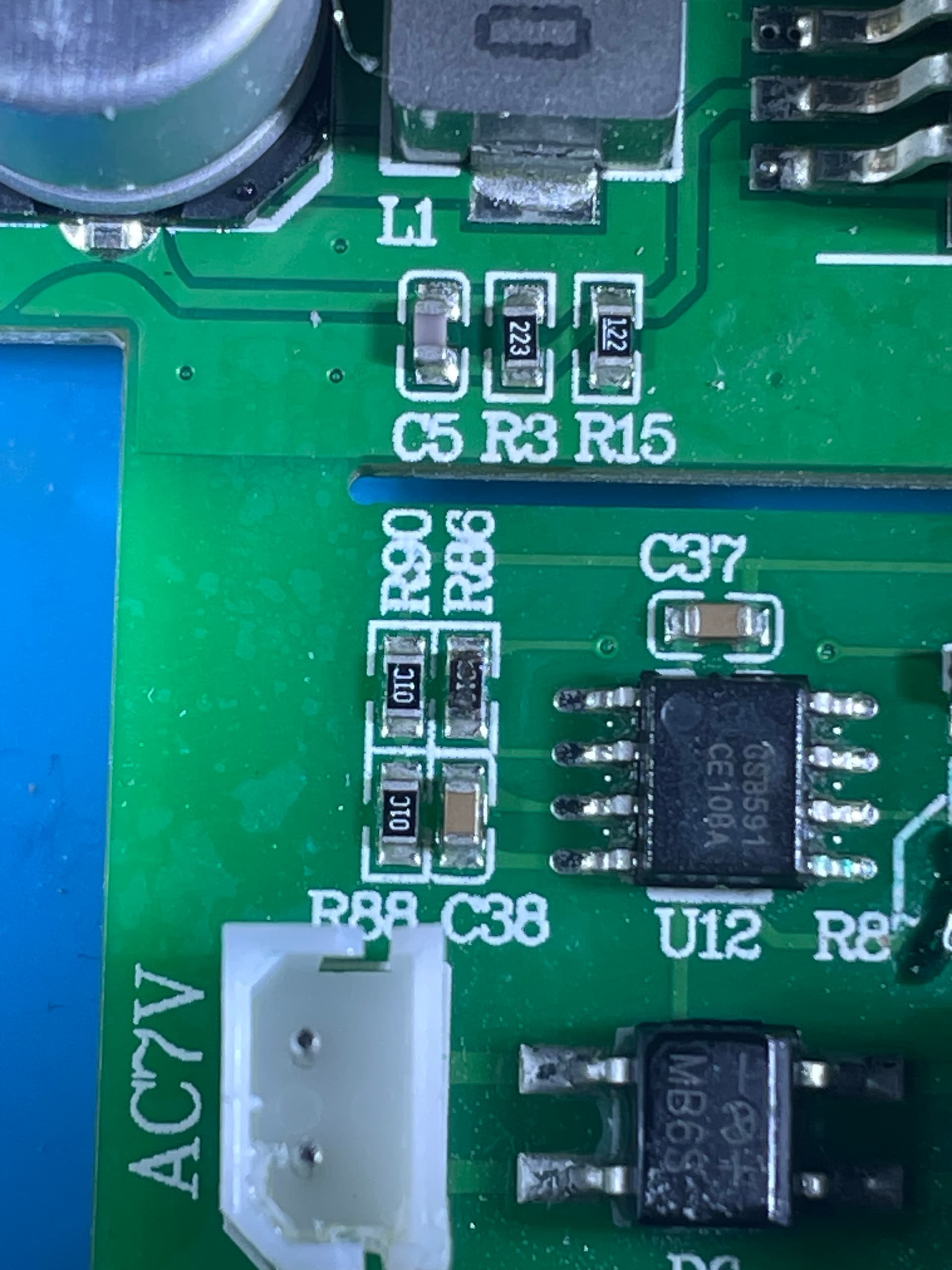

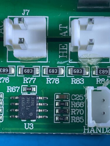

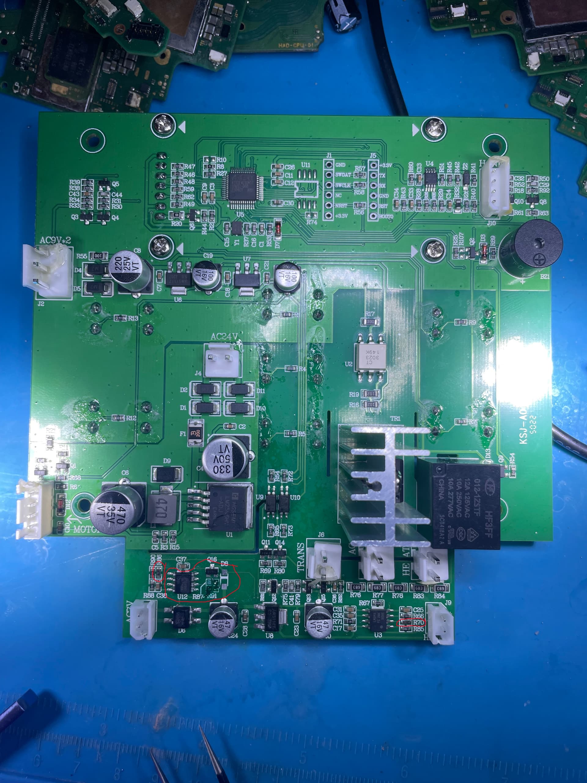

I opened the device to see whats wrong and found several blown components. I don’t know if this is the right place to ask for this, but maybe someone had a similar problem and can give me some of the component values?
The blown components are:
R86, R87, R91, U12, D8, Q16 an R70. Pictures are attached.
Thanks everyone for helping.
Hi
My ST 862 has the following labels:
R86 - 01C
R87 - 01B
R91 - 30B
U12 - GS8591 CE10BA
D8 - W7
Q16 - 219C
R70 - 01C
Hope this will help
