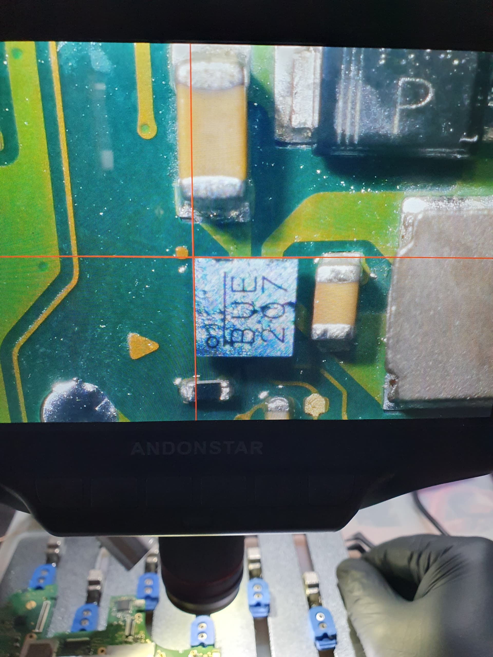

Hello everyone. I’ve had a problem with the backlight on the Switch Lite - not 17 volts but outputting 41V. The inductor gets very hot.
I changed the bga 9 pin chip with a new one. Still 41V.
Why so much? It needed 17V. Thank you

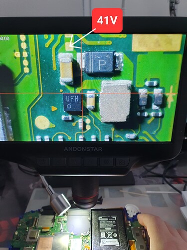

Where do you measure the 41v? at inductor?
Output
Any solution ? I Have same issue. My screen filckering because I get 24v intead of 17v. I replace main diode and Backlight IC, but nothing new.
Solution found, a screen with a faulty backlight is the guilty :face_with_peeking_eye:
