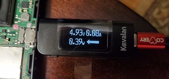

I got in the charge meter and it reads almost no current pulled. I have attached a picture below. Does this means that it is most likely either the M92T56 chip or the USB C port.
Both readings were the same both with and without the battery.
It s normaly the reading you get without battery. Do you have an other battery or the posibilty to charge the battery extern?

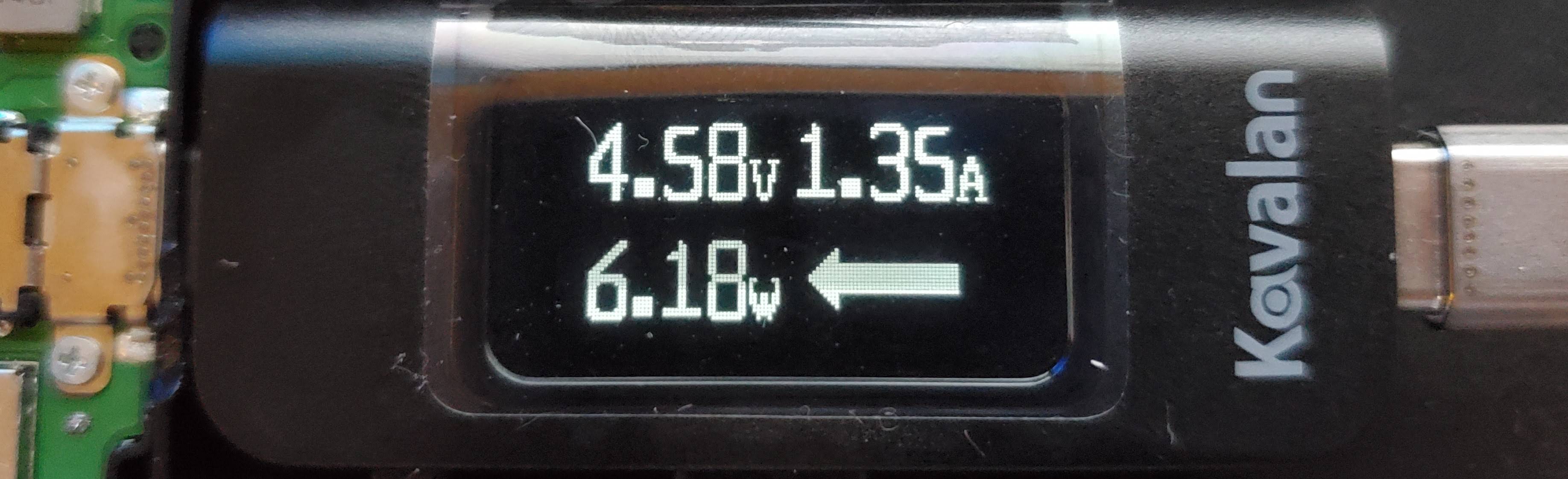

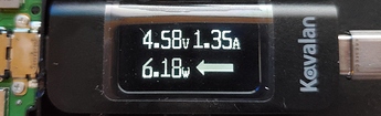

I got the new battery in and I have the following new information:
From here I am letting it charge and seeing if the battery percentage goes up. If it does my plan is to carefully pry off the old battery and use some of the padding from the old battery on the new one with some double sided tape to hold it down. Do you have other suggestions to test while this battery has partial charge (35%)?
Battery percentage has gone up 10% (over ~10-15 minutes) so it is successfully working now on all fronts that I see (USB-C data, Charging, Booting to Nintendo Switch OS instead of AutoRCM). I have removed the old battery and attached the old padding to the top of the battery. Now I just need to wait for double sided tape to come in to hold it in place. Do you have any recommendations on things to check before reassembling everything?
