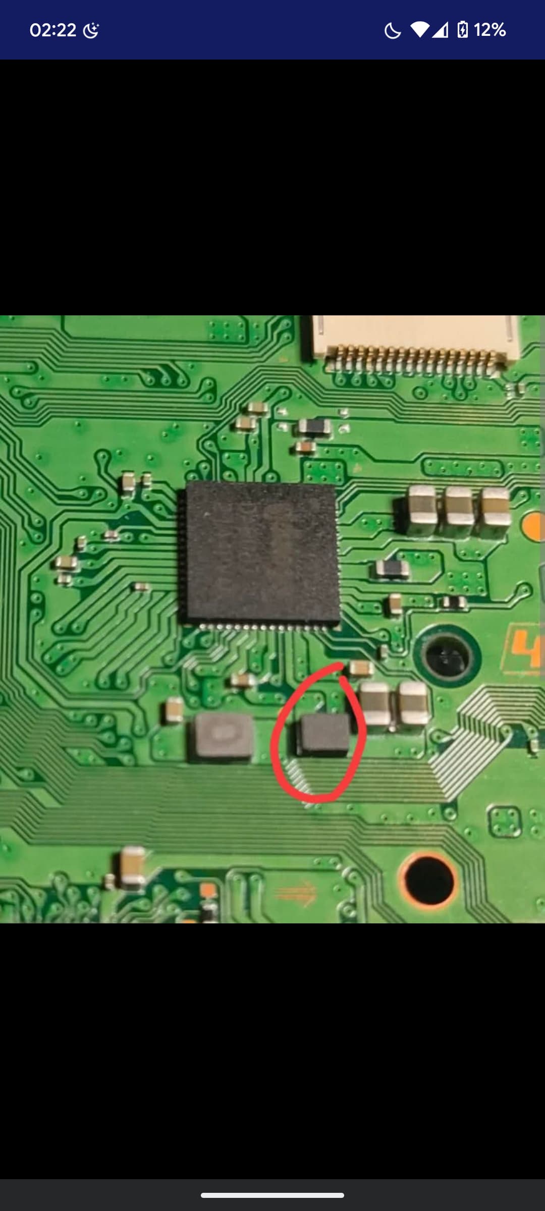

I need help with my BDM-020 motherboard. When connected to USB, it blinks orange twice. When I connect the battery, it doesn’t blink, and the computer displays an “unknown device” error. I’ve already replaced the DA9087 chip, SIE, and the USB port, and it’s still the same. Can anyone help? When I connect it with a cable and battery, the DA9087 and the capacitor underneath it heat up, when I insert a charged battery, the controller turns on and works, but there is no response to the USB.
USB C port what the DualSense is using has a different pinout.
This usb c port should work DX07S016JA3R1500
