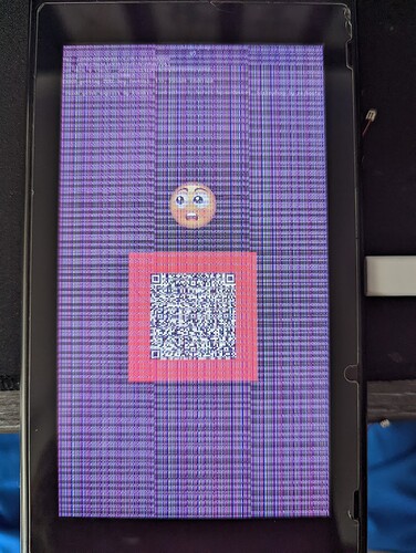

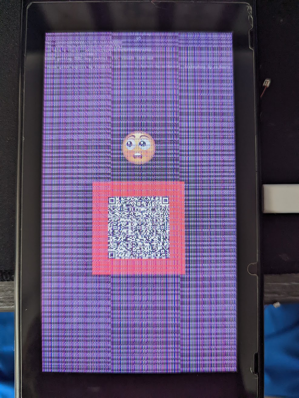

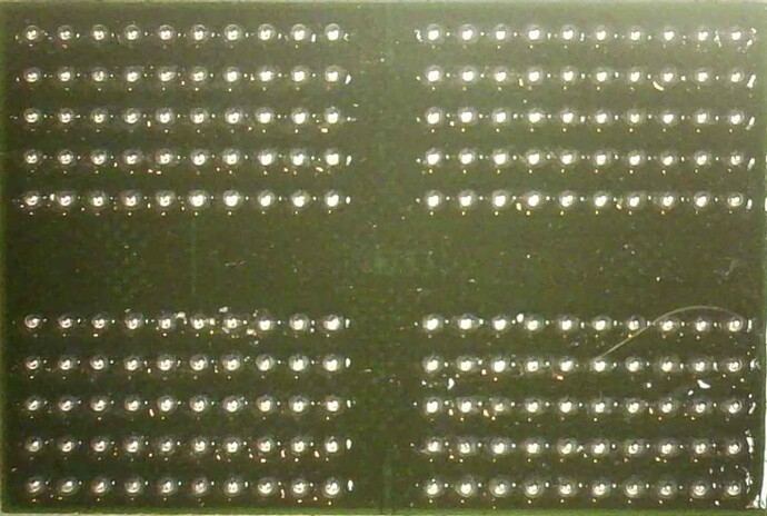

Blue Screen Switch - Injected BisKeyDump.Bin - Image below - SoC or Memory?
Any thoughts would be hugely appreciated.
your Ram faulty , my friend

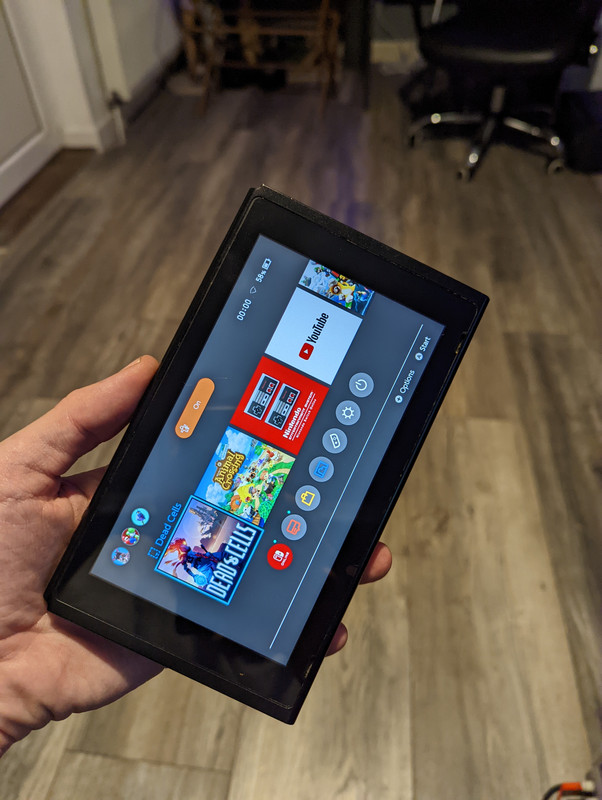

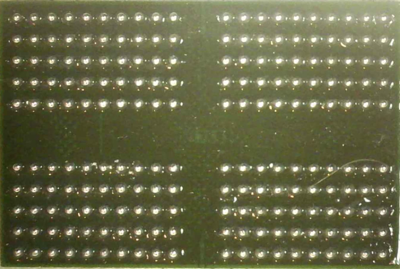

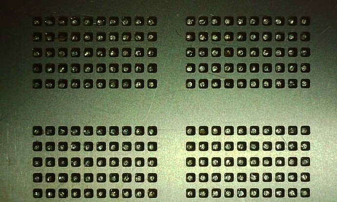

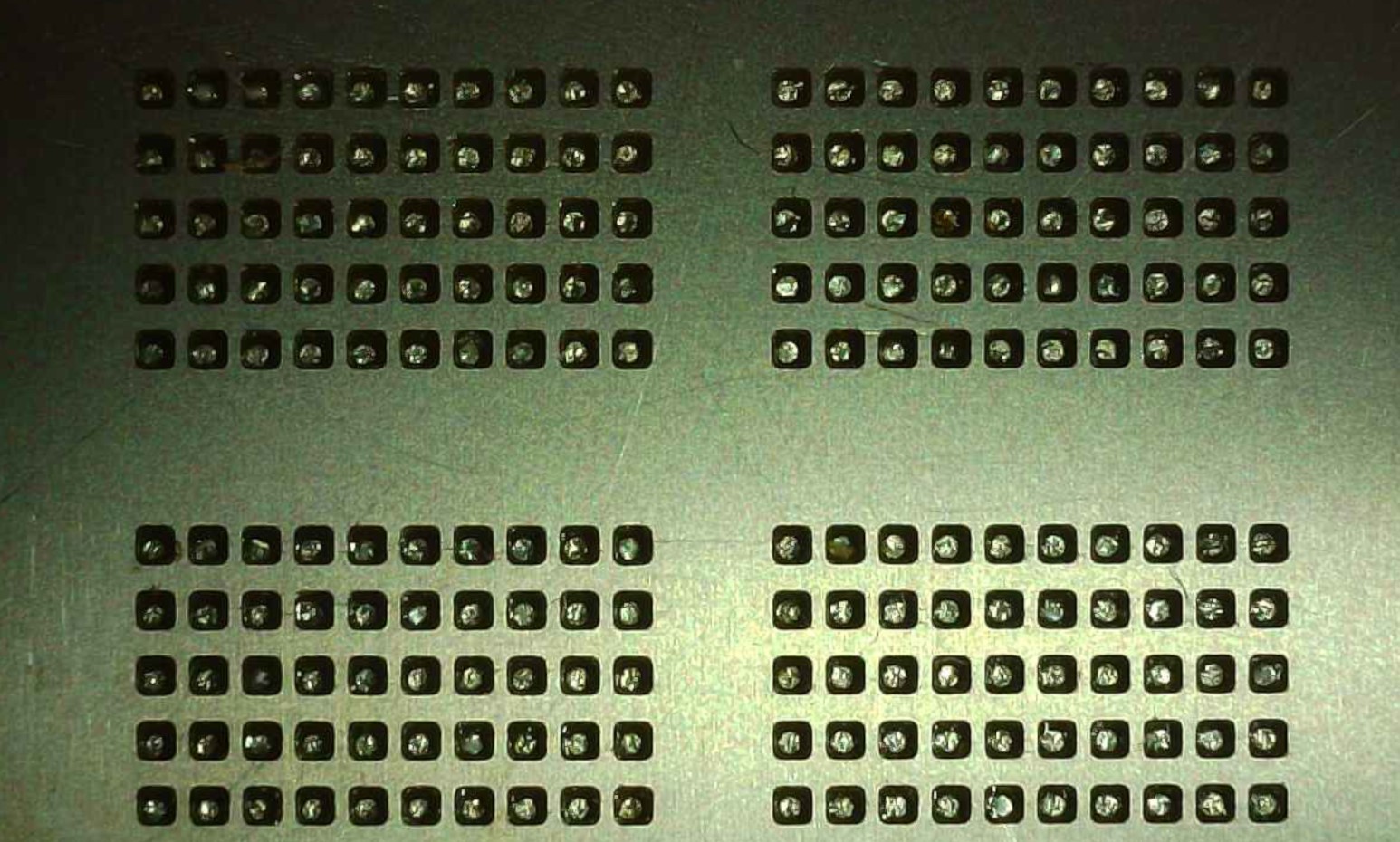

Well I fixed it…Stole a memory IC of the one I suspected was faulty from one of my donors…
Reballed it and put it on.
Success!
congratulations ,Ram issue only (memory ic )
Absolutely - It’s what I thought but wanted some confirmation from at least somebody else before pulling off memory IC’s. :smiley:

Nice, how did you reballed it?
Thanks!
