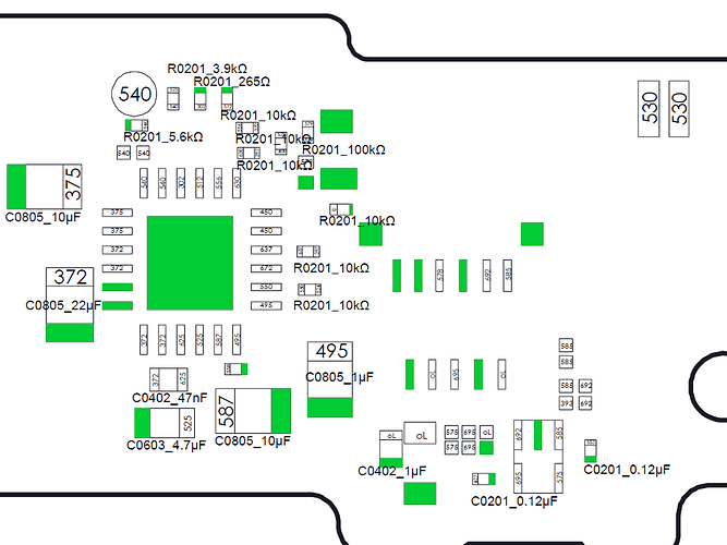

Hello, i have a switch (HAC- CPU 20) which has been brought to me with missing BQ24 chip, joycon connectors etc.

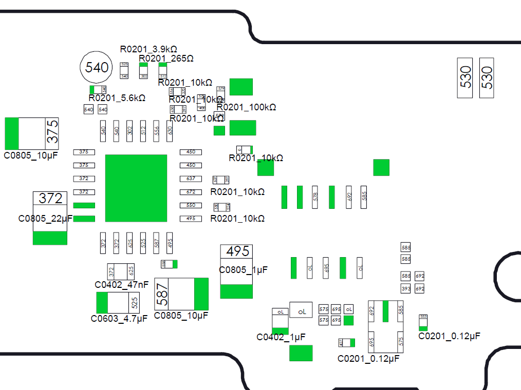

Replaced the BQ IC, replaced the connectors and got the switch to fully boot but some resistors around the BQ are missing. Does anyone have resistors value but pulled from the board? I found some on repair wiki but are in board measurements. Thanks!

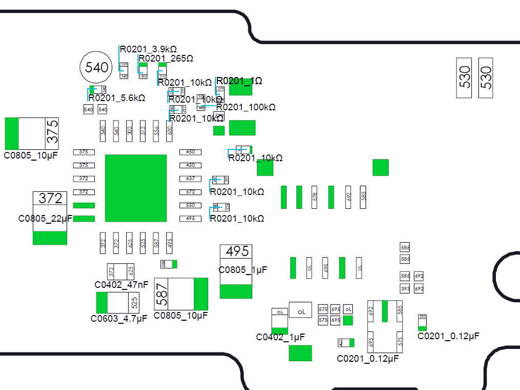

thanks for the reply. On the top side there are 8 resistors but only 7 values and i don’t understand well which value Is refering to which resistor… Thanks in advance
