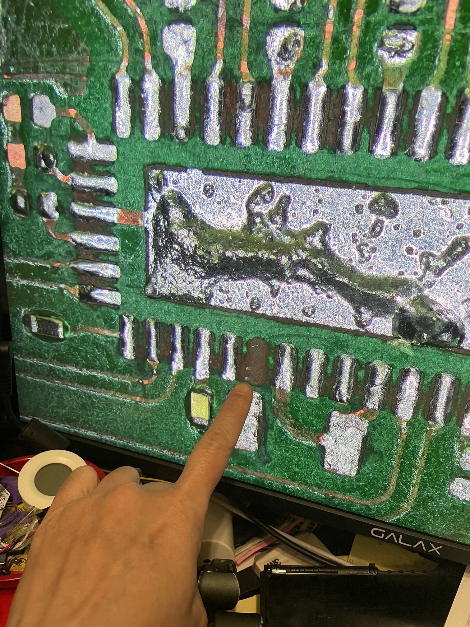

No worry, right?
The broken pin6 seems that it didn’t be used in my switch V1 as it didn’t route to anywhere else as shown in the photo. I checked with the P13USB data sheet that those pin called DP# (I assume all 4 pins 5,6,8&9 are working for display port feature).
Attached is the missing pin showing on the circuit board where the location of P13USB.
