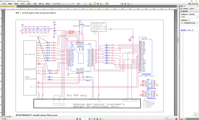

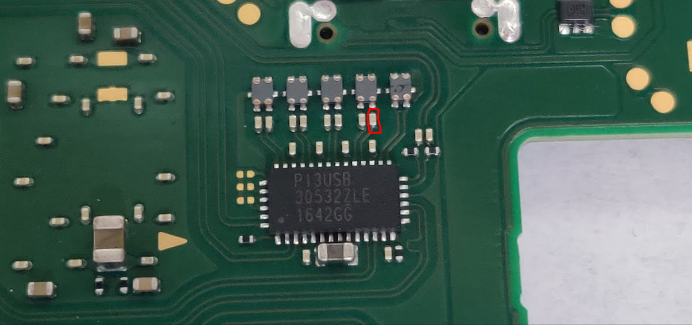

Hey guys, so I blew off a cap while replacing the P13 IC and I don’t have the tools to measure the capacitance of the neighboring caps so I’m relying on the internet for the answers. Online I’ve seen conflicting ratings, a 0201 rated at 0.12uF and 0201 at 100nF. Any answers are greatly appreciated so thank you in advance.
Thanks for the clarification! So a 0201 0.15nF 6.3V capacitor should be a proper replacement?
A proper replacement would be a 0.1 nF, as jkyoho mentioned. With 20% tolerance it could be 0.08 - 0.12 nF.
So this should be sufficient? https://www.mouser.com/ProductDetail/TDK/C0603JB1C154M030BC?qs=xLDY6iXSiQbpF4xlmBByKQ%3D%3D
Sorry I wrote the false value. 0.1 µF is correct: https://www.mouser.de/ProductDetail/TDK/C0603X6S0J104K030BC?qs=dfay7wIA1uE2lZsKTwi9vQ%3D%3D
Thank you guys so much! This shit was driving my crazy, I appreciate it a lot.
