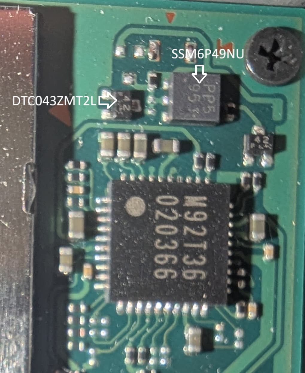

Thanks mate that’s nearly All, however i am also missing the two big boys more or less on the top (not capacitors idk how they are called rn), Do you have any Info on them too?
upload a picture and show where they were. Or post a link of the picture from imgur or anywhere in form of http:_//xxx(dot)com/xxx
Here i can Provide a picture of my broken Mainboard and a Working one
https:_//imgur.com/a/m19wxaX
the 6leg label PP5 chip is SSM6P49NU
3leg label 42 transistor ic is DTC043ZMT2L
