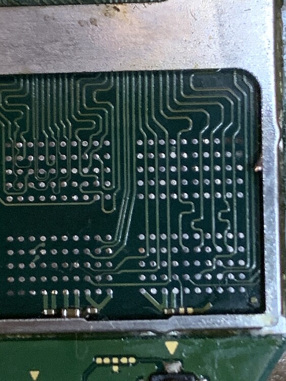

Can anybody tell me the capacitor value of the caps for the ram modules.
THX
big one measured 5.2uF guessing is 4.7uF
small one are all 0.1uF
thx u are my hero. can i grab this 2 on other place on swich board?
the small on are 0201
and the big 0603?
big one 0402 i believe.
and yes you can take them from another board as long as from same location
do u know other locations on the board? on my second board the same are missing

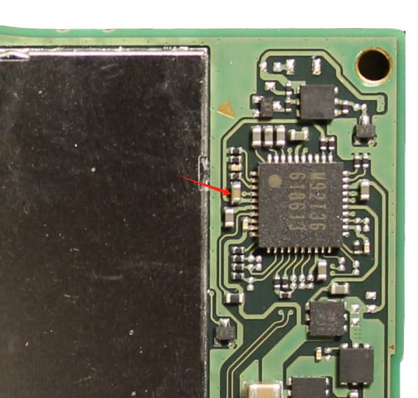

this cap on pin5 of m92t should be same 4.7uF_0402 size

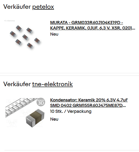

ok and for the 100nf
is this ok so?
