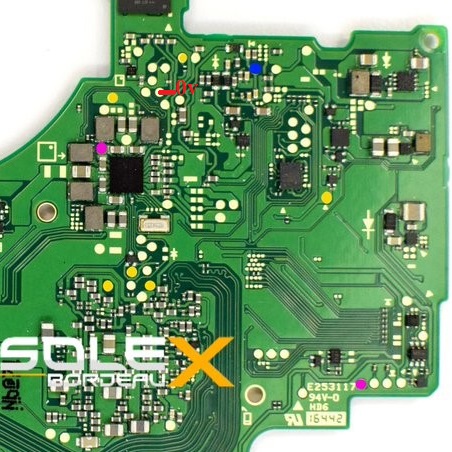

Hallo forum,
I have an issue where pin 35 of M92T is shorted to ground and CC1 too. I removed the 6pin filters from the front and the backside of the board but the short is still there.
I replaced M92T , the short was gone but no 15V charging at all. Its because of CC1 short I believe. After a while though pin 35 shorted again.
Also from the backside of the board I get 0V diode measurement to this pad:
Switch is working though.
Any ideas?
