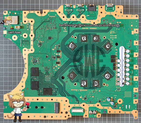

Well, I have a question: could someone confirm the location of each RAM on an edm033?
Because I have a problem, I’ve changed it four times and I always get the same error message. To be sure that the installed RAM works, I took the 6th RAM and put it in place of the 5th RAM, and vice versa. And the error message is still the same! So, I have two solutions: either I don’t change the right RAM, or the problem comes from somewhere else.
Thanks in advance for your answers.
[*] Operation: Run Read Error Codes
[Slot #] [Date Time] [Error Code] [Priority] [Error Message]
00 21/09/2025 01:26:23 80801110 Severe RAM GDDR6 (Bank 5) - Single Beep, 1 second blue light, off.
