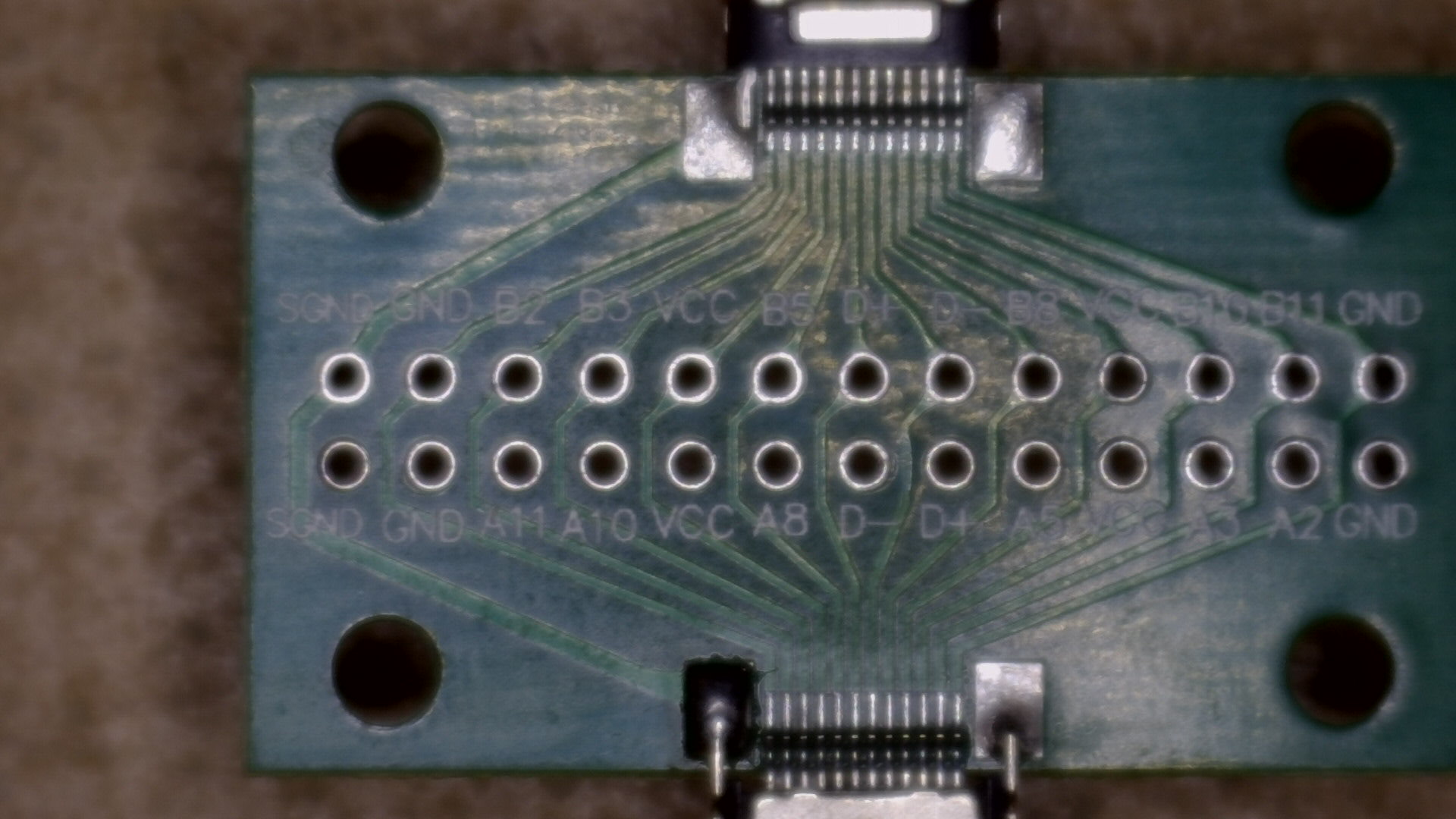

an open line most likely, you can check continuity using a USB breakout board and check points to destinations to see. If you find it is an open line then it would indicate your soldering of the USB is not good or pads were damaged and you should look into pulling the USB port and trying again after verifcation ![]()
Thanks for your precious help.
I already tested all continuity and diode values with this USB breadboard, using this schematic, everything is fine and there is also no short between all the pins.
When i say test continuity to the destinations, i just want to clarify that I don’t mean just to the back of the USB pins (or TP) but rather, to the actual IC destinations (where possible) ie. M92 IC, P13 IC, diodes, etc just to ensure you don’t have a break in the trace or open vias (usually caused by layer delamination due to over rework of said IC;s) . Did you do this?
