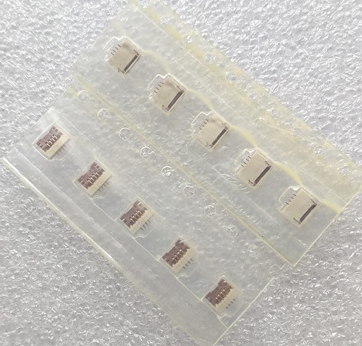

US $4.88 | 2–100PCS/LOT for Nintendo NS Switch 4pin Fan ZIF FPC Contact Connector on Mainboard
Need a hot air station to replace. Or you could try to take the tab off a new one and fit onto the existing one
