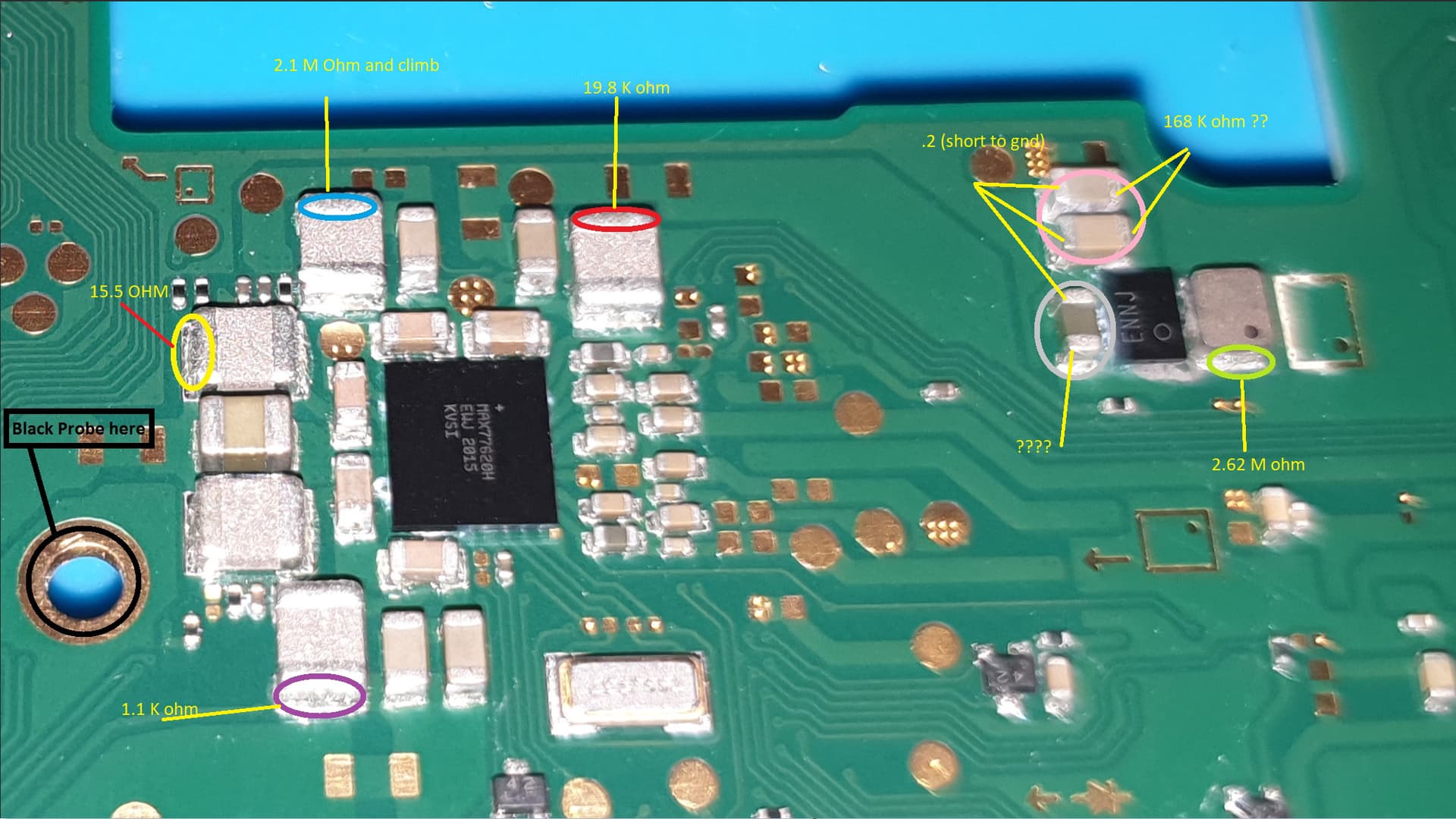

been doing a ton of reading and found a lot of helpful posts from @severance So i decided to go and test the stuff around the other PMIC’s using his diagram as an example.
On the blue marked cap, it starts around 2.1-2.2 Mohm but keeps climbing and doesnt seem to settle.
On the red marked cap, it ranges around a lot before finally settling around 19 Kohm.
On the pink marked caps it ranges around from 1 Mohm to 100 Kohm, then climbs up to the 167-168 Kohm range. It still noodles around by .1 every few seconds and doesnt ever seem to completely stabilize.
On the gray marked cap (with ???) i never get a solid reading. It jumps from Mohms to ohm to OL and back again, just absolutely nothing solid here
