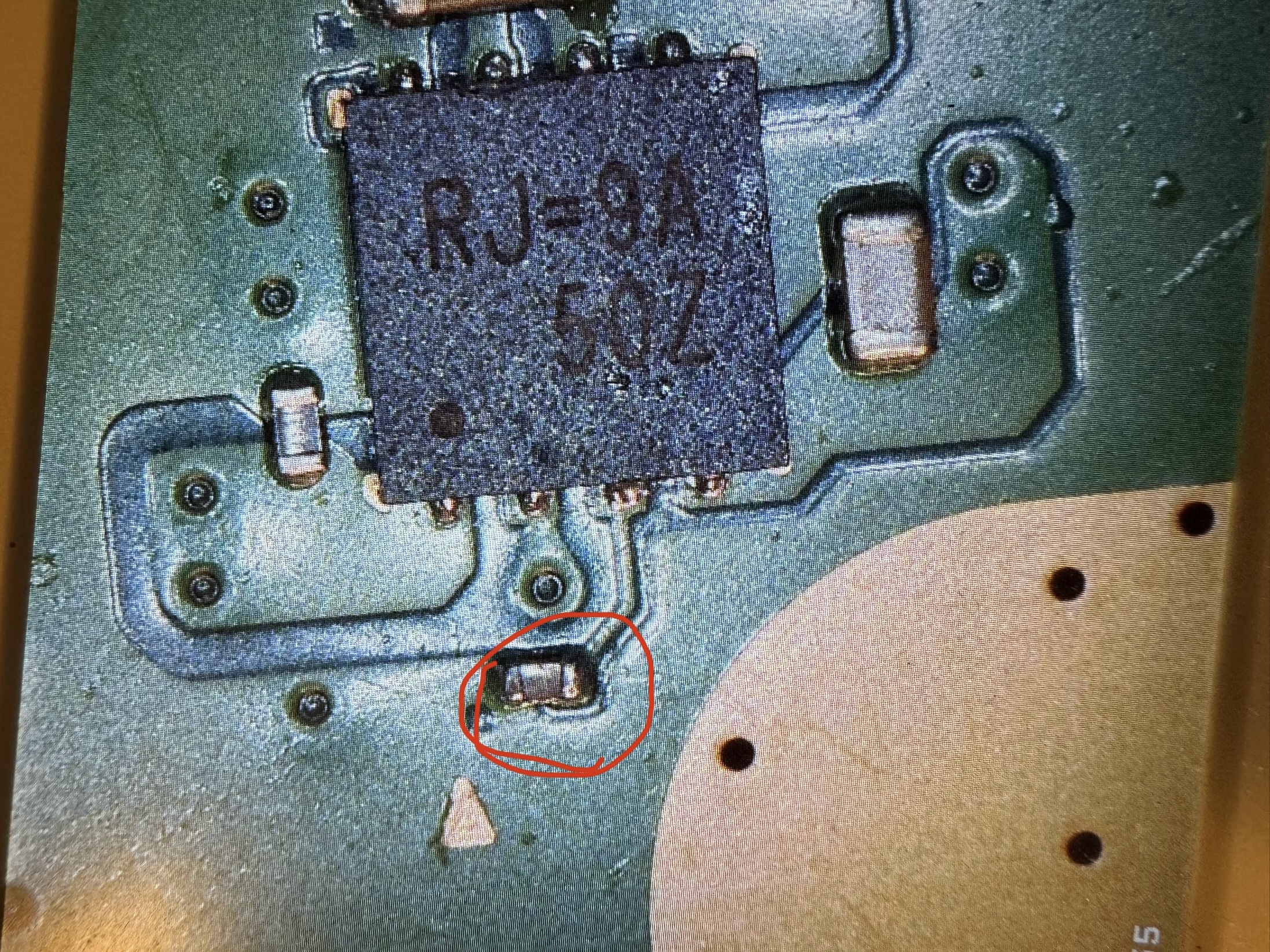

Hello, can anyone please help with the identification of this encircled in red component and its value. It sits next to the RJ=9A which itself is next to the HDMI encoder IC. Looks like a capacitor but not sure.

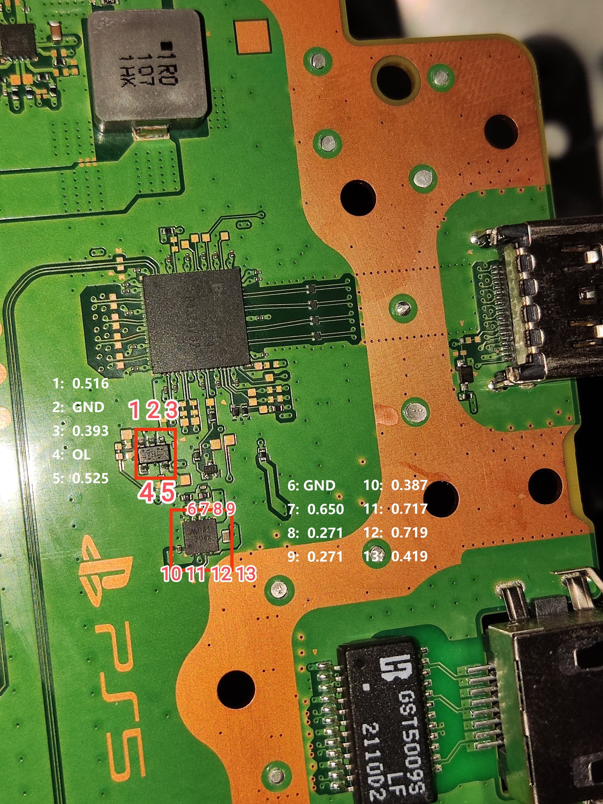

For reference, this is another picture zoomed out and in this picture, the component in question connects to Pin 12 of RJ=9A IC.
The marking “RJ=xx” referes to RT9048A. Pin in question is pin 3 on this chip. The cap on this line is a 0201 22nF 10V X5R.
This pin at the RT9048A is an iternal n.c… so it shouldn’t matter if it the cap is present. Only at the alternativ chip with marking “504X” the connection on pin 3 is relevant.
