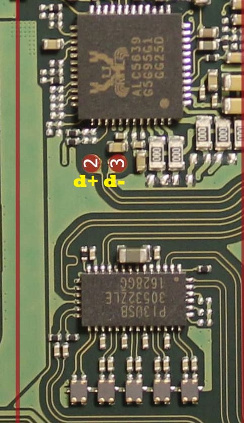

I’ve got an unpatched switch, came to me with a damaged port and M92. It fast and slow chargers, it docks ok but my PC doesn’t see it, neither does the RCMloader. It doesn’t have the 6 pin ESD components fitted and the choke on the top side to the left of the capacitor reads fine. Is there any other components that could have gone OL or is the SoC damaged?
Thanks
