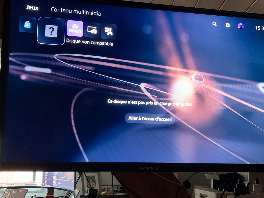

Good morning
I have a problem with a PS5. I updated it, but every time I put a disk in it tells me “disk not compatible”
I changed the ribbon and the read head, checked the fuses, everything seems ok. Anyone have an idea of the problem?
thanks in advance.

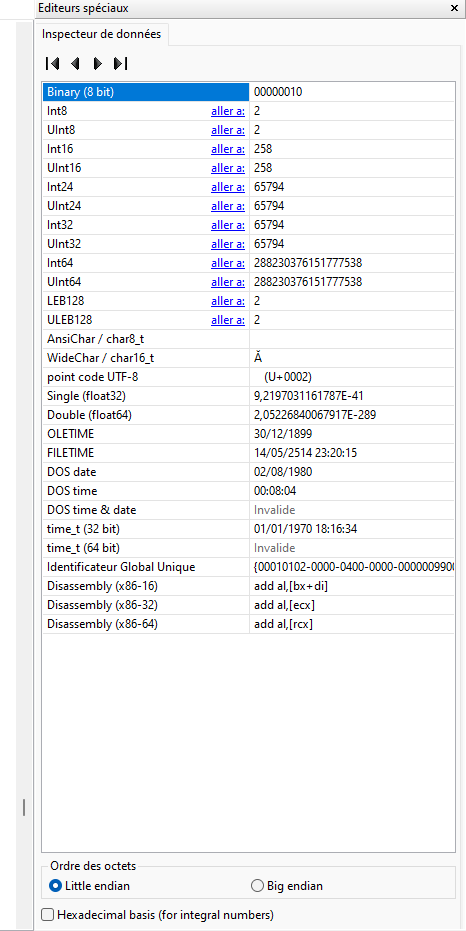

Would be interesting to know, if the NOR has the disc drive Bit set.
thank you calvin but how do I know? I have what I need to read it, but nothing to compare and I don’t know which line to look at. If I change with another NOR, from an identical console should it work?
THANKS
If you open the NOR dump in a hex editor and jump to adress 0x001C7011 there should be a 02 (BD) or 03 (digital).
001C7000: 01 00 00 00 00 00 00 00 01 00 00 00 00 00 00 00
001C7010: 22 02 01 01 00 00 00 00 04 00 00 00 00 00 99 00
001C7020: 00 04 44 00 00 00 00 00 00 00 00 00 00 00 00 00
001C7030: 00 00 00 07 07 07 07 00 89 00 01 00 00 00 00 00
hello calvin
Well I looked at my NOR and I have a 2 :(. I’m going to save it and try to delete it then rewrite it. If it’s still the same, I can try with another NOR that works and see if it works? Thanks
If there is a ‘02’ at 001C7011 the NOR is correct configed as disc version.
And it shouldn’t help, if another NOR dump is written back.
I was just curious. If there have been a ‘03’ it would indicate that the disc drive had been changed and explained why the disc drive is not playing games but the update was going through without problems.

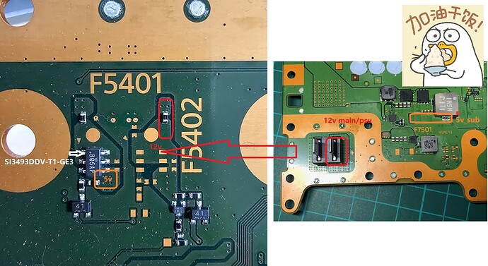

ok I just read another post on the problem su-101312-8 that there were 2 voltages on the 4-pin connector: 12v and 5v. If I understood correctly, if the 5 v is not there it could be that this causes this error? For power supply or not this does not pose a problem, it seems to me that the information only passes through this ribbon cable on the other connector. so I ask myself questions. Could someone tell me where this 5v comes from?
THANKS
before the f5401 fuse of course, because on several cards I don’t have it!
F5401 5v source from F7501 area 1R5 inductor (5v_sub), and it is controlled by “BQxxx” (Si3493DDV) P-channel mosfet to turn on or not.
great thank you very much jkyoho.
I’m going to look at it this evening, indeed I have 12v input at the f7501, but nothing on the 1r5. It seems to me that there are 2 mosfets before the 1r5 probably they are messing up. If anyone has the ref I’m interested ![]()
THANKS
5v_sub from 1R5 only present when console turns on. Not sure if you test it with extension cable or just bench supply 12v at initial stage.
ok if I understand correctly, the 5v is only present when the console is turned on. But is it always present or only in certain cases? For example only when you insert a CD? If this is the case why some readers work and others don’t. I’m going to do some tests this evening and try to understand this 5v.
