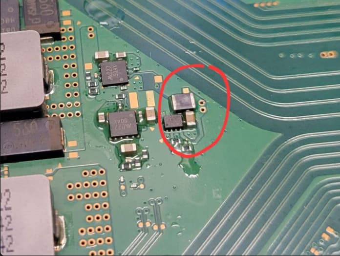

Hi All,
I have a short on this circuit on the back of the PS5 motherboard (on the vias), but not sure what this circuit powers. Have tried injecting voltage but nothing heats up. Any pointers will be appreciated.

Your best bet is a thermal cam or see where the short goes and remove caps one by one till the short is gone but make sure and replace them as you take them out the one that you take out where the circuit is no longer shorted is the bad cap
Were you able to locate where the circuit connects to for this area?
