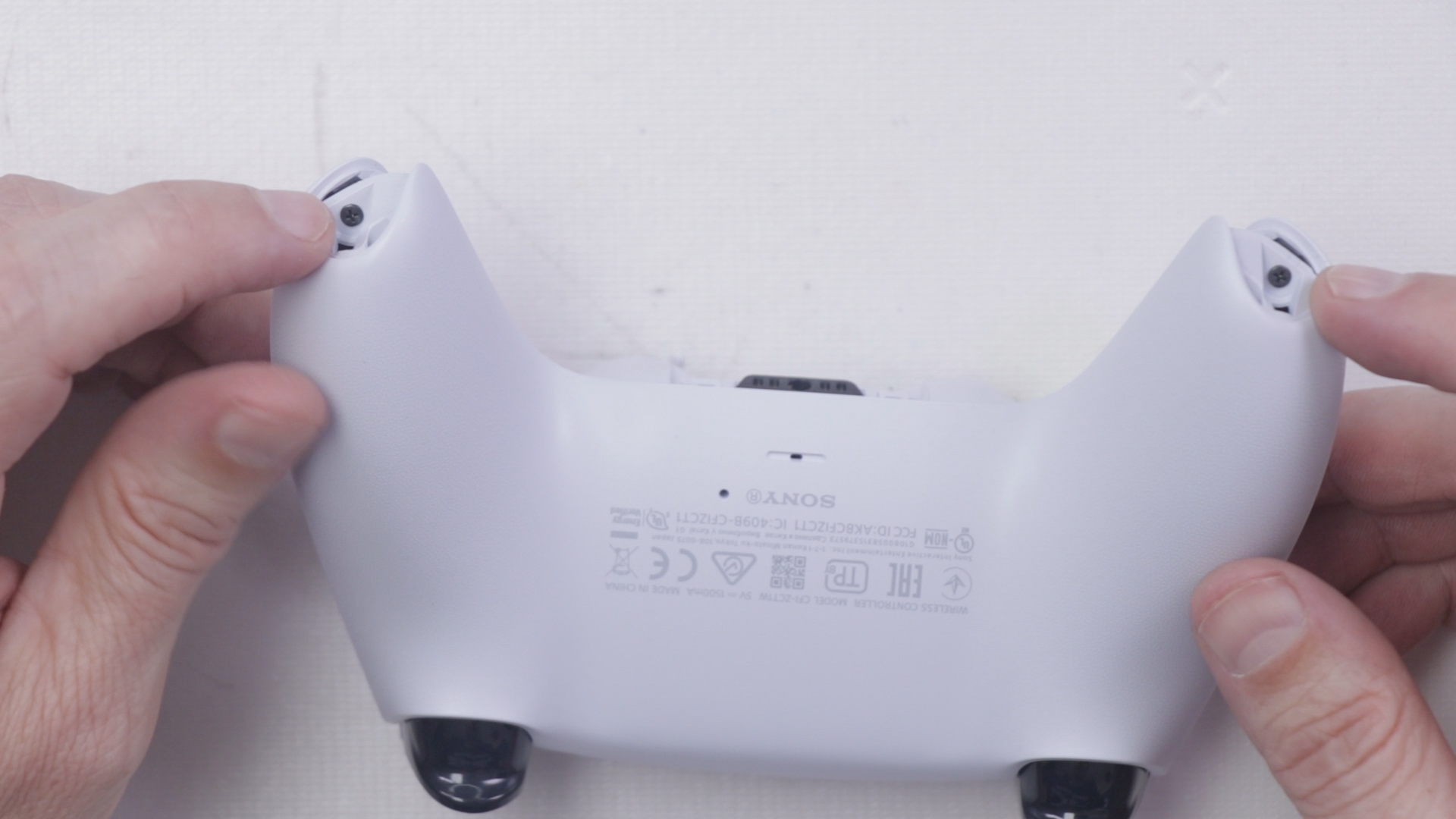

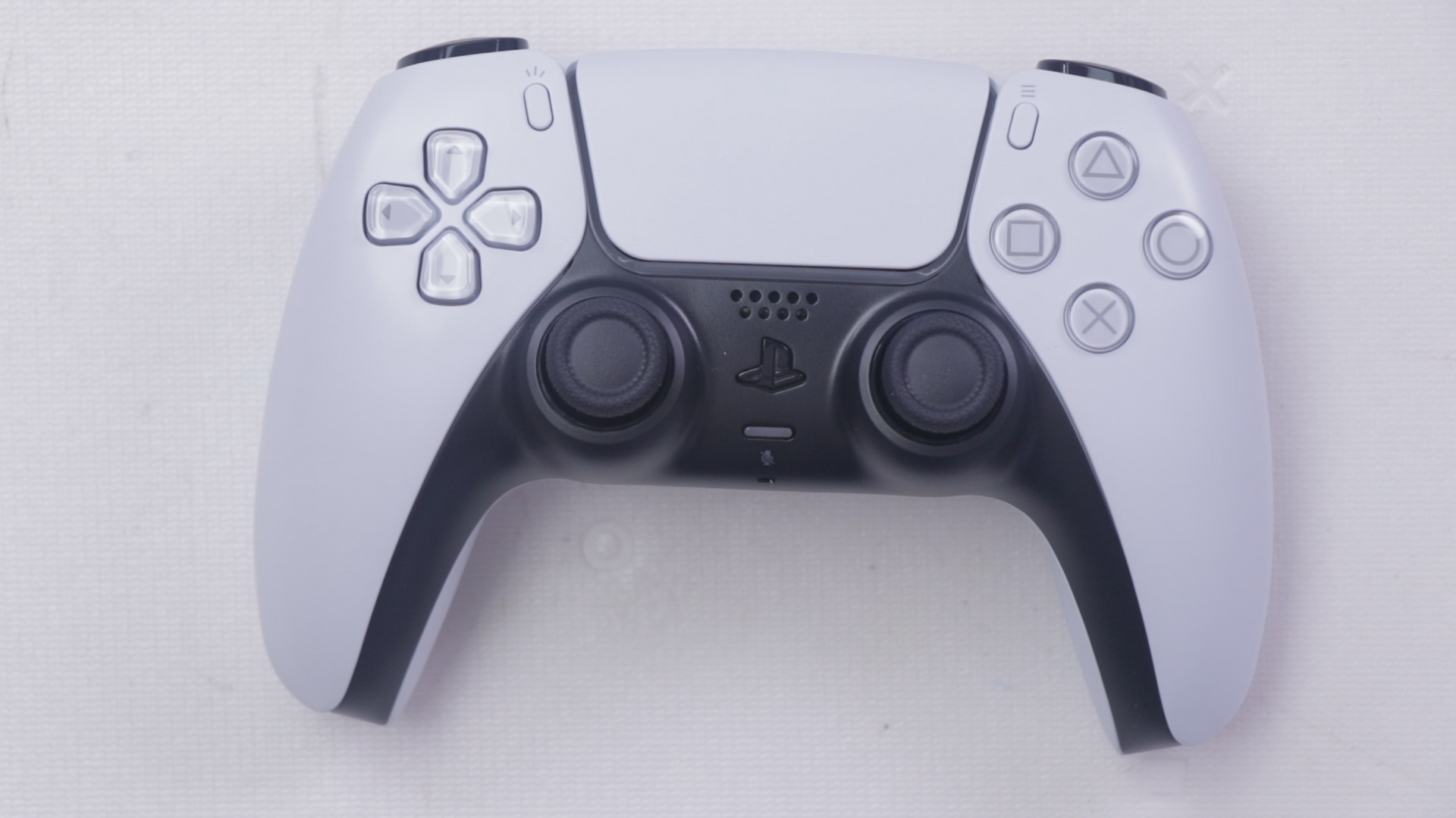

Dualsense
1920×1080 405 KB

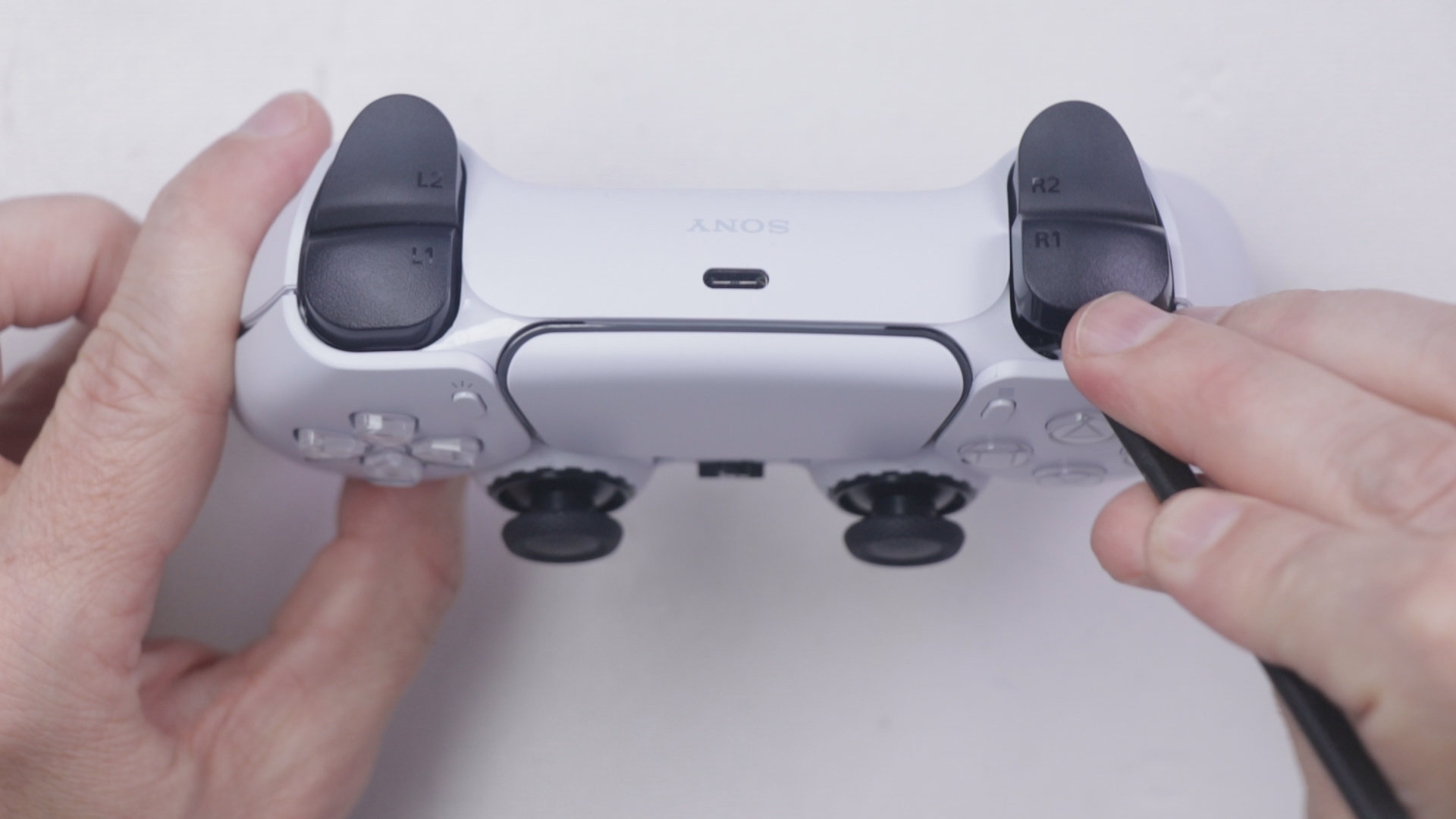

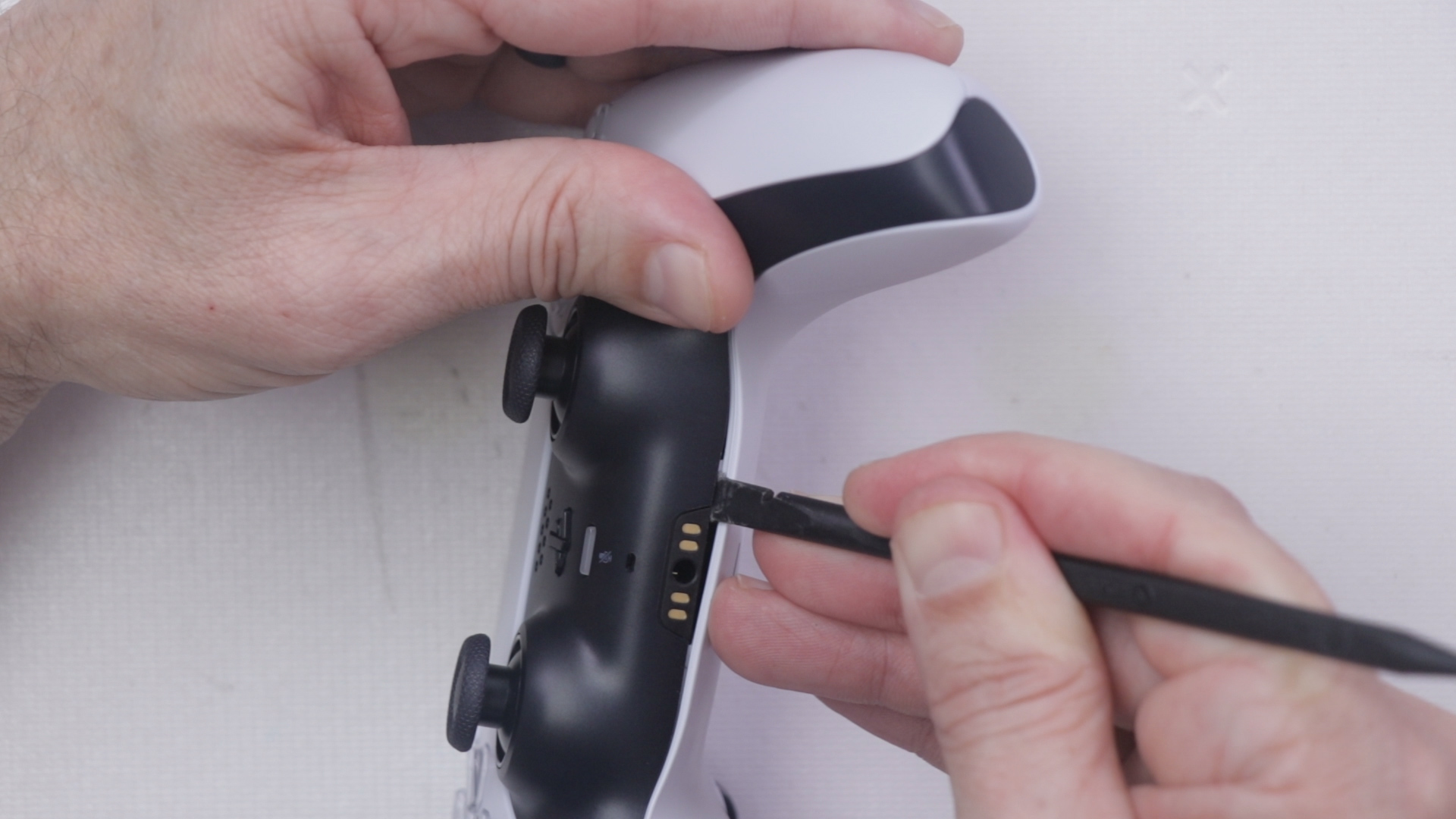

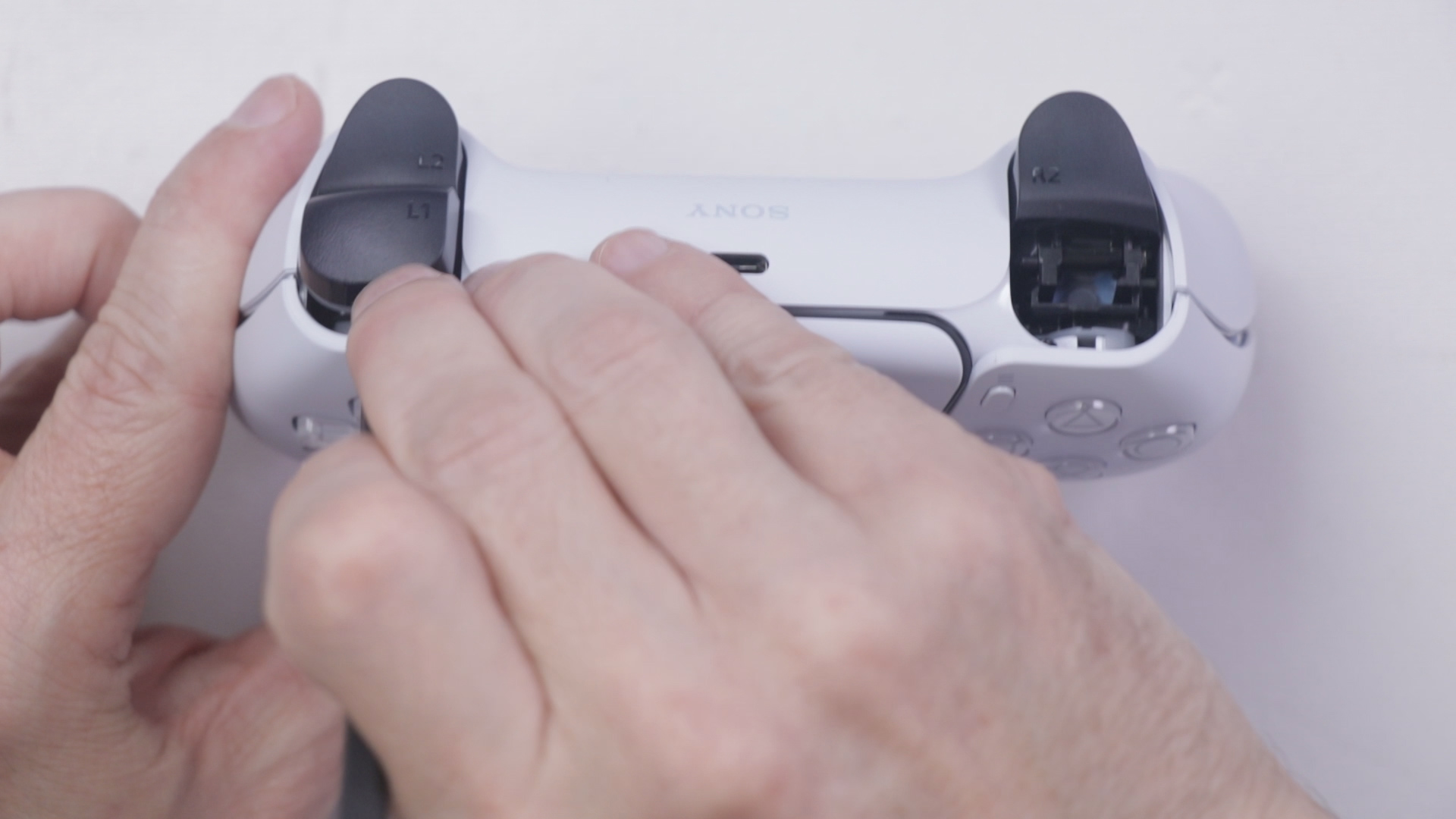

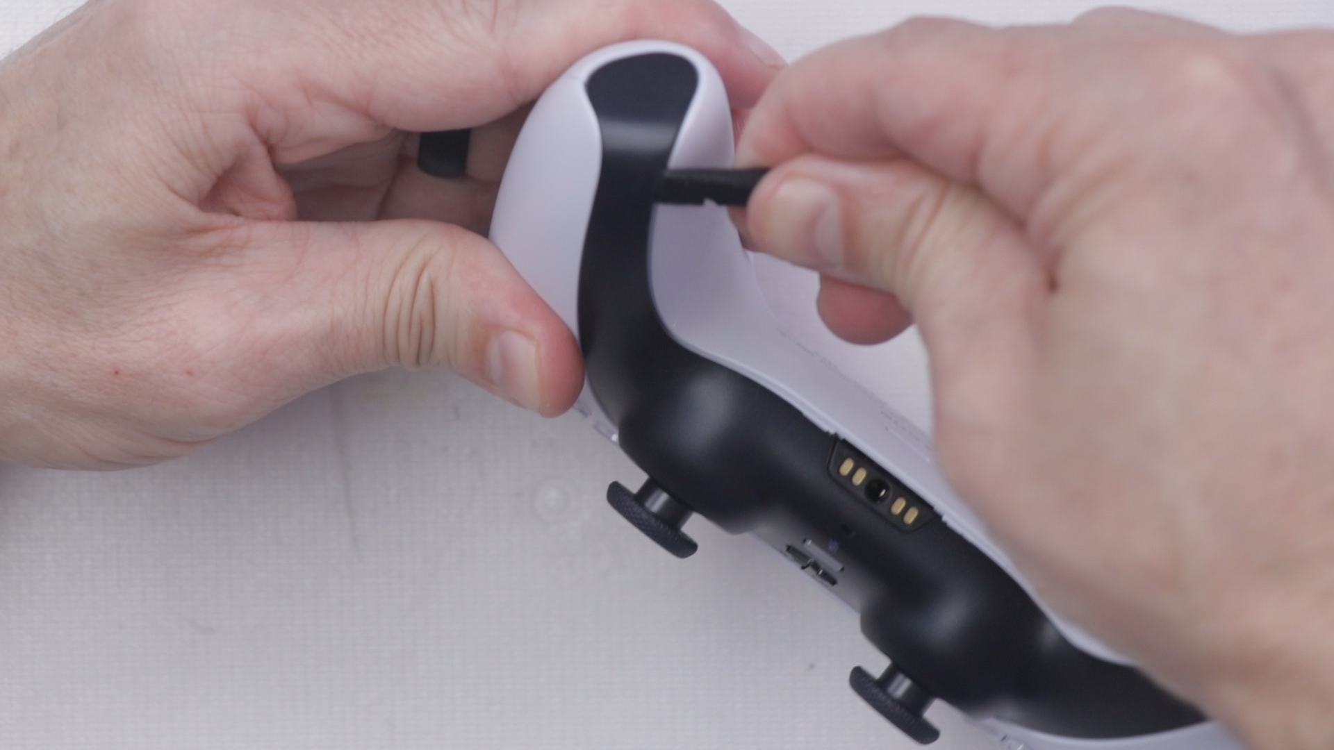

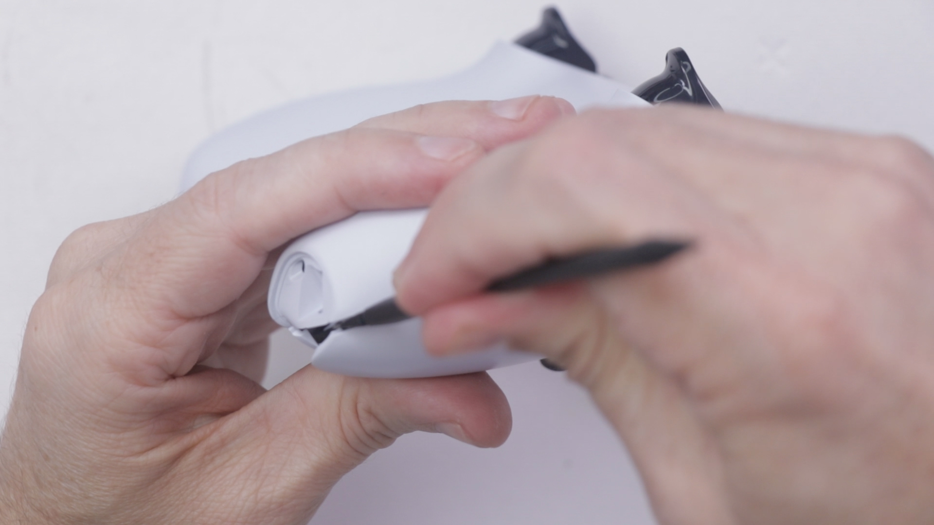

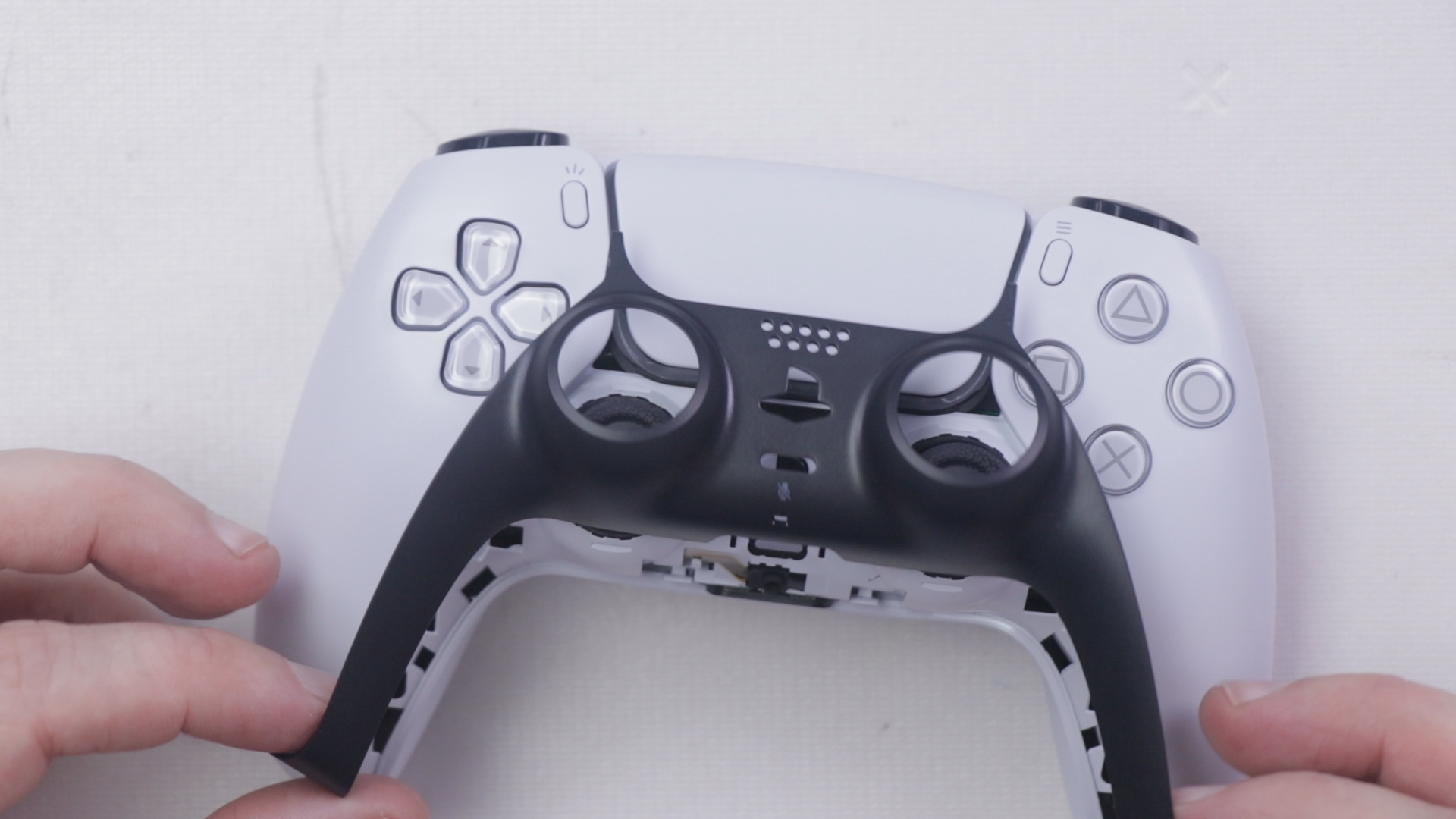

Step 1
1920×1080 465 KB
Step 1-2
1920×1080 422 KB
Step 1-3
1920×1080 412 KB
Step 2
1920×1080 388 KB
Step 2-1
1920×1080 354 KB
Step 3
1920×1080 365 KB
Step 3-1
1920×1080 323 KB
Step 4
1920×1080 409 KB
Step 4-1
1920×1080 413 KB
Step 5
1920×1080 450 KB
Step 6
1920×1080 479 KB

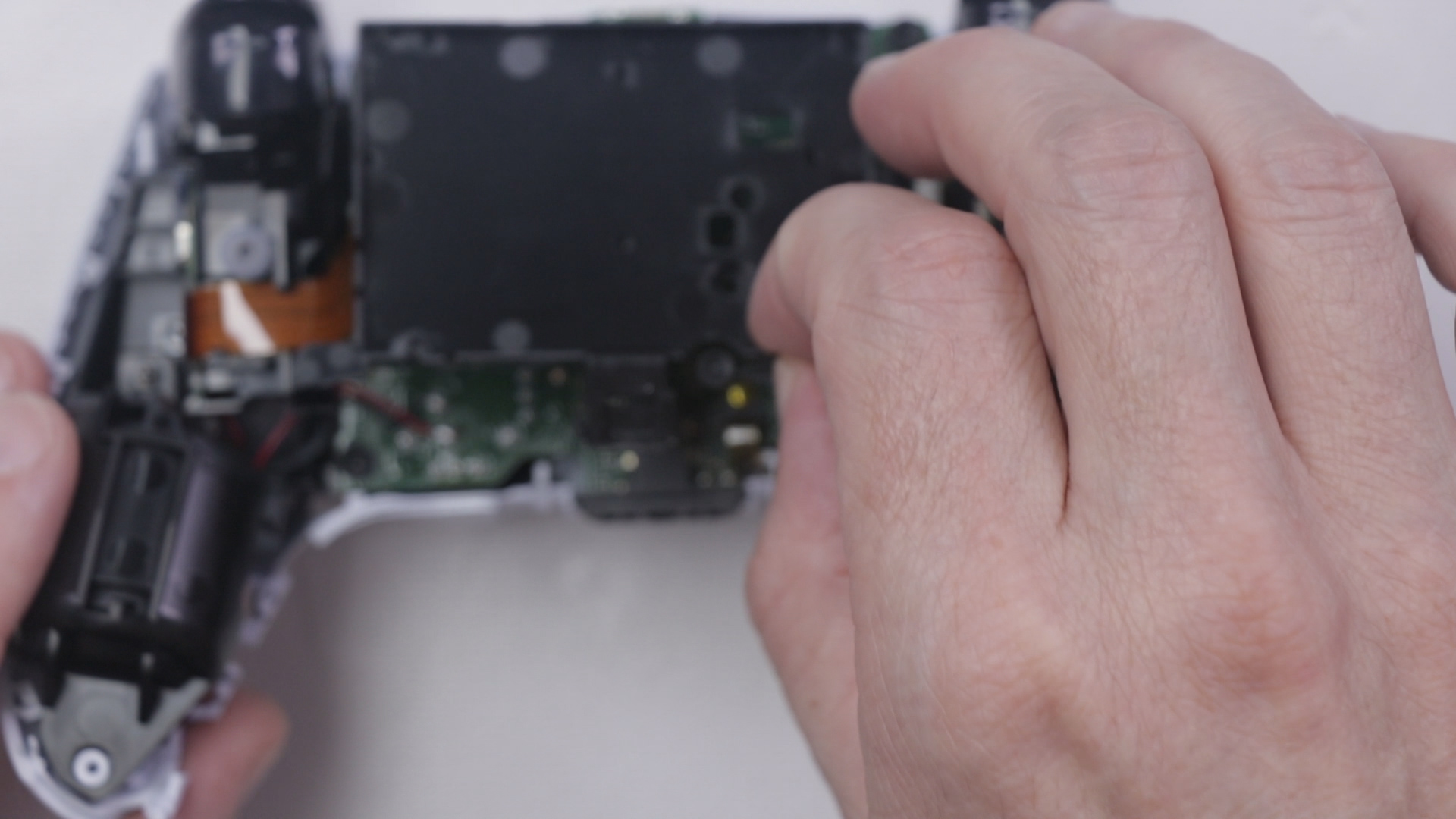

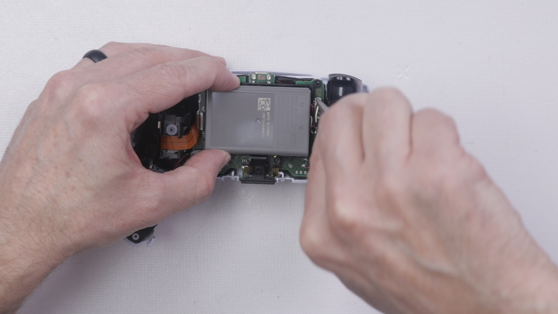

Step 8 - Remove 1 Screw - Remove Batt Tray
1920×1080 441 KB

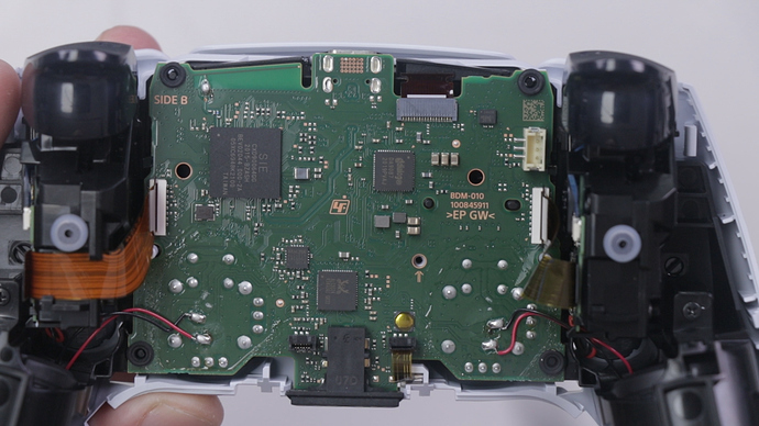

Step 9 - Remove Ribbon Cables
1920×1080 638 KB

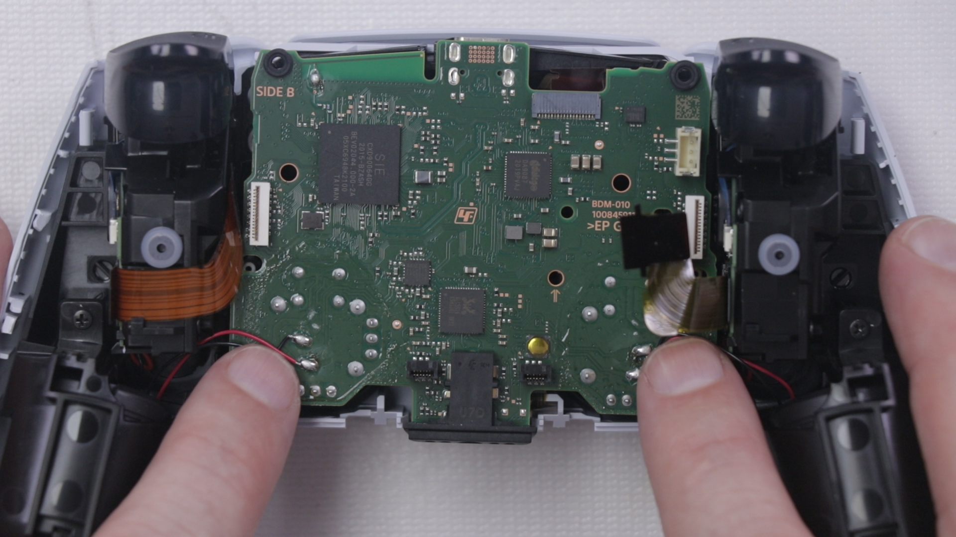

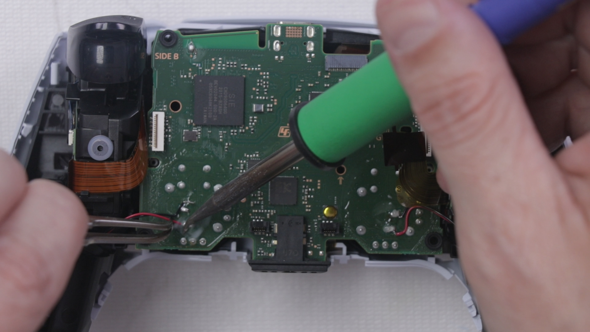

Step 10 - 1 Desoldering Wires
1920×1080 513 KB

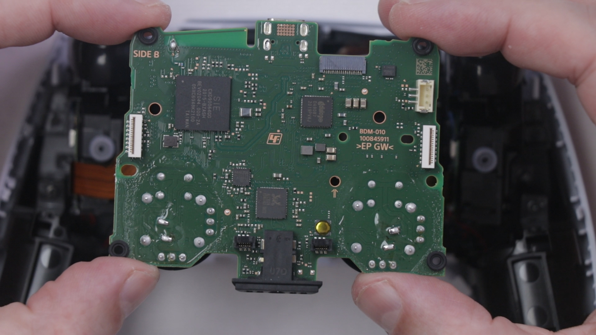

Step 10 - 2 Remove Motherboard
1920×1080 594 KB

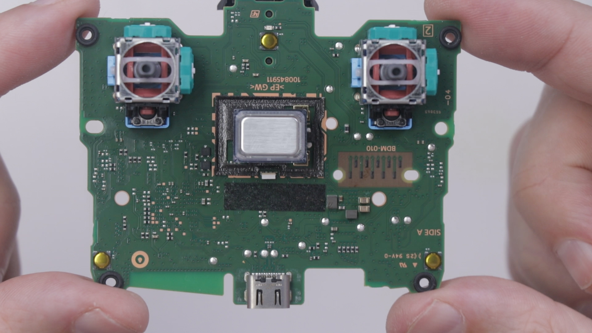

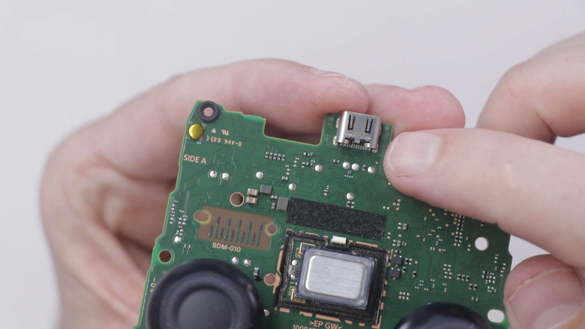

Step 10 - 3 Motherboard USBC Port
1920×1080 470 KB

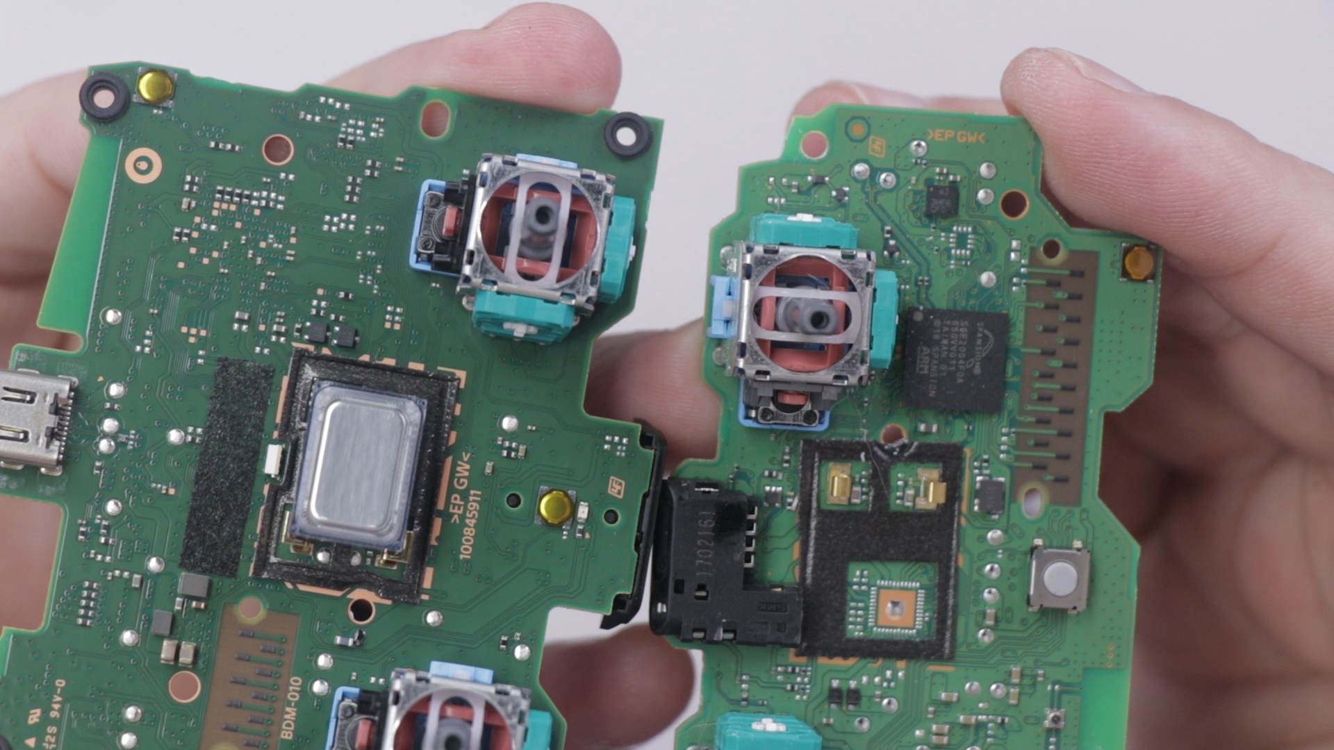

Step 10 - 4 DS4 Motherboard Comparison
1920×1080 681 KB
Step 10 - 5 Motherboard Topside
1920×1080 513 KB
Step 10 - Desolder Wires
1920×1080 623 KB

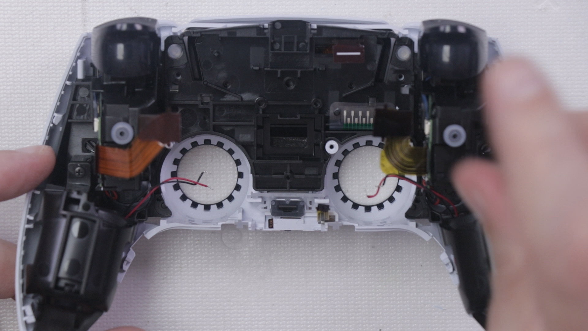

Step 11 - 1 Remove White Piece and Clear Piece
1920×1080 516 KB
Step 11 - 2 Remove Two Black Screws
1920×1080 531 KB
Step 11 - 3 - Remove Black Midframe
1920×1080 480 KB
Step 11 - Remove 2 Silver Screws
1920×1080 536 KB

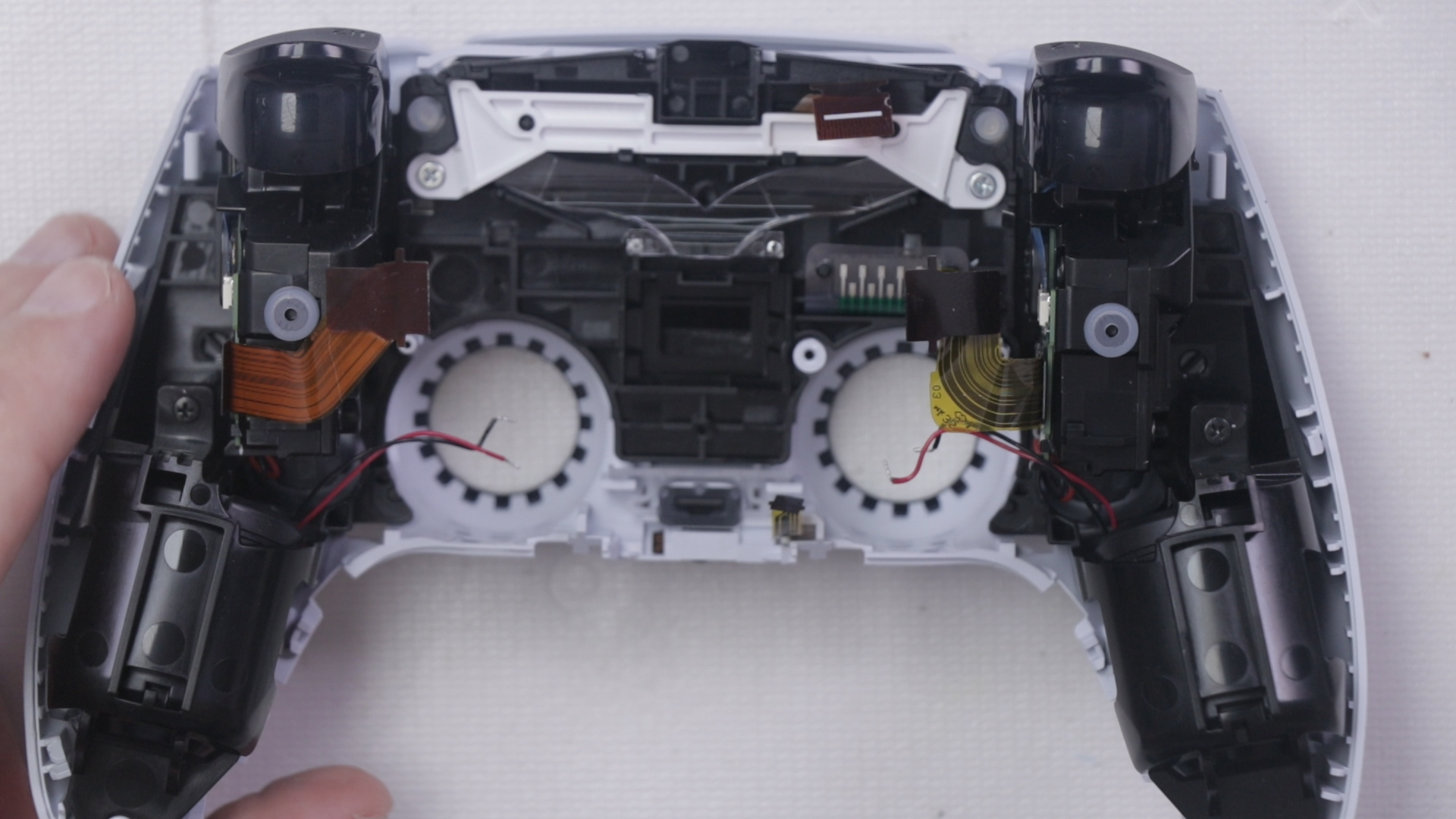

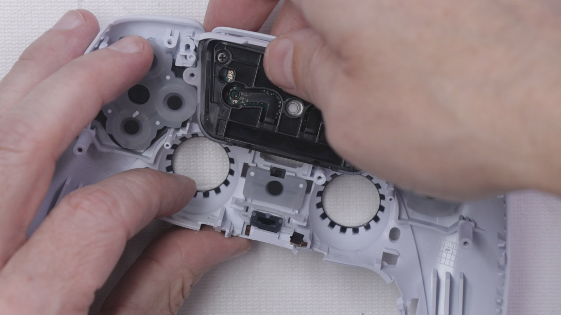

Step 12 - Push Up on Back of Touch Pad to Remove it
1920×1080 461 KB

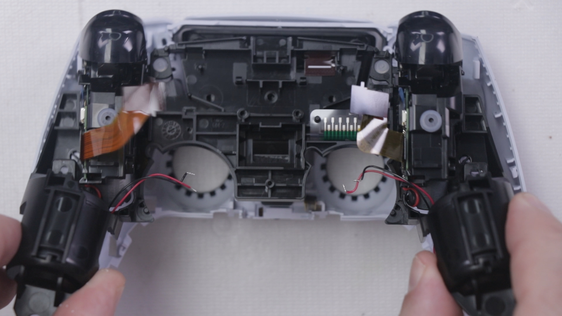

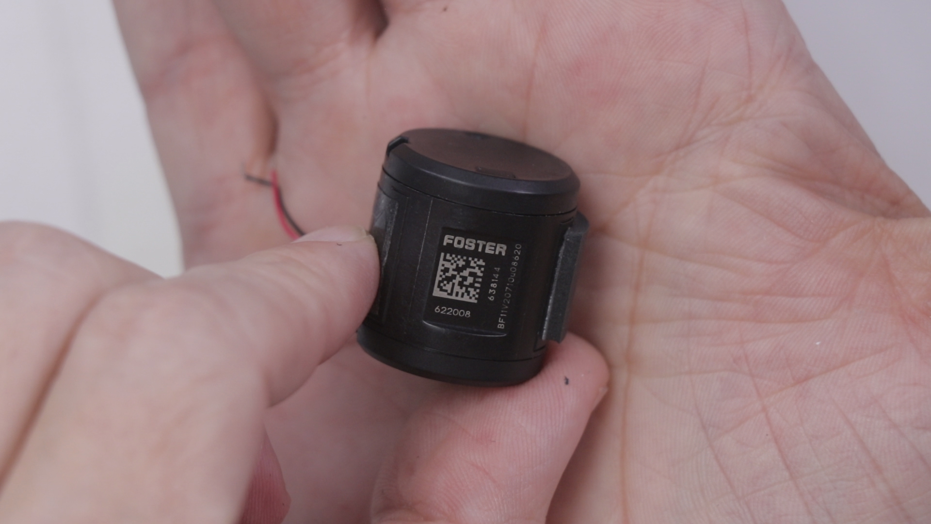

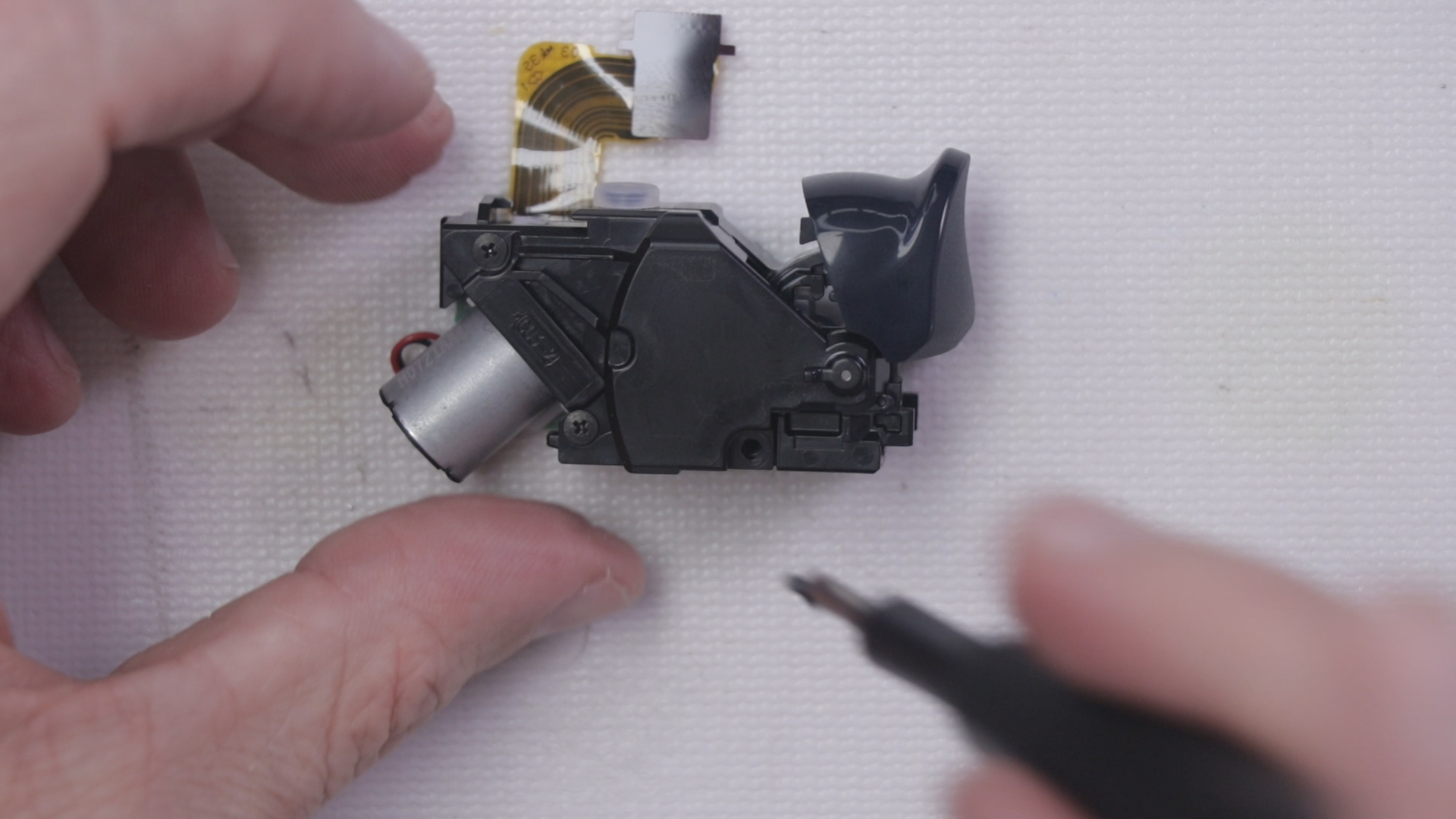

Step 13 - 1 Foster Haptic Motor
1920×1080 456 KB

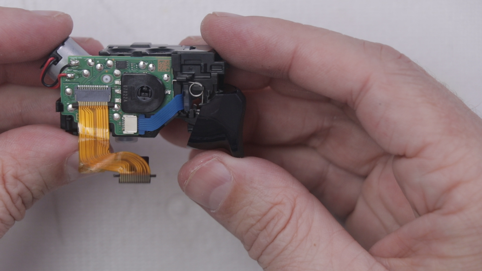

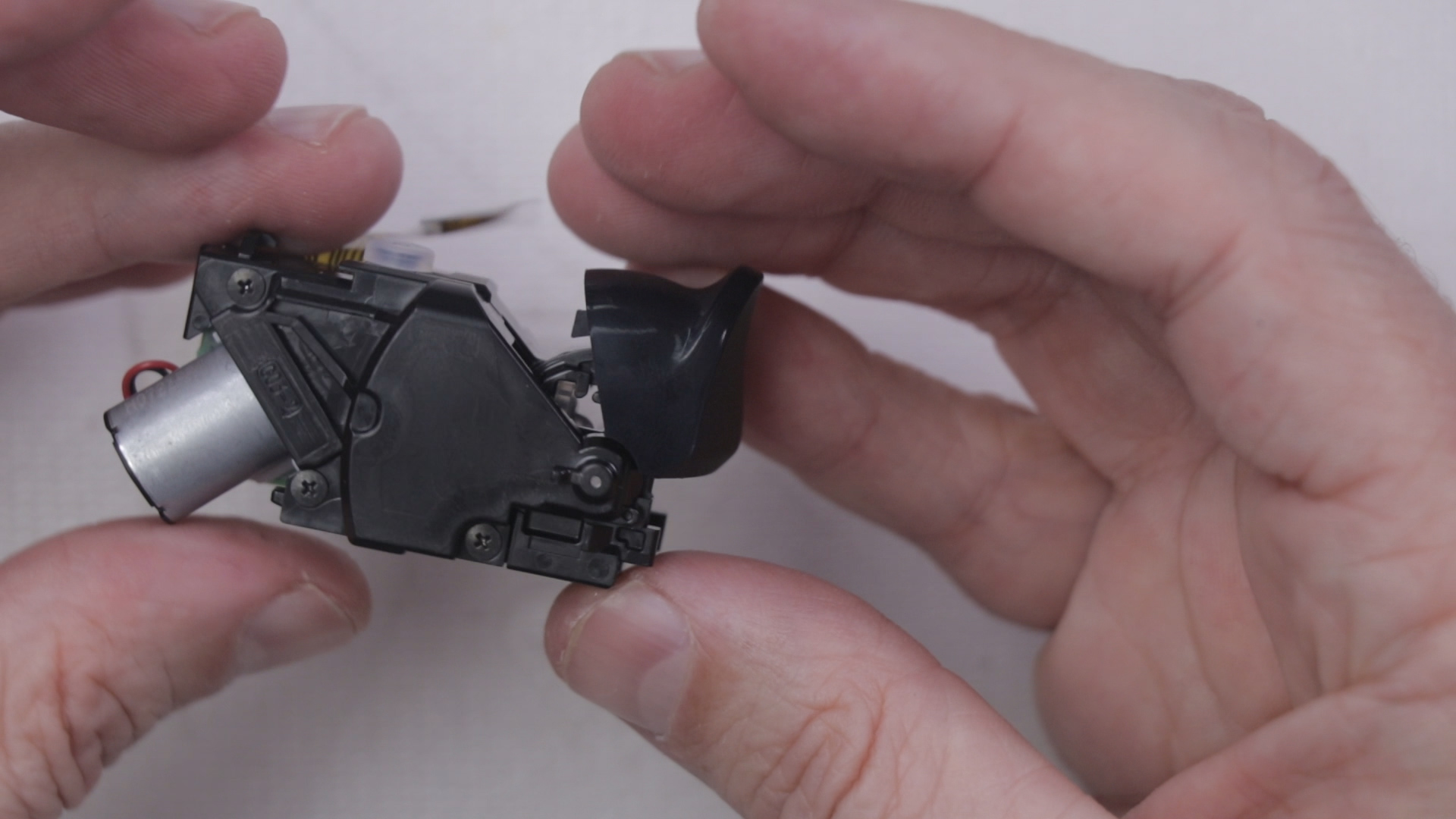

Step 13 - 2 Adaptive Trigger Side 1
1920×1080 501 KB
Step 13 - 3 Adaptive Trigger Side 2
1920×1080 414 KB

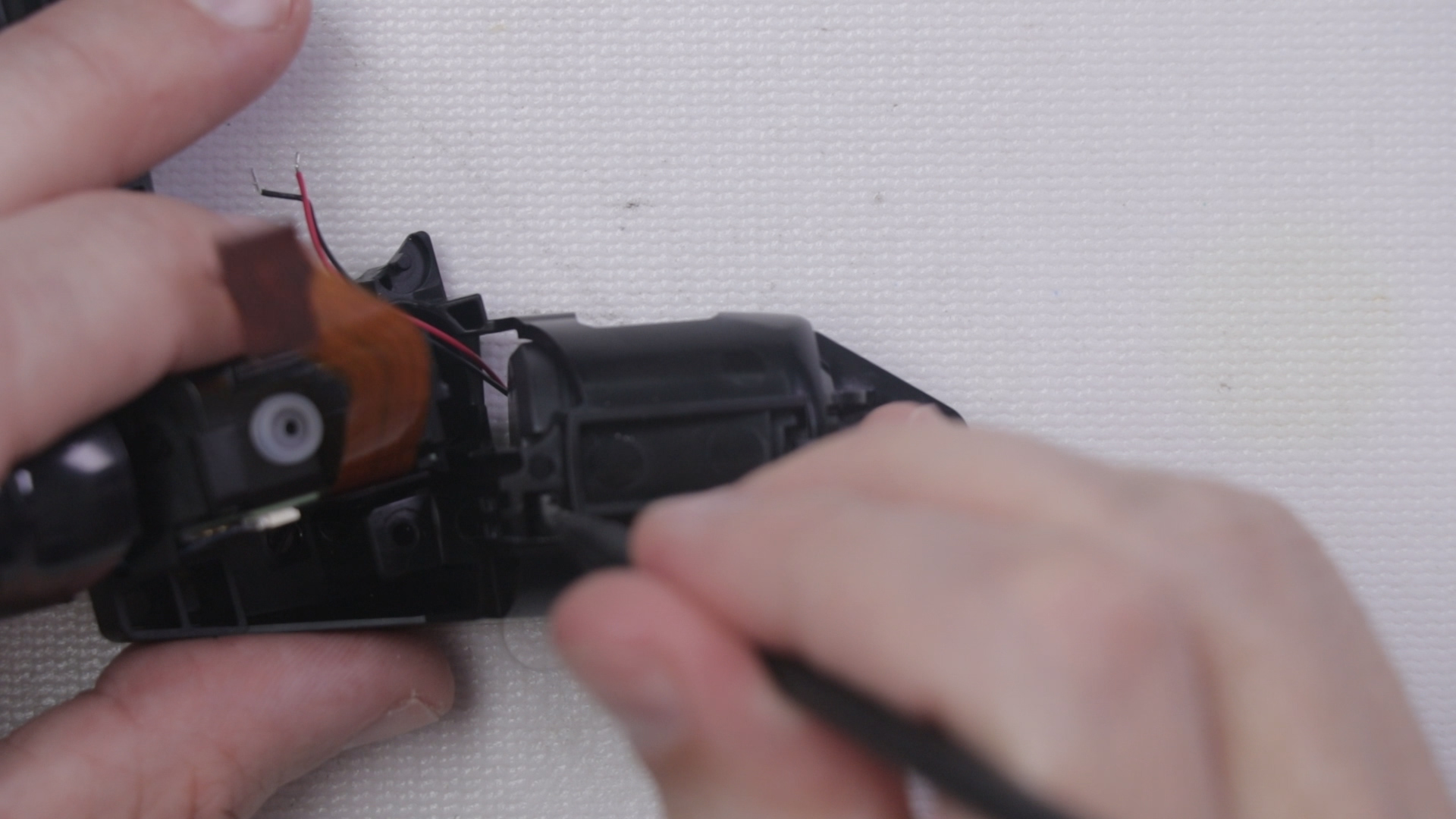

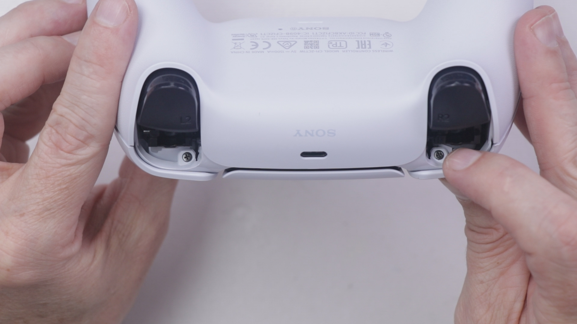

Step 13 - 4 Remove 4 Screws - 3 on one side 1 on the other
1920×1080 445 KB
Step 13 - 5 Inside of Adaptive Trigger
1920×1080 470 KB
Step 13 - 5 One Screw on the other side
1920×1080 465 KB
Step 13 - Push Down on Haptic Motor to Remove
1920×1080 457 KB

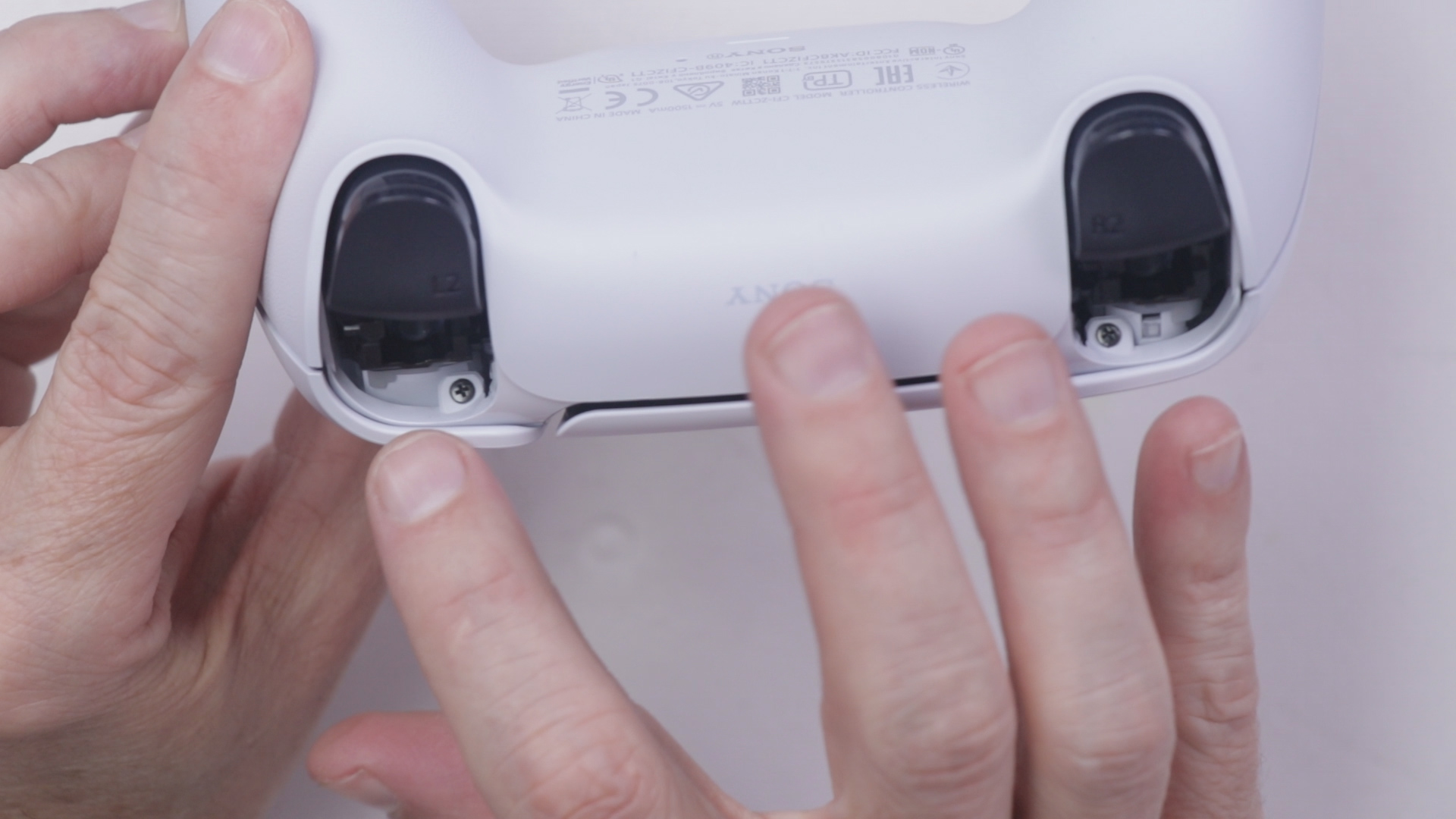

Step 14 - Remove Two Black Screws for Trigger
1920×1080 395 KB

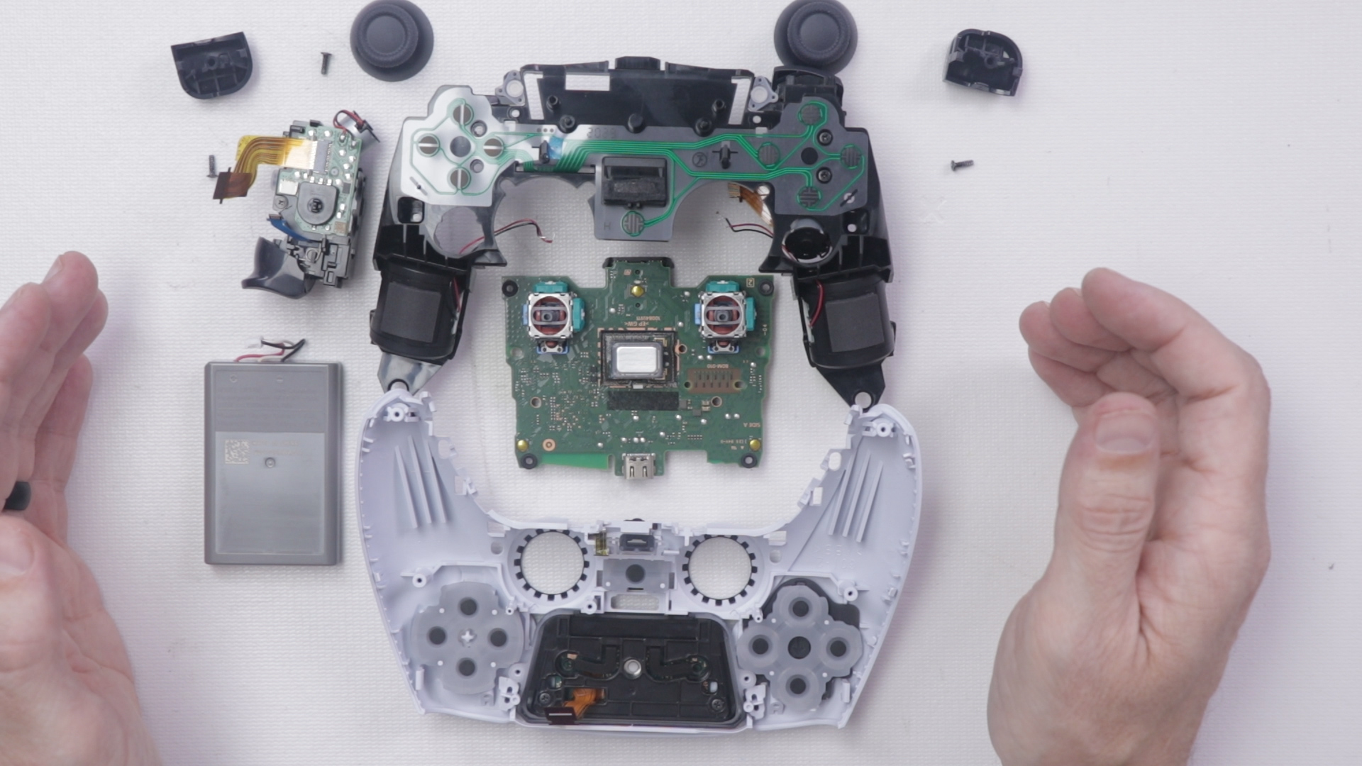

Step 14 Parts Layout
1920×1080 628 KB
