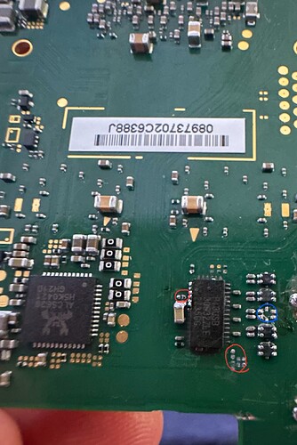

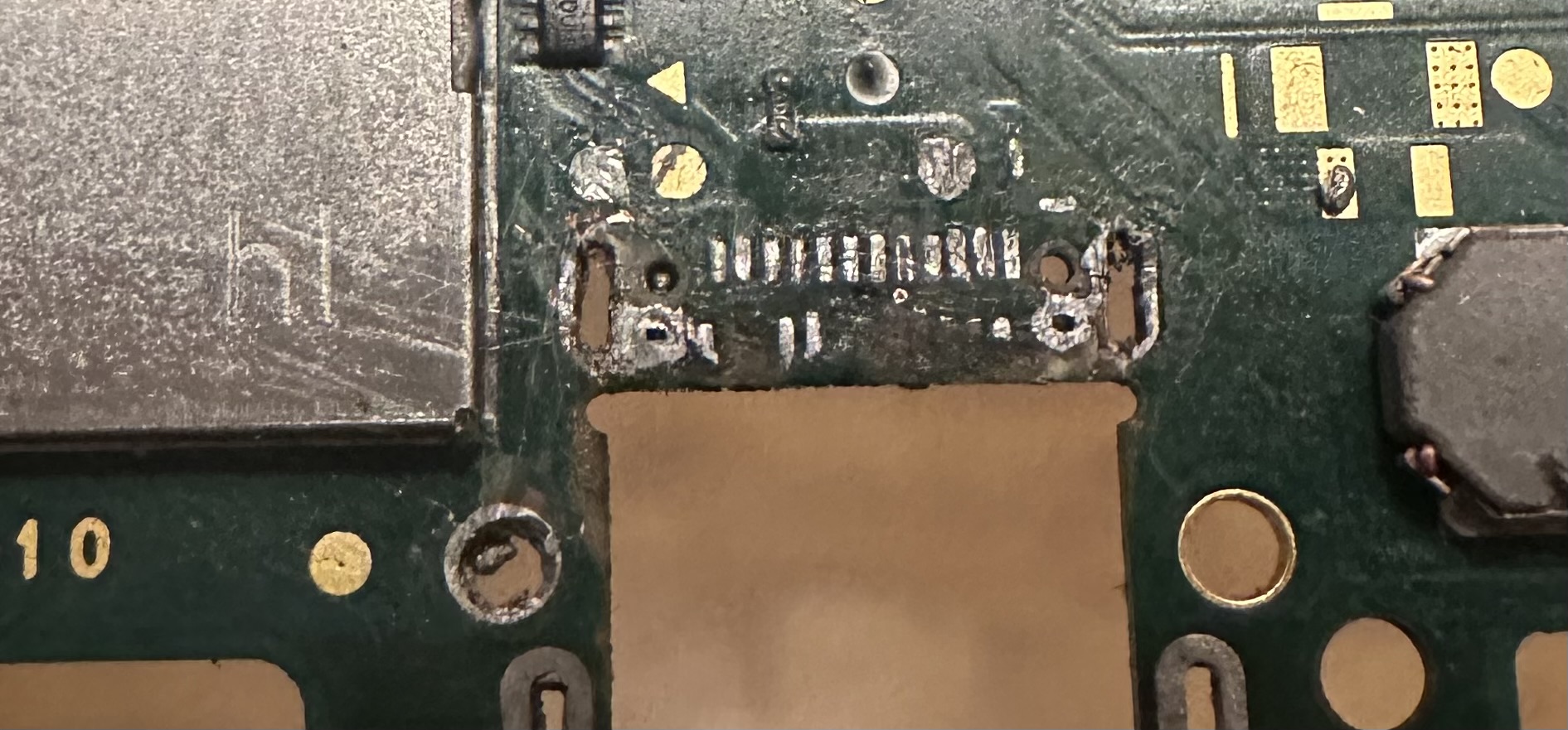

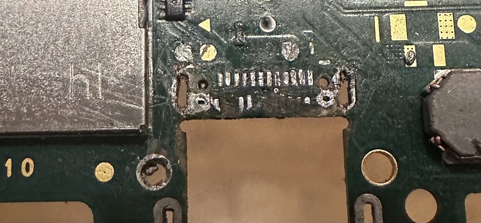

Ok so I’ve brought another none working Nintendo switch sold as (none working) thought I would give it a go but pads are also missing looks like it’s defo been attempted before! I did a trace repair on the last one I did but found it very hard to do! But looking at this one is this even worth doing ??

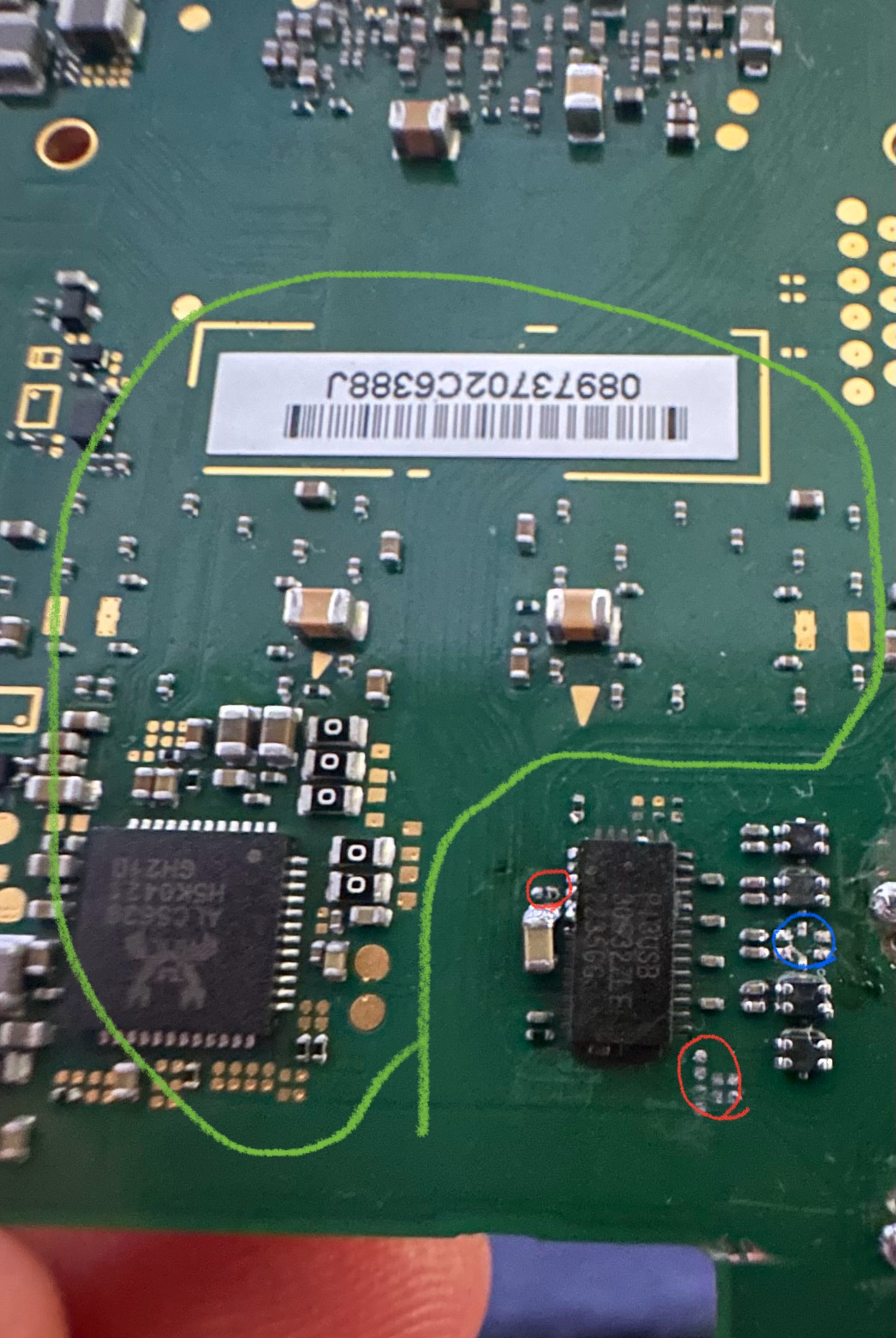

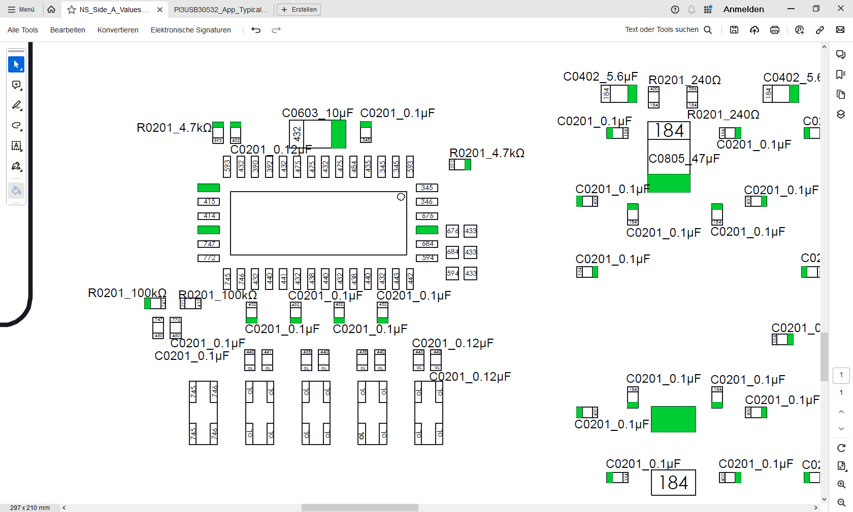

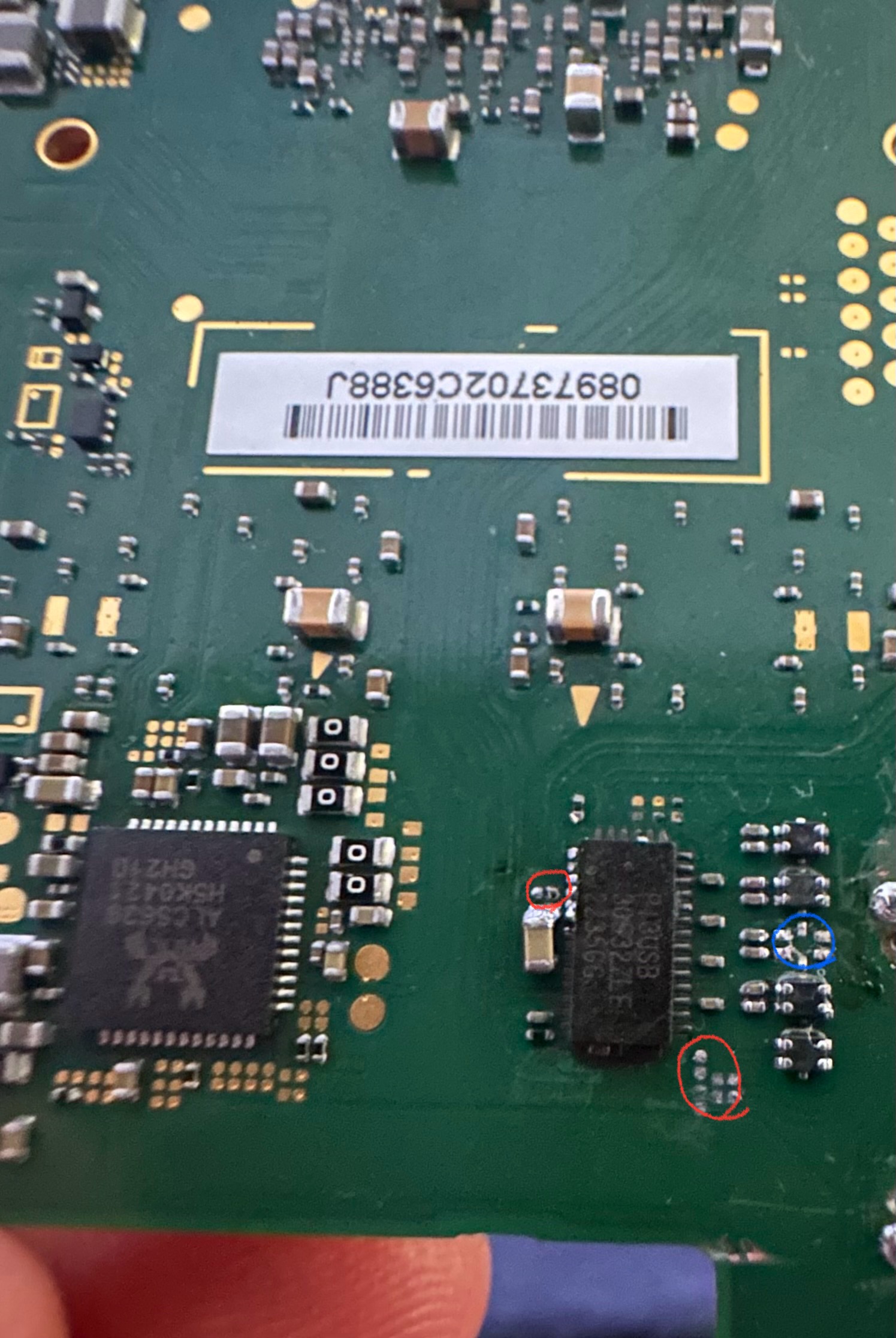

Hi Calvin could you tell me if I can replace these with other parts from a donor board I have a filter missing in the blue circle and caps missing in the red circles are any of these in the green the same ?

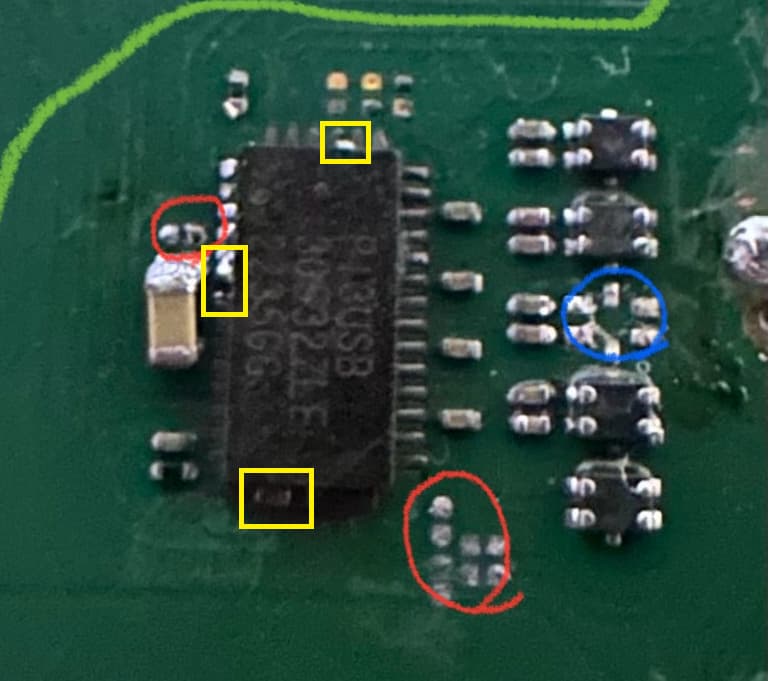

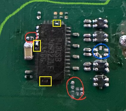

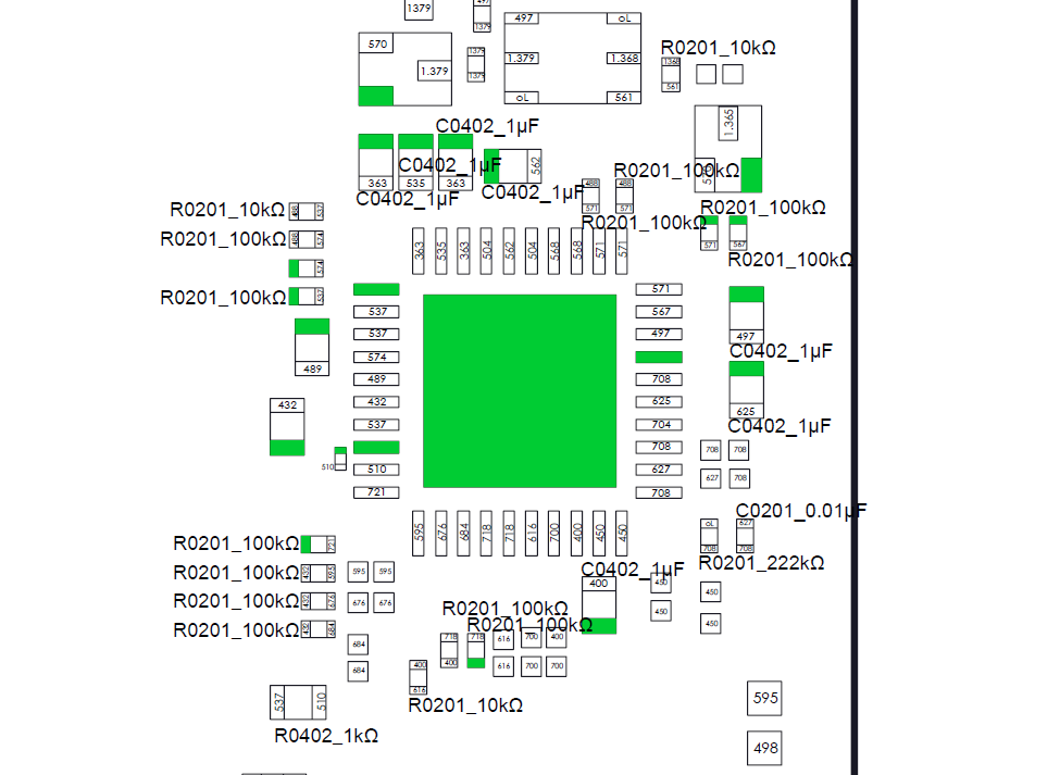

Yes there were a few caps in the yellow markers but I still require 201_100k caps do you have a picture of another section of the board where I can check for those?

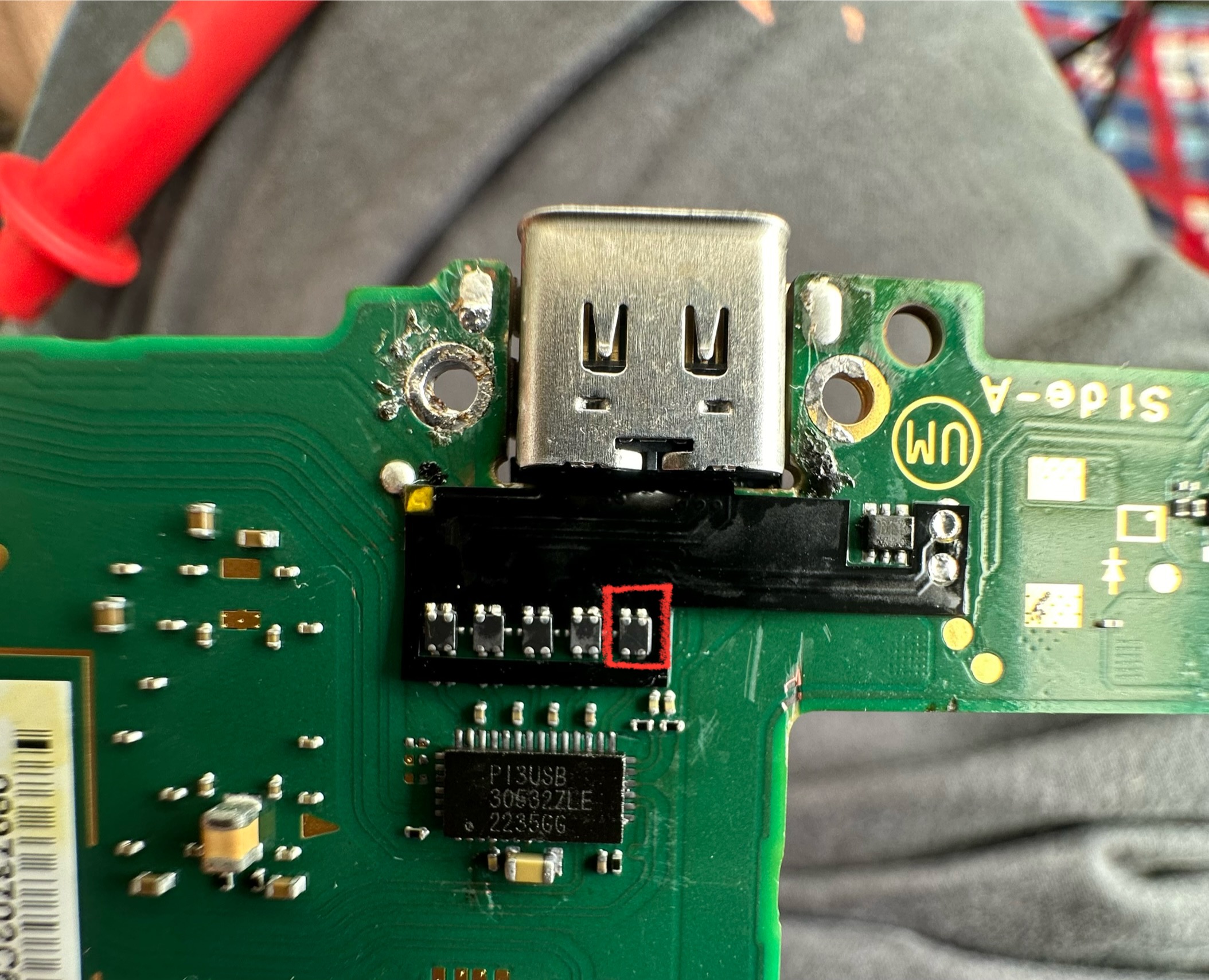

An open choke at the usb c will not prevent a Switch from turning on. But a problem with the pi3usb will. I think the pi3usb is at least one pad off and not in place.
