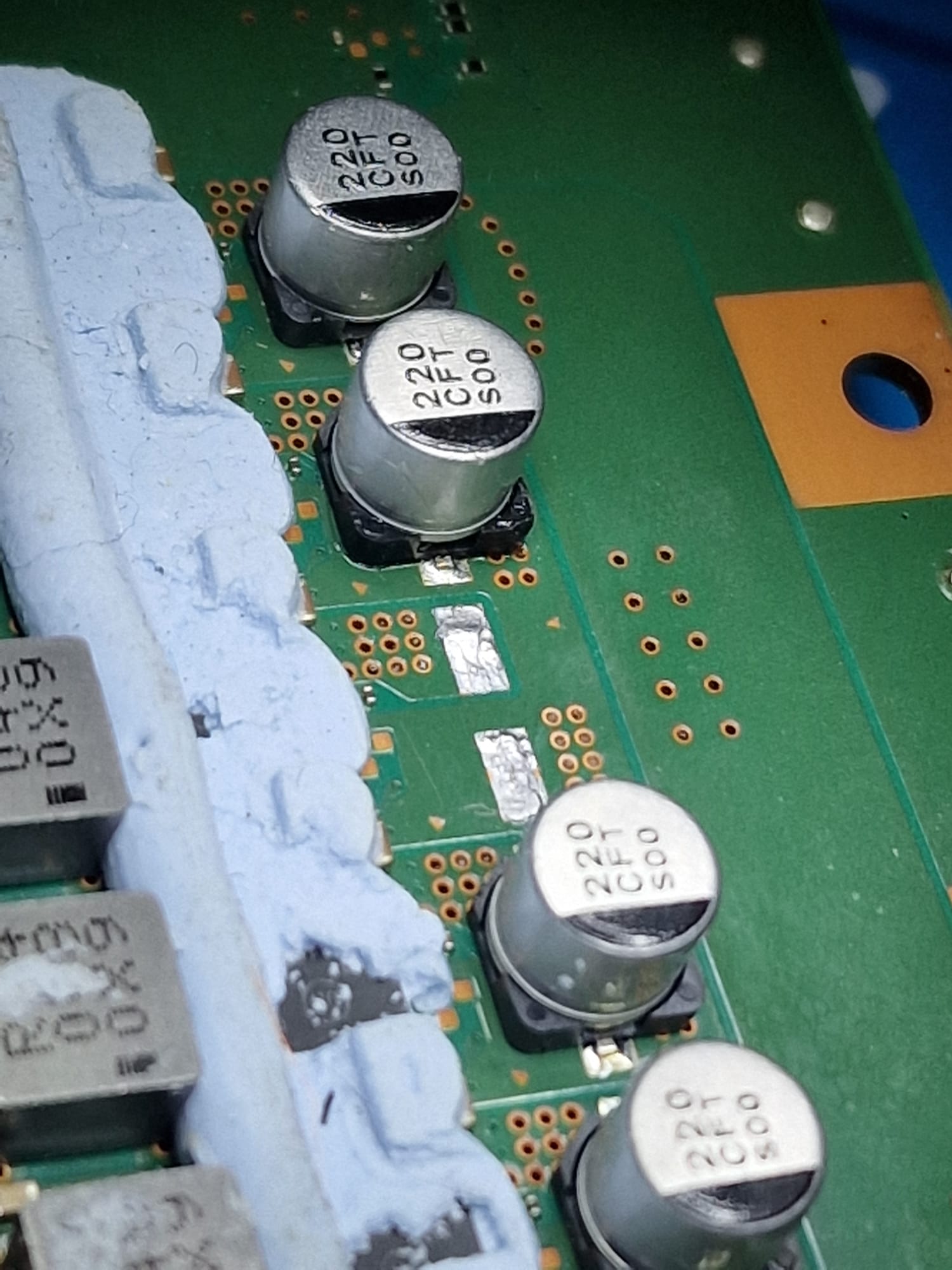

I’ll just put the cap back on the VRM, but then if it doesn’t start, it will become a donor.
But in your experience… why is that capacitor removed? There are no traces of other work.
I don’t know. The cap is one of eight caps (1x 220µF, 5x 10µF, 2x 0.1µF) for each VRM to smooth the 12V input.
If a VRM would short the line, I would check the components around the VRM chip, than ground the output of the VRMs and see which VRM is getting hot
Maybe the whole board was a donor before.
Boardview gives me a C7315 16V 220uf. Can I replace it with this one? There’s no short on the RAM/APU line. I don’t understand the point of removing it.
Yes, the 220µF 16V 20%.
If you buy new ones, check the right cap height. CLA is the series marking.
Fixed.
Panasonic replaced, resistors were restored and the electrolytic capacitors were replaced.
