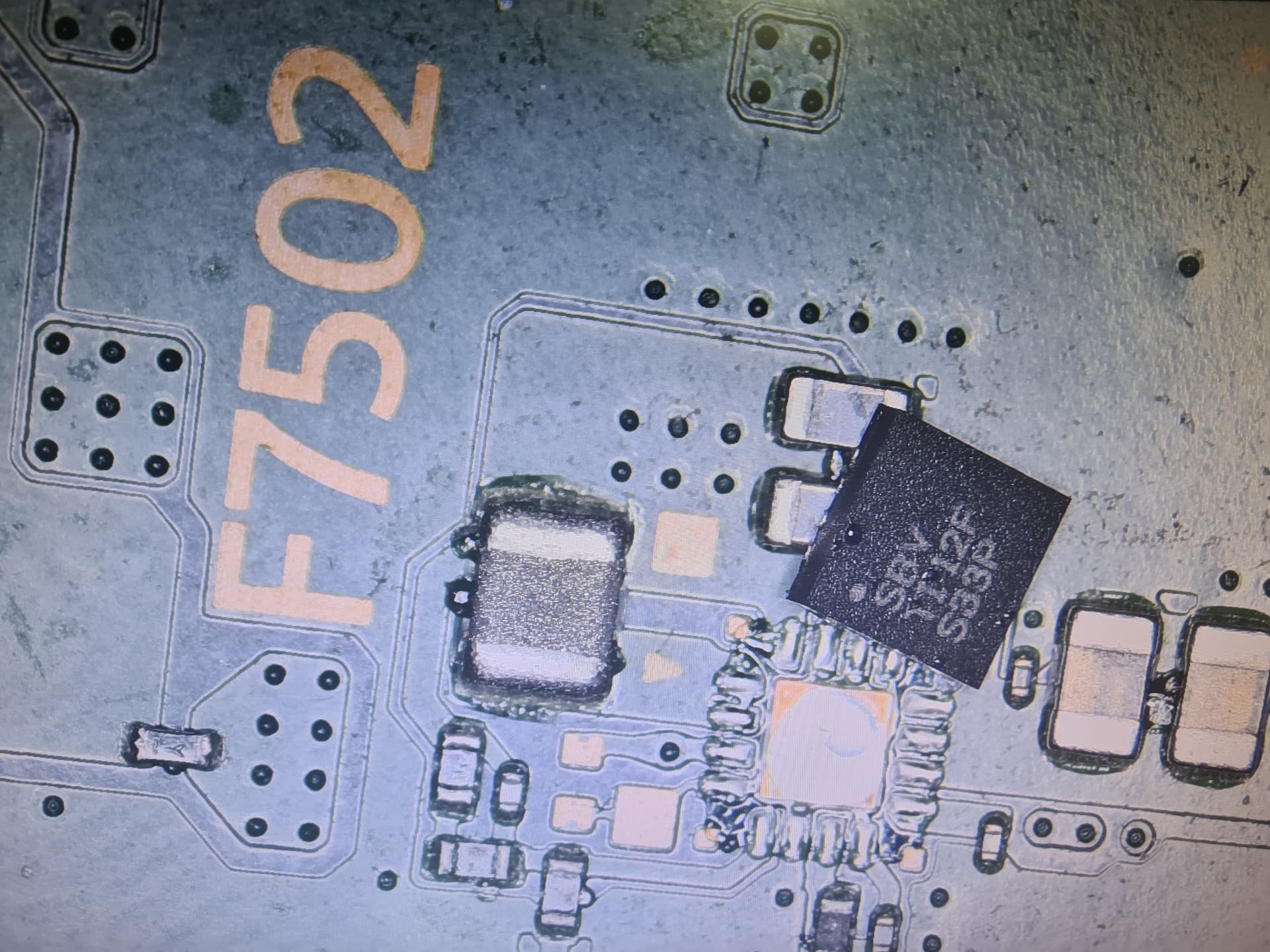

EDM 010 digital edition - fuse 7502 - where to find SBC ti12f s33p - alternative naming?
I previously used this ic as a donor for a another PS5 board. Now I wanted to work on this board again but I can’t seem to find a proper replacement. Does this IC maybe has another naming?
Thx you. Sry if I bothered you but the other stepdown converter at f7002 had a slightly different marking and I thought that it wouldn’t be the same ic.
I guess you need to realize what those label means on the chip SBV is chip model marking , TI is for manufacturer, 12F date code; S33P batch number.
You could find such details from datasheet.
You only need to find genuine chip with same MODEL marking “SBV” the rest variesiable label does not matter.
