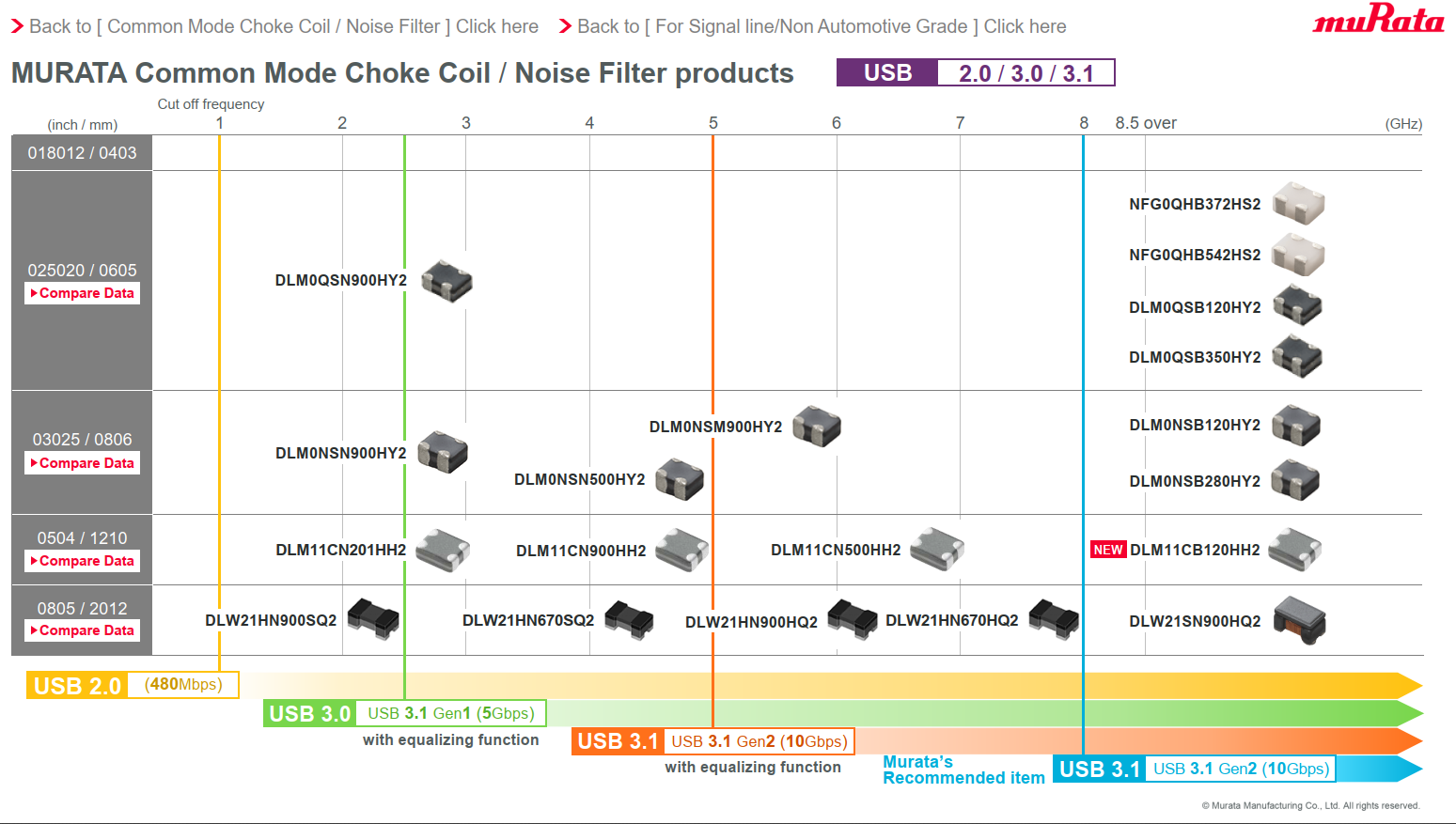

You could use this Murata filter recommend sheet as reference
https://www.murata.com/-/media/webrenewal/products/emc/emifil/cmcc/pdf/usb.ashx
