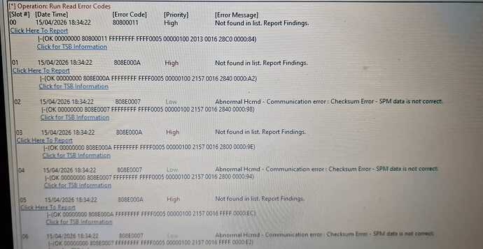

I’ve never seen these error codes before, and I’m not sure where to start. Does it sound like a peripheral isn’t responding?

first suddenly it started with infinite blod but with the same error codes
