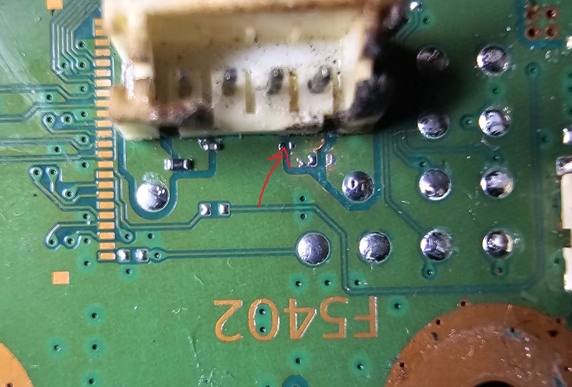

EDM-033 out of a PS5 1200 series disc edition. Looking for the value of the capacitor that goes where indicated in the image, between F5402 and the drive connector. (Cap has already been pulled off to verify failed open.) Can anyone lend a hand?
same as the one on the left next to the fuse
Are you positive? I thought that at first, but then I thought it’d be kind of unusual that the 5V line and the 12V line would get the same size capacitor, no?
