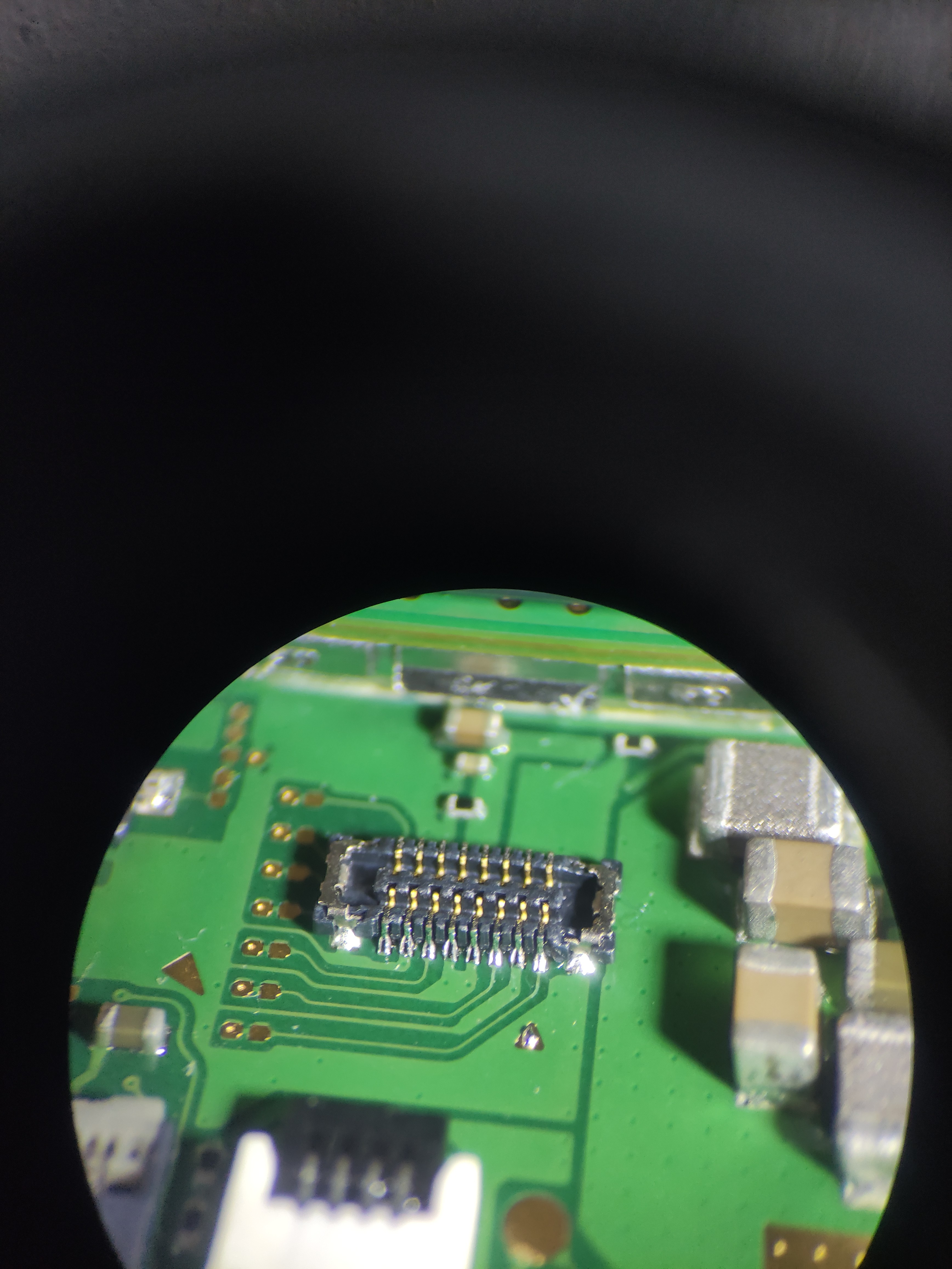

I have an NS that doesn’t recognize the SD card, I’ve already changed the motherboard connector, changed the adapter and also the memory card, but it still doesn’t recognize it, it reports error 2016-0641

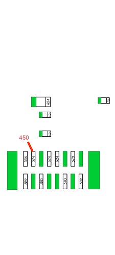

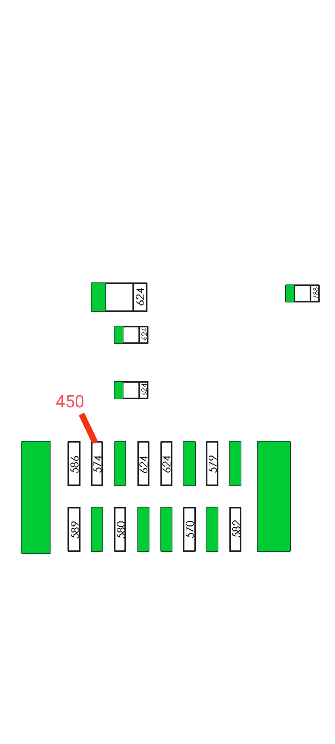

Looking at diode values I found a line with the value changed (below) from normal
