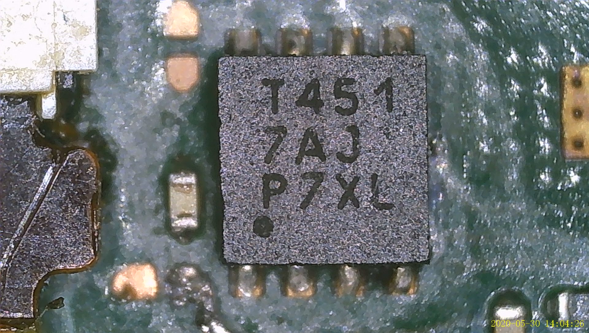

Thanks. I’ll have to take it apart again later to take a pic. It’s all back together now and everything seems fine except the fan being on, but I played a game for 30-40 minutes and the battery was half gone. I’m not sure how much of that is from the fan and how much is from a beat up battery.
Here’s the IC. I don’t recall it being that bad from the liquid damage, but the pads to the lower left of it weren’t that great and I had trouble with it for the trinket install.
